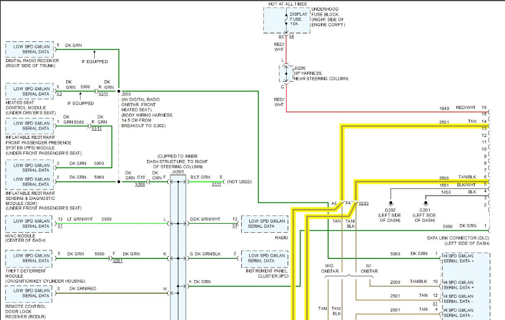

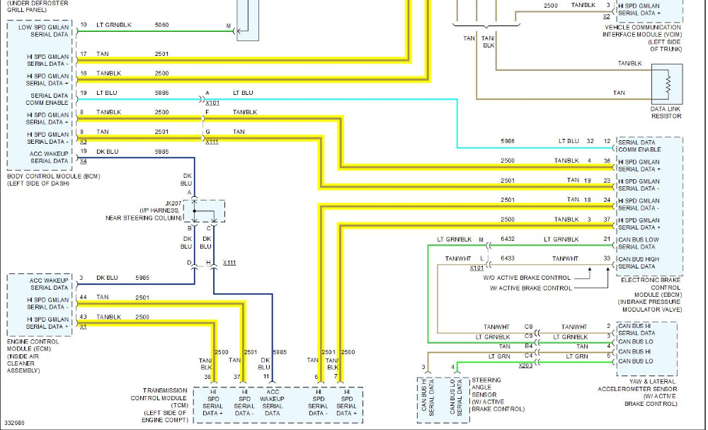

That'd be because of where the EBCM lives in relation to the ECM, TCM and ICM. The GM HSLAN (High Speed LAN) isn't a star configuration, but 'linear'. A break in the HSLAN (like an unplugged connector) will impact all modules after the break. I can't get my hands on a wiring diagram for this network, but I'm willing to bet the EBCM is upstream of the ECM on this network.
I didn't get to the point of checking across pins 6 & 14 as you suggested.
The value of that test was to confirm an open in the HSLAN. Even if the ECM shows the correct resistance, the total network resistance (with the other terminating resistor present) should still be 60 ohms. A reading of 120 ohms at the DLC would have spelled out an open in the network.

7 years 3 months ago #32022 by Chad
Tyler wrote: I can't get my hands on a wiring diagram for this network, but I'm willing to bet the EBCM is upstream of the ECM on this network.
7 years 3 months ago #32032 by Tyler
You da man, Chad. B) I don't know how you get those diagrams to match up so well. I tried once, failed miserably. :lol:
