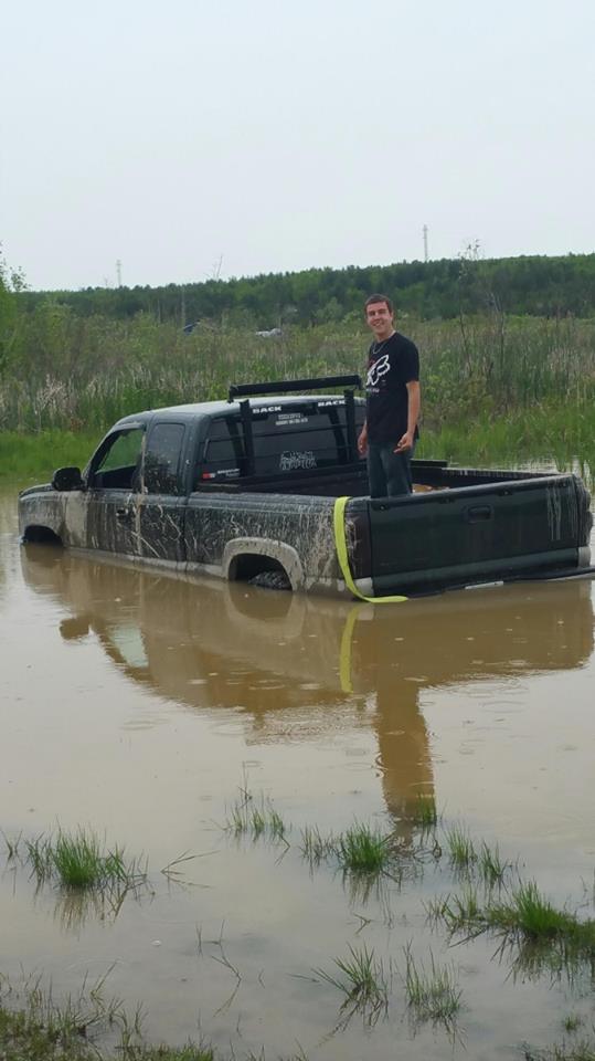

Hey guys I got 03 Chevrolet Silverado that hasa 5.3l in it Vin t.. not flex.. doesnt have egr on it.
last summer i was offroading when i nose dived it into a water hole and got stuck cause it bogged out. had about a foot of water in the cab while it idled (not the greatest) under water for over an hour.
while sunk i was low on gas so i added a jerry can while it was idling under water.. got pulled out backwards and water splashed up under the dash.. while limping it home it slowly lost power and died was also stuck in 4low as i have the auto 4x4 option..
