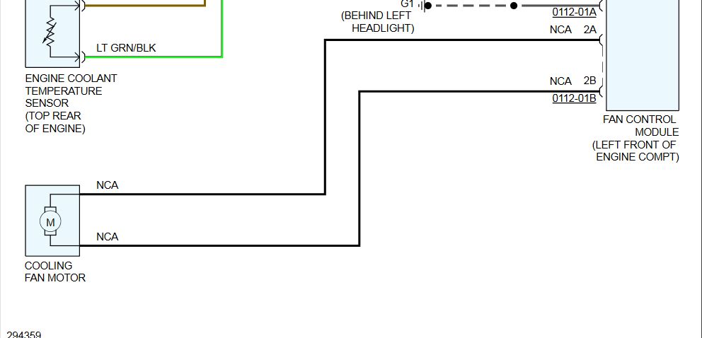

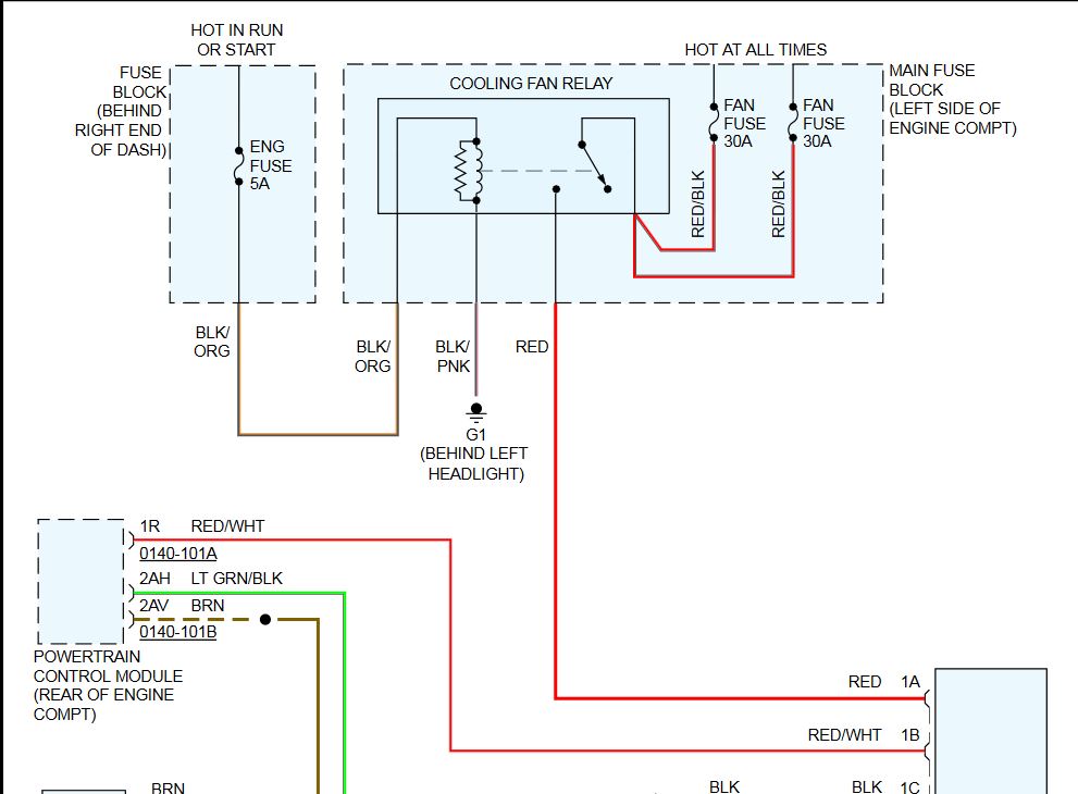

Hello all,
I been working on a Mazda 5 someone bought from an auction and asked to replaced plugs, thermostat, belts, hoses, cv axle, brakes and today went I started it the fan wasn't coming on. When it reached normal temperature and supposed to be on it will move very very little back and forth but hardly see it moving, if i give it a hand push it will stay rotating as if it was running by hand real slow, hard to describe.
I used my power probe directly to the fan and it worked fine, normal so I then knew it wasn't the fan. There is a module where the fan connects to with two connectors, one comes off the fan itself 2 pins and the other a 3 pin, wires from relay/pcm, and the ground. The plug has three wires blk, red/wht, red . Before I tested the fan directly, for some reason I thought the fan connector was unplug but it wasn't, so I send power on the red/wht wire then afterwards, realized I was on the wrong connector, so went to the fan plug and power it up directly and worked. Then checked powers and grounds at the relay and were there, so then I send power from the load side of the relay and with test light on the red wire at the 3 pin connector of fan module and power was there too along with ground.
I'm debating if the fan module or PCM is at fault, perhaps I may have fried the driver when sending power on the red/wht wire. Please any inputs will be great, I can't communicate with old modis scanner which the software goes up to 2011 and don.t have the option for bi directional control on this vehicle to operate the fan.
How would you guys go about checking this into what may be wrong? Let me know your thoughts.
Perhaps if someone has access to the fan operations, a good electrical diagram up to PCM.
Thanks

Just to make sure I'm thinking of the right fan... On the three pin connector, the red and black are heavy gauge wires, correct? And the red/white is smaller?
If that's the case, the diagnosis is fairly straightforward.
The red and black will have power and ground. Red/white will be a PCM controlled circuit. The fan control module provides 10-ish volts, and the PCM pulse width grounds it to command fan speed.
So, it's three checks. Power on red, ground on black, and some kind of square wave signal on the red/white with the fan commanded on. If in doubt, turn the A/C on. The longer the PCM grounds the signal, the faster the fan speed.
If you can watch the pulse width change (via scope or DMM, whichever), then the PCM and wiring are OK. Time for a fan assembly.

Not having a bidirectional test for this fan isn't critical right now. For your purposes, just turning the AC on the highest setting with the engine running will cause the PCM to command fan operation.
Test the red/white wire with the AC off, engine running, your DMM set to voltage, and the fan connector plugged in. If there's no fan command from the PCM, the voltage will be high (10V or more). Now turn the AC on. Voltage should drop, possibly down to 7V or less.
Thr drop in voltage represents the PCM grounding that circuit, which is the fan module input to turn the fan on. That means the PCM works, and it's fan time.
Did you cook the PCM by powering that circuit? Maybe. It depends on the internals of the PCM, and if that fan command was on while you powered it. Checking voltage at the fan module as described above will help answer that question.
