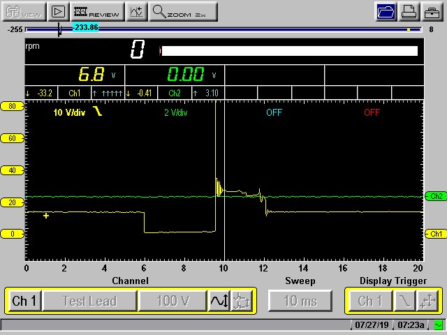

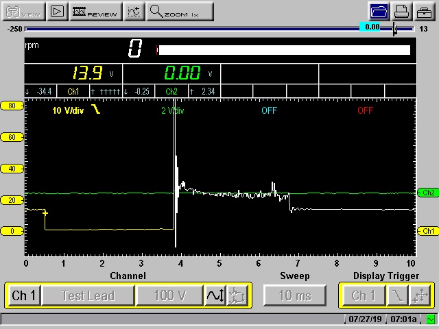

7 years 3 months ago #32229 by kwhooper
Replied by kwhooper on topic Left bank rich
Sorry so long to reply got pulled away on honey do list. Cant find capture of relative compression however upon looking at pics of primary on coils i think my problem is in voltage. Bank 1 is registering battery volts while bank 2 is only at 6 volts, thinking this is causing weak spark to bank 2.
7 years 3 months ago #32247 by Andy_
Replied by Andy_ on topic Left bank rich
If you don't mind, can I ask a question real quick? I use a Pico and have no experience with Snap On scopes, but what I don't get in the pictures you posted is where it is measuring the 6v from? Is there a cursor I don't see or something?
When I look at the scale on the left, it sure looks to me like that voltage before the coil is pulled down is higher than six volts. I'm probably wrong, just trying to understand what I'm looking at here.
7 years 3 months ago #32248 by Tyler
Replied by Tyler on topic Left bank rich
I dunno that I'd read too much into that 6.8V reading. :unsure: Because the waveform says there's strong spark taking place.
It even looks like the burn line is tilted down at the end, which agrees with a rich condition. It's tough to tell with the different time settings, but it looks like the burn times are pretty similar.

this tool as well the use of a scope is new to me and i really cant explain where that reading is being captured from. my hookup was to control side of coil on bank 2 and i found it odd that the reading was so low in comparison to bank 1 which has good fuel trim #. On the left top corner of the scan tool in the view icon you can select digital and that display appears on screen.
