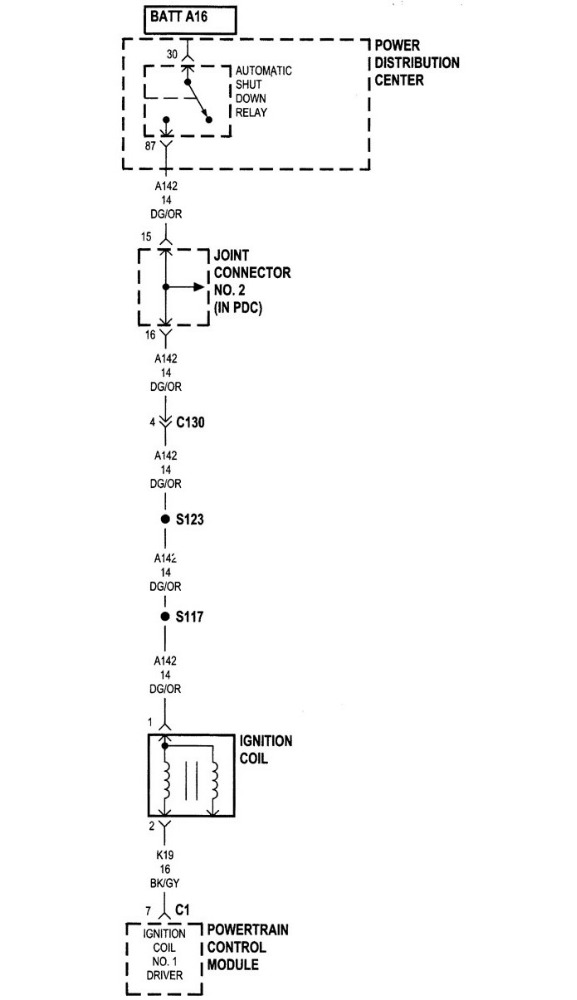

I have a 1999 Dodge 1500 Pickup 5.2L that cranks but doesn't start, and the coil has an intermittent spark.
I could use some help in fixing this problem.
Any ideas?
-DodgeGuy

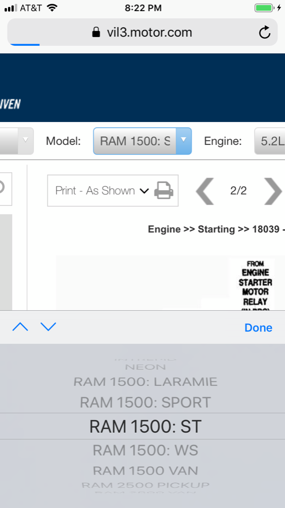

7 years 5 months ago - 7 years 5 months ago #30379 by John Curtis
Do you need a wiring diagram?
Do you have cam and crank signal?
check is if the fuel pump is turning on. Can you hear it?
Possible PDC failure? Try a bypass test?
Is this a 4 pin COP?
Have you checked for 5V ref?
I’ve included an attachment. Which one is yours?

7 years 5 months ago #30408 by Tyler
Does the coil have power and control during the no spark condition? Knowing which you're missing will help point you in the right direction.
My experience with these trucks is that the coil housing cracks and leaks secondary voltage to ground. An easy check for this is to get the truck running, then mist the coil with a spray bottle. If the truck dies, you're on the right track.

Hi - old guy here. I have an Dodge Laramie 1500. Could I get a copy of the wiring diagram. The truck hasn't been licensed since 2013 and not sure when it ran last as I just picked it up at a deal. I was going to use it for parts but now think it's better than the car I have. I can follow a wiring diagram but vague on how to test it. Any thoughts?
7 years 5 months ago #30415 by Tyler
DodgeDad wrote: Hi - old guy here. I have an Dodge Laramie 1500. Could I get a copy of the wiring diagram. The truck hasn't been licensed since 2013 and not sure when it ran last as I just picked it up at a deal. I was going to use it for parts but now think it's better than the car I have. I can follow a wiring diagram but vague on how to test it. Any thoughts?
Gotcha right here:
An incandescent test light would be preferable, but we can make a DMM work, too. ;) Test light connected to B-, the dark green/orange wire should light the bulb during cranking. If that's there, move to the black/grey wire and change the test light to B+. Crank it again and look for rapid pulsing of the bulb.

7 years 4 months ago #31006 by DodgeDad
Hi - DodgeDad here
I did the test, and this is what I found.
When testing the green/orange wire, the light stays on only when the fuel pump is on. There is no light on cranking.
I tested the black wire and there was no light at all.
Where do I go from here?

7 years 4 months ago #31321 by jreardon
The pcm provides a ground on connector C3, pin 3 (dark blu/yellow) when ignition is turn to RUN position FOR 1 SECOND.
So for 1 second, in the run or start position, you should have power at the coil. Do you?
If PCM does not receive a CMP and CKP sensor signal within one second of engine cranking (start-up), it will turn this ground off.
If you don't have this power for 1 second at the coil, check for a ground at the PCM, connector 3. Pcm should provide ground for 1 second when ignition switch is turned to run position. Now if this ground doesn't stay put, now go chase the cam and crank sensors.
What DTC codes do you have? I'm going to guess it's related to cam and crank. Did you test those sensors?

7 years 3 months ago #32520 by tim.smith1
When you checked the yellow wire is your test light on ground or positive?
7 years 3 months ago - 7 years 3 months ago #32522 by Noah
So, I just want to clarify a couple of points before going off into the weeds. Forgive me if it seems redundant, but I don't want to make any assumptions moving forward.
Have you corrected the no spark/intermittent spark condition, or is that still a symptom?
I made the assumption that you regained spark based on the statement you made about being able to start the engine by feeding it fuel, and you never confirmed or corrected my assumption.
I also assumed you had no engine codes only because you never mentioned any. Do you have a check engine light when it does fire up? Does it illuminate with the key on engine off? Can you scan the truck for codes?
I think if you cycle the key 5 or 8 times it will display trouble codes in the odometer screen. Any codes could be greatly helpful!
If I was there helping you I would do a long cranking spark test.
This will greatly effect the direction of the diagnosis.
If you have spark the entire time, this will verify the sensor inputs and the secondary ignition system.
Like Tyler mentioned, the ignition coils are a high failure component on these.
If you are losing spark and I was there helping you, my next step would be to plug a tail light bulb into the coil connector and give the engine an extended crank.
If the light flashes the entire time the engine is cranking but you still are losing spark, then the coil is need of replacement.
If the light does not flash the entire time the engine is cranking, then we need to revisit the control test.
Your reply to Tyler about testing coil control:
"When testing the green/orange wire, the light stays on only when the fuel pump is on. There is no light on cranking.
I tested the black wire and there was no light at all."
Is very similar to the results of the test you did on the injectors.
I would expect power at the coil only while the fuel pump is energized because of the Chrysler ASD relay setup.
This is one of many videos that explains how the ASD relay works and it's function:
You observed no light during cranking.
Even if you were on the coil control wire instead of the power wire by mistake, I would expect the test light to flicker or light dimly
While cranking, the coil and injectors should have steady power and pulsing ground.
I am interpreting your test results as though you might be losing the power at the ignition coil and the injectors during cranking.
But we can investigate that further if need be based on where we ever up from here.
