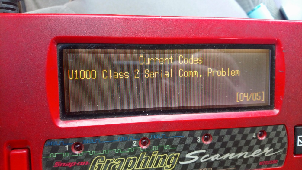

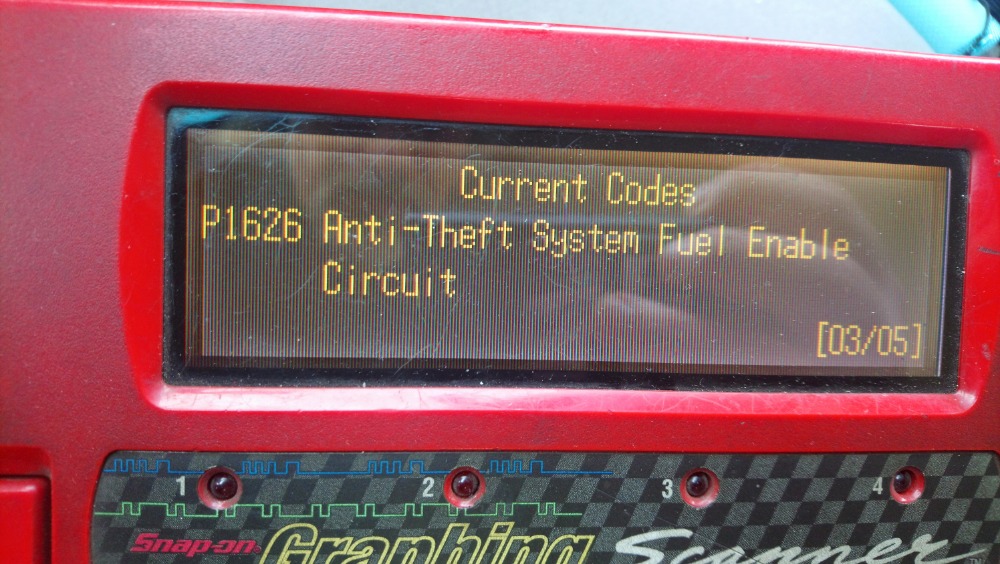

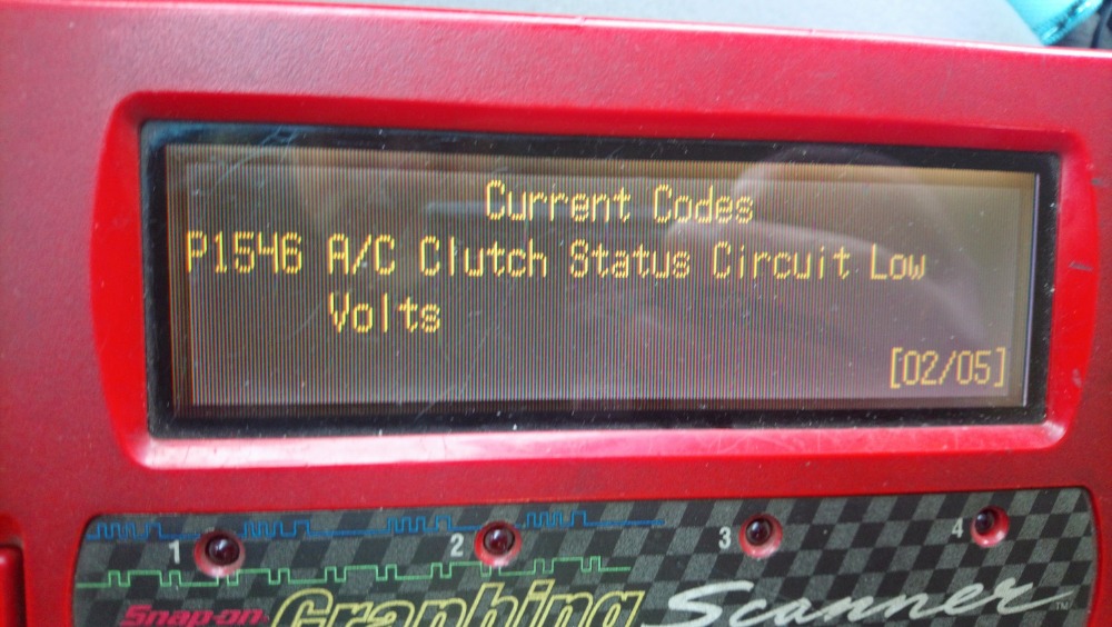

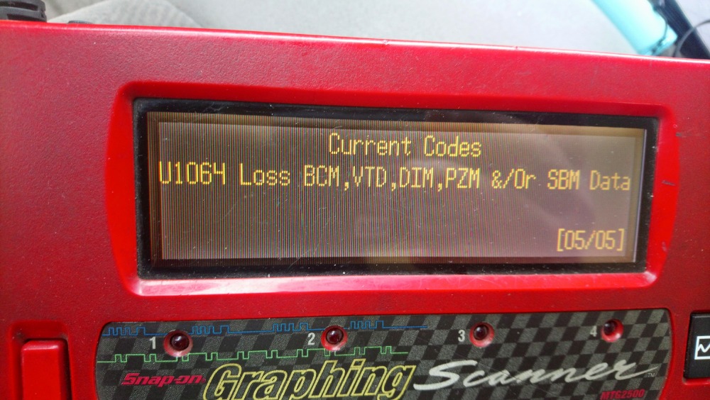

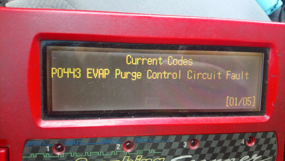

2003 Chevy impala no start.
3.4L
Security light on dash.

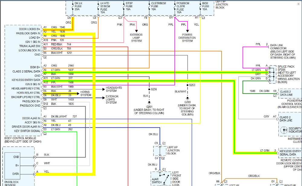

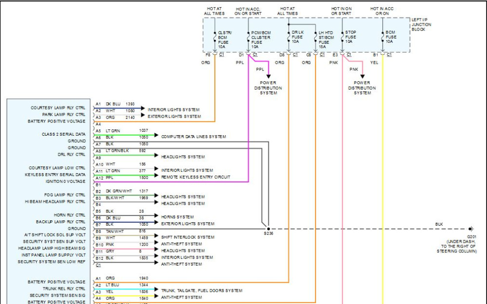

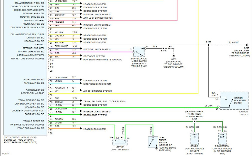

Power door locks don't work keeps blowing fuse.
Radio only display button shows time, no music and can't access settings by holding down display button.
Horn doesn't work.
Fobs don't work.
Power windows DO work.
Engine starter will crank if jumping the fuse but won't start no spark.
Did a scan please find attached.
3.4L
Horn doesn't work.
Fobs don't work.

is it just one fuse that is blowing? which fuse in particular? Have you did a visual inspection of wires around heat, movement, and points of contact?
