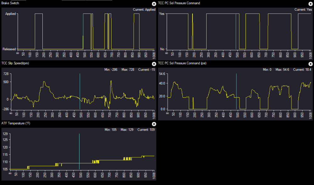

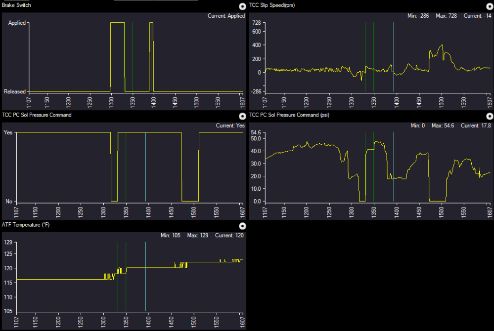

7 years 3 months ago #32472 by Tyler
Replied by Tyler on topic Re:2009 Cadillac SRX 3.6l shudder
Let me rephrase - I'm sure the TCM does look at the brake switch as part of it's strategy. But I've found that the brake switch and TCC application are not exactly correlated. Like this example from an '11 Yukon. The brake switch got tapped, but the TCC stayed engaged:
Other times, you can see a delayed reaction to brake application:
This is why I don't completely rely on the brake switch trick any more. :silly:
