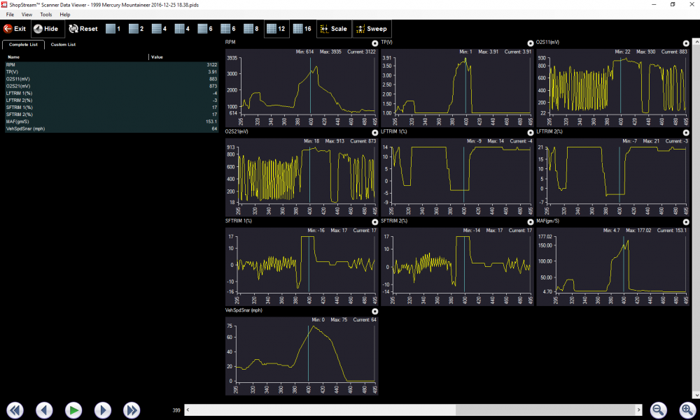

A quick and dirty test for fuel pressure would be the WOT throttle run, watching for the upstream O2 sensors to go rich during wide open throttle in first and second gears. If you see that, then I say we're really not worried about fuel pressure.

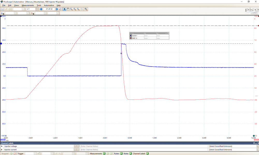

Sorry for late reply. Been busy. Here is the snapshot of test drive concerning WOT and O2. i took voltage and current injector waveforms done at the ECM since they were below the intake. All eight injectors averaged between 8 - 8.9 amps and the waveforms look exactly like this snapshot posted.

No intake leak, then :( And your WOT run confirms that the fuel system can provide enough at high load to keep the engine rich.
