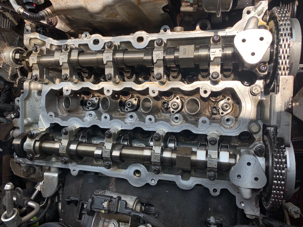

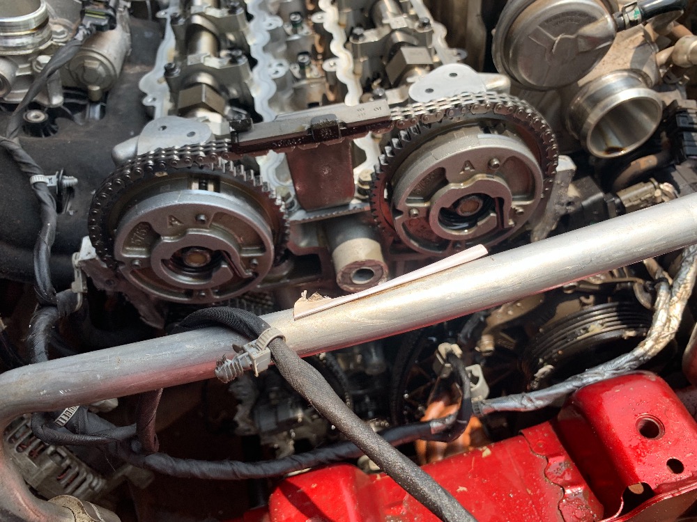

Good morning all Scanner Danner members-:
I have this 2016 Chevy Malibu 1.5 turbo, which the sprocket got losed and the timing jumped, but luckily no infection to the valves...
New sprocket and tension is in with chain, I need help on the position of the cam lobes or how to get it set, pictures will be okay,
There is pretension in each side of the sprocket but I just want to follow a good guide as the camshaft has some free play in the sprocket
I have added some pictures of how I set the chain, but when I turn the engine, the cams does jump
I seriously needed help, is it okay to get the free play in the camshaft sprocket, while you hold the cam, you can turn the sprocket actuator with you hand and you will feel the free play spring tension in it.. but I thought cam shaft should move with sprocket without such play?

Not sure how to answer this but I will try..........is the play coming from the mechanical part of the cam sprocket or from where the cam sprocket bolts to the cam shaft? I have done a lot of timing jobs over the years and most times when a sprocket comes off the cam has wear on it where the sprocket bolts on and needs to be replaced?

It is coming from the mechanical
Part of the cam sprocket , inside, there is some spring inside that tension when you hold the head by hand and turn it, I doubt that thing should turn after tightening it to torque

do both of the gears do the same thing?

those gear are also cam phasers or actuators depending on what you want to call them they do move to change the timing i am just not sure if you should be able to move them that is why i am asking if the other one moves also?

Yes, both moves,

Can someone look up a service procedure for this? I know Fords are locked when you install them. These may be free until they fill with oil the first time.

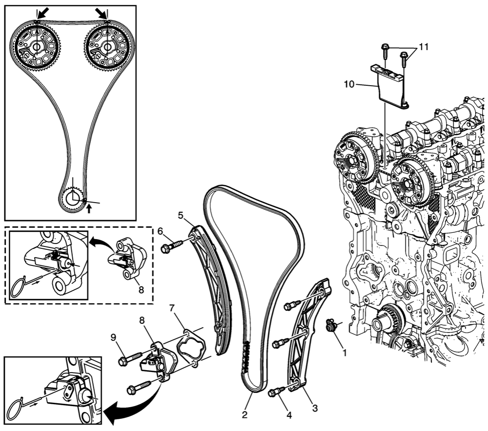

7 years 2 months ago #32586
by tim.smith1
Replied by tim.smith1 on topic 2016 Chevy Malibu 1.5, Timing settings request
here is what alldata says
The following user(s) said Thank You: forumoto, aboudi.naddaf

5 years 3 months ago - 5 years 3 months ago #50467
by e.p
Replied by e.p on topic 2016 Chevy Malibu 1.5, Timing settings request
I'm new at this forum and I'm trying to do some work on the timing chain of my 2017 chevy malibu ls 1.5 t, the name vacuum pump broke and when i replaced it notice that the pieces fell inside the engine so I had to open it to take the pieces out all things considered i think I did a good job but when i start the car again i got a check engine light p0014 code and the engine reduced power message so I tried replacing the VVT sensors and checked the wiring but no luck there, the next thingwas to check if the timing chain was correct so i took off the valve cover again and noticed that it might be off time and it looks like it's not, I'll try to upload photos, I've found the document on the procedure to replace the timing chain very helpful but by any chance do you have something explaining the procedure to remove and reinstall ha timing cover?, I'll alleviate if you have or any helpful input you can give me about it. Thanks.
