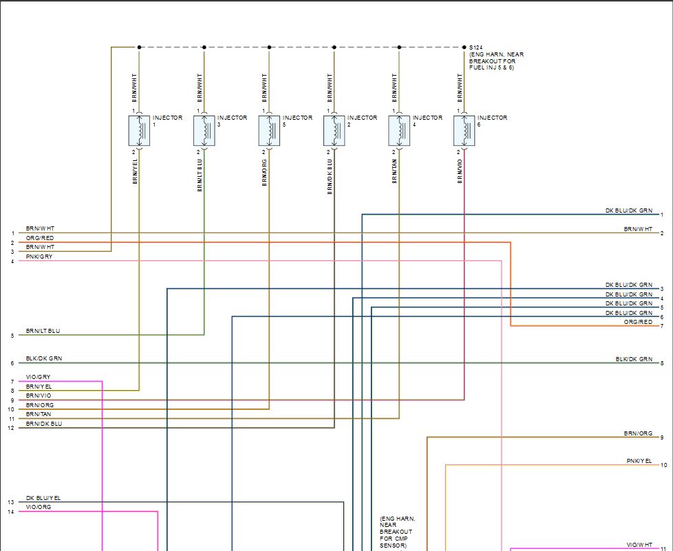

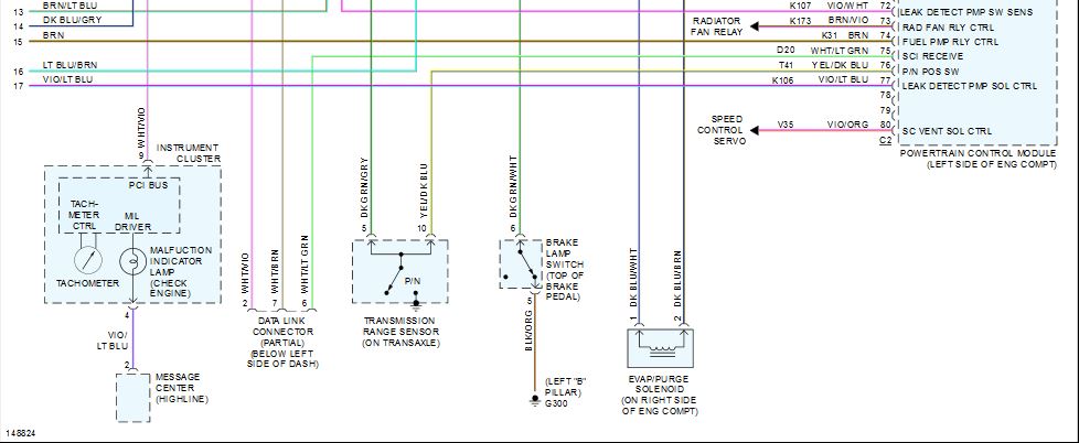

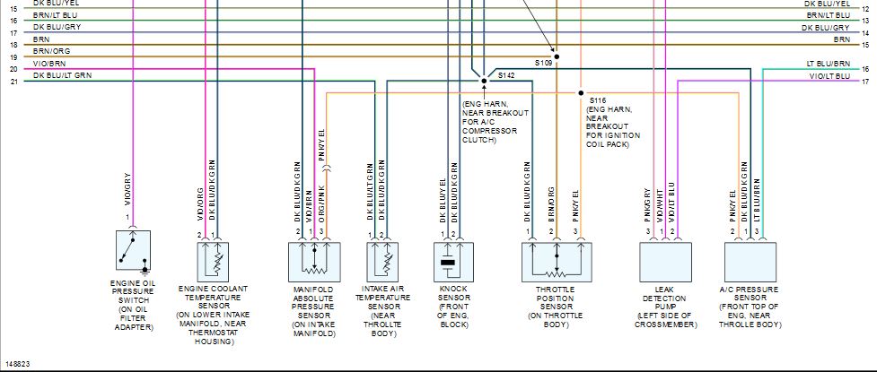

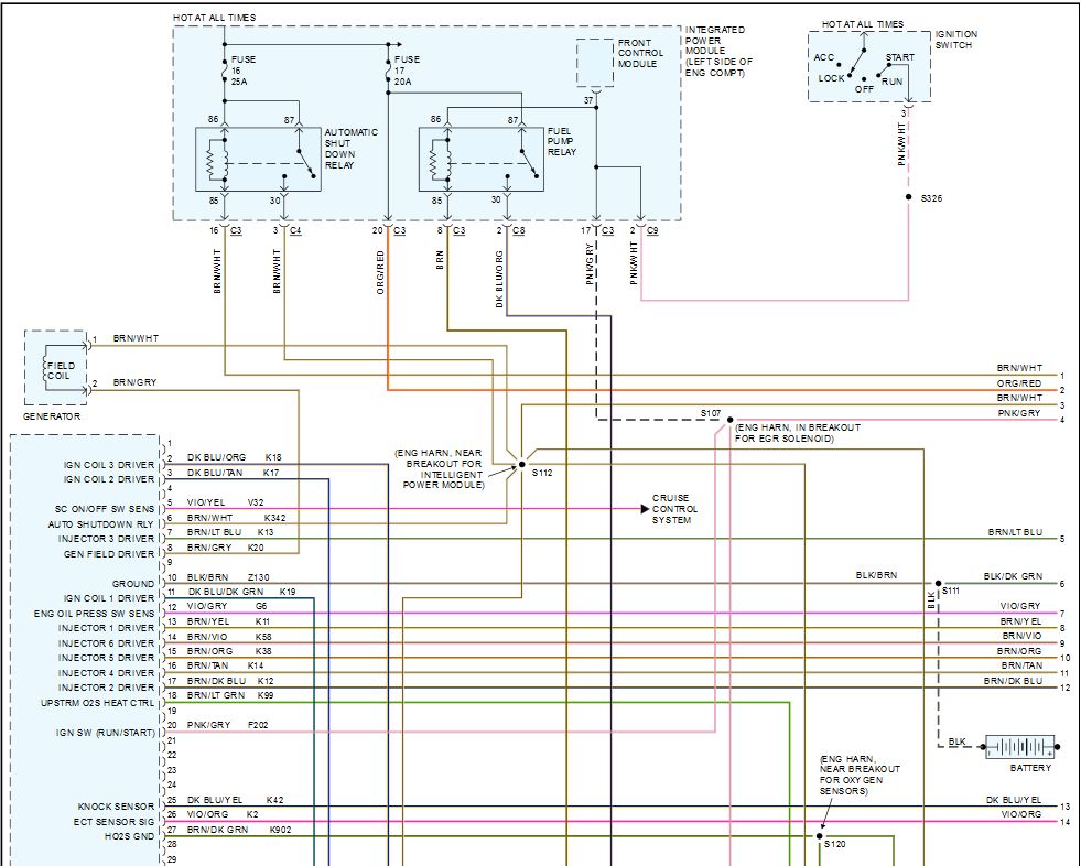

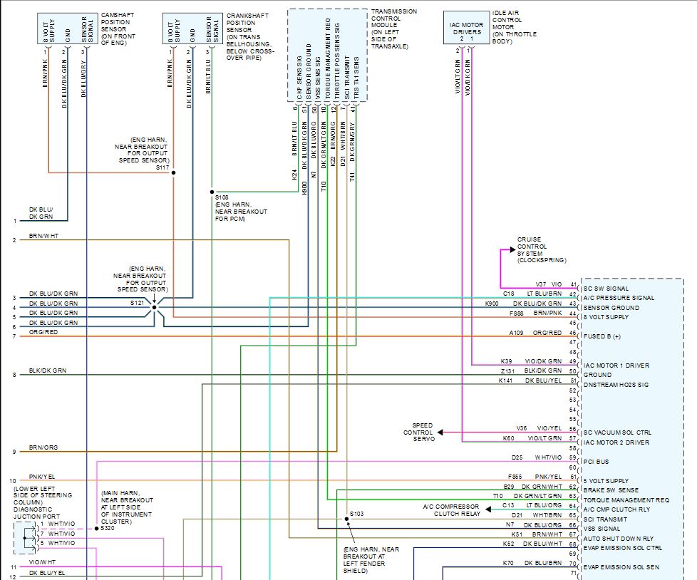

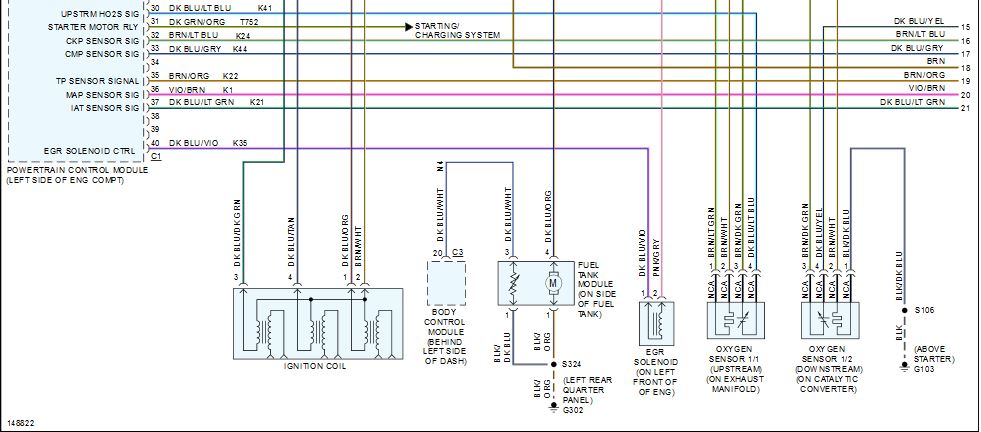

Need wiring diagram for the power train system dealing with a p1496 5 volt reference circuit low. I don’t have a printer or all data or Mitchell. BBB industries is missing the power and grounds diagrams. Thanks

Do you need the Engine computer diagram, or power and ground diagrams? Or, all of the above?
