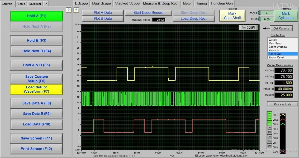

known good cam and crank wave forms for a 2014 chevy cruze 1.8 eco tec

hoping some one has some good cam crank wave forms for this car

i do not. but can you check your camshaft variance data?? if it reads anything but 0 your timing is off.

thanks to IATN i got one from them i will share it here incase anyone in the future needs it .................i sure hope this is okay if not please delete this post lol

wow that is an awesome find!!!!!!!!!!! just so everyone knows i needed it for a 2014 the one i found from iatn was for a 2012 the one PDM has is a 2015 there is a big difference between the two i am going to say that the 2014 is like the 2012 because this car i am working on someone put i timing belt on it and it has cam correlation codes in it but runs really good if it was like the 2015 one it would not be running. I will make sure to get waveforms when i am done redoing the timing to add to the value of this post

There was an ‘08 1.8 on there too but I figured it was not the same. If you get some good captures, I think he will add them to that library
