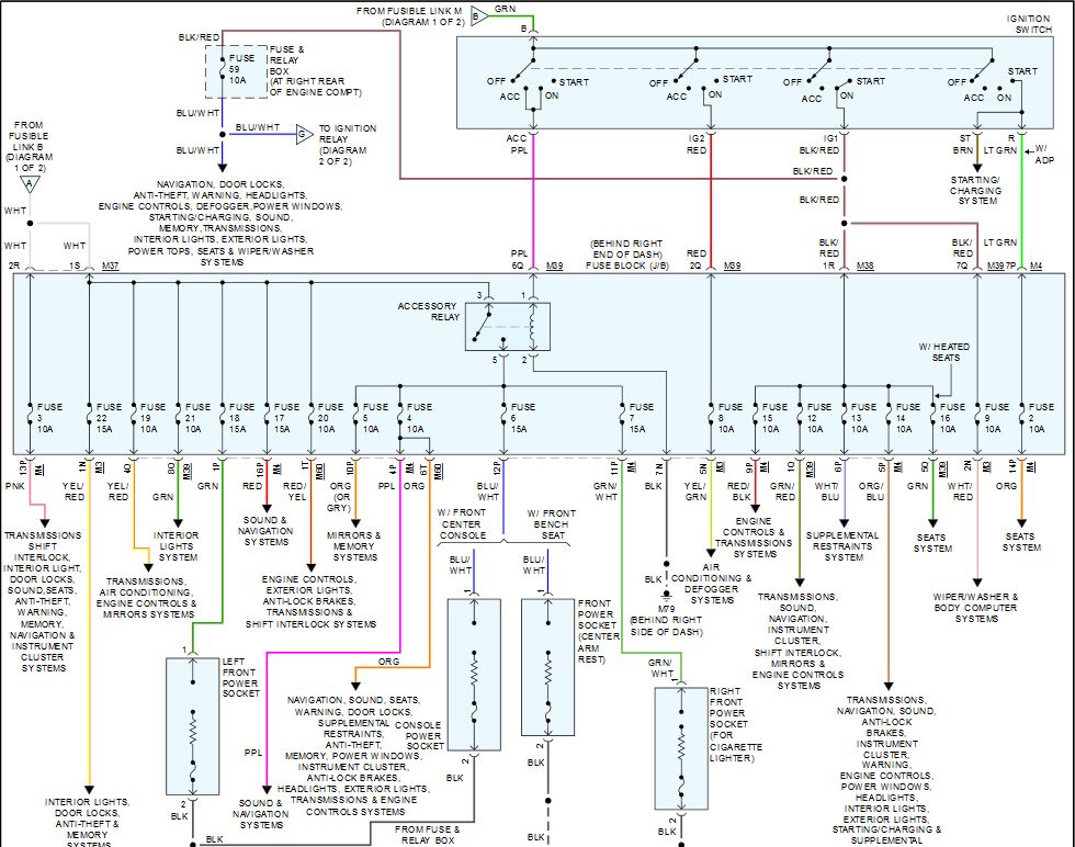

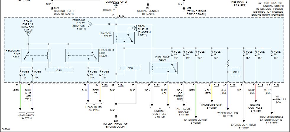

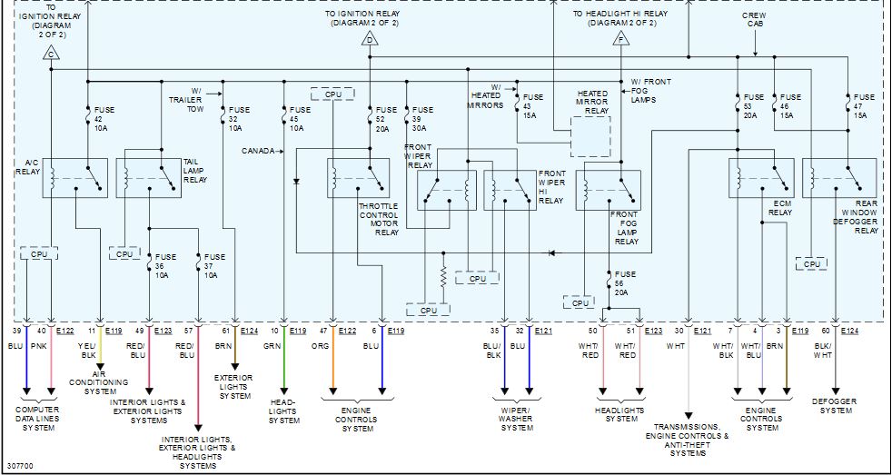

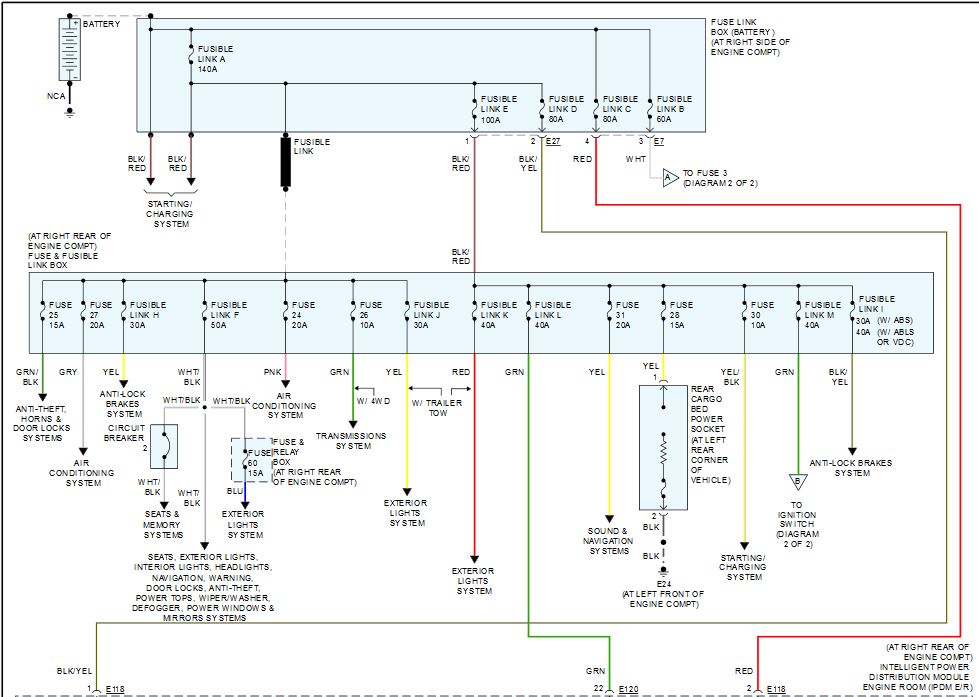

3 Chad thank you for that diagram I did not have it
7 years 2 months ago #32684 by Andy_
Replied by Andy_ on topic Codes are PO500, P1212, P1721 and V1001
Maybe now with the wiring diagrams that Chad posted you could take a picture of the fuse block and show us which fuses don't have power and we could see what is common to them.

7 years 2 months ago #32713 by Crombie
Replied by Crombie on topic Codes are PO500, P1212, P1721 and V1001
Check fusible link I, in the engine compartment, 30A or 40A. And fuse 50 somewhere in the engine compartment, both are for ABS according to the wiring Diagram that Chad uploaded

7 years 2 months ago #32846 by 9w1911
Replied by 9w1911 on topic Codes are PO500, P1212, P1721 and V1001
I did and everything is good, 12v from the fusible link, good ABS fuse is fuse box and 12v from the wire harness to the ABS modulator. When everything comes online all sensors work great, then things go back to where we are now. So I am assuming no the ABS mod is bad.
