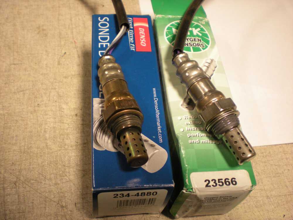

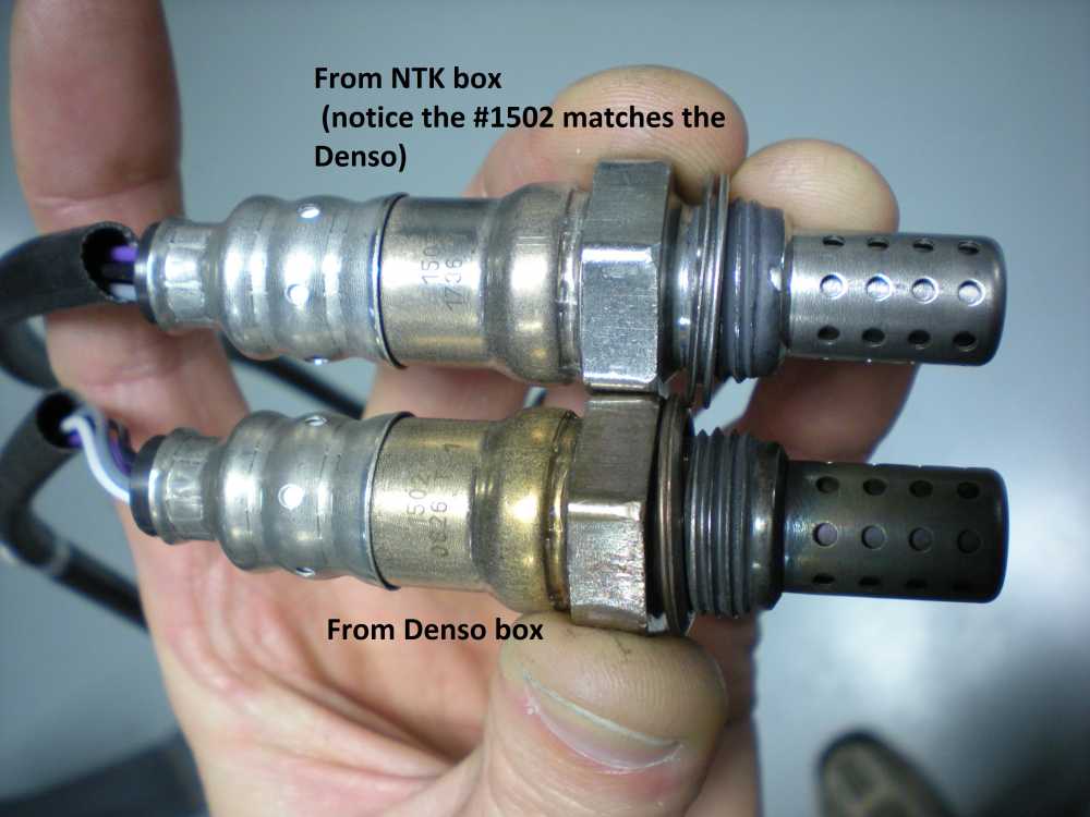

I have tried a new Bosch, and a new Denso sensor with same results. I bought an NTK, but when I unboxed it, it was identical to the Denso even though all the packaging was correct (NTK# 23566). Didn't bother installing it. I've also disconnected the battery between trials to no avail.

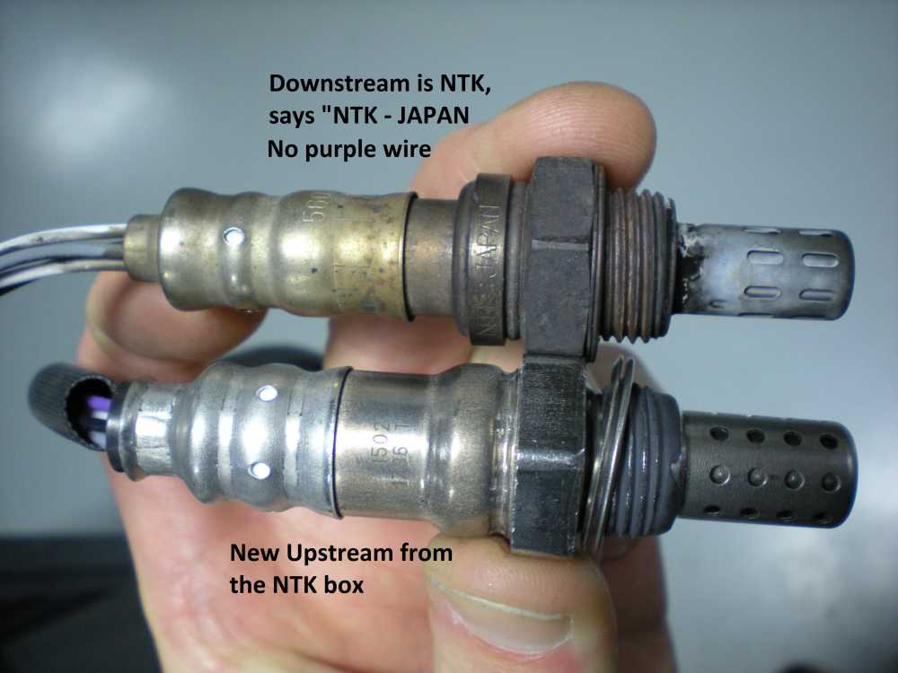

As for the sensor question, I mean I purchased an NTK sensor, the box had the NTK#, the clear bag inside had the NTK#, however the sensor itself looked identical to a Denso, and had the same # on it as a Denso. See images......

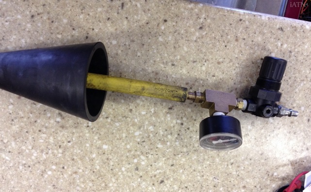

If you have one, a mechanics stethoscope can be used by removing the metal rod at the end, and just using the rubber tube to listen around gaskets/flex pipes/O2 sensors. A smoke machine would work, too.
I rigged up something very similar to this for quick leak testing without having to run the engine:
