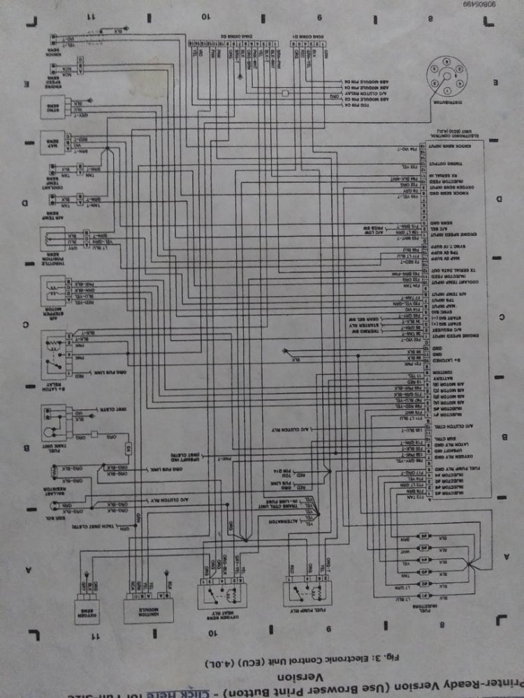

Since you asked Andy, and thank you, here is my vehicle and the issue I am having.
1990 Jeep Cherokee renix engine 4.0 stalls misfires. Idles fine when cold and after warmup but upon driving after warmup it will loose RPM after applying the brake it will try to quit if I don't give it gas and sometimes it will stall.
It will restart but runs like crap and missfires badly untill it cools down then idles fine again untill driving then everything starts all over again.
Note: When it is cold after startup if I snap the throttle it will momentarily want to die and run crappy just for an instant until it re-stablizes
Was running great until after I had made several freeway trips, dont normally drive freeway, it then began wanting to stall at stop lights and it continually got worse.
New Parts:
1 year prior to this issue I had replaced the fuel pump (it went out). I replaced the oxygen sensor from a junk yard vehicle and the IAT-idle air stepper motor (because prior to the issue having now it was running goofy. Those components seemed to fix that issue. (Note: I put a writeup as to what it was doing then on this forum, can't seem to find it now. I had gotten a few hundred views but no one offered any advice.
Since this current issue began I replaced these components. (Note: Sensors replaced due to not working properly according to my MT2500)
MAT sensor (was reading high), Oxygen sensor (it wasn't switching), Coolant temp sensor (only because I replaced the thermostat, it was in the block), Thermostat ( was getting inconsistent temp readings), intake exhaust gasket ( I had an intake/exhaust leak), cleaned throttle body although it was fairly clean, new vacuum lines (they were old and brittle), starter relay (because I got parts from a junk yard vehicle and it had a new one) and fuel regulator (just because I put in new injectors. Original ones are known to leaking and didn't want to take a chance of a future fire)
Spark plugs , wires rotor and cap have 7,000 miles on them. No water in oil and no oil in water. Compression 130-135. Cat temp 75 degrees cooler in rear than the front.
I have a DRB II that diagnose Chrysler vehicles before OBD 1 came out. The computer doesn't store codes but the DRB II gives fault codes. The Fault code I got was Fault 1052 which is MAP sensor out of limits.
In the fault code book it has a series of flow charts that gives DMM test and the chart ends up taking me to a D3 Sensor Short to Ground.
I tore the harness apart following all three MAP sensor wires and found nothing.
Thanks everyone.

7 years 2 months ago #32745 by Andy_
Replied by Andy_ on topic Diagnostics Tech
Hi Randy, that's quite a list of things you've done. Not that new parts means good parts, but if the symptoms are still the same, then it's probably something completely different.
One thing that comes to mind is the EGR. Have you checked if it is sticking open? I can't think off the top of my head how this EGR is, but EGR's sticking open and causing stalling at slower speeds used to be pretty common.
A really quick way to eliminate the EGR is to cut a piece of an aluminum pop can to block the EGR passages, then bolt the EGR back down. This is temporary.
EGR sticking open can be hard to see in fuel trims. EGR gas is inert, it's not going to really show lean or rich, but it will cause what amounts to a big vacuum leak when it's stuck open, which could explain the MAP code.

7 years 2 months ago #32805 by Andy_
I went back and read your original post. You said it will idle fine, but after you drive it and press on the brakes it will idle rough and want to die. Is this correct?
If so, when the problem is happening, try clamping off the hose to the brake booster. I sort of doubt this is the problem, but it's worth a shot. Just don't drive it with the brake booster hose clamped.
