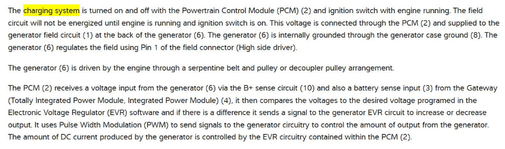

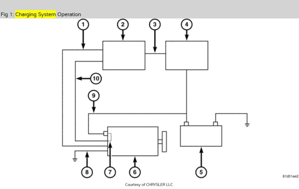

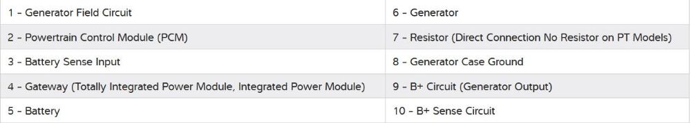

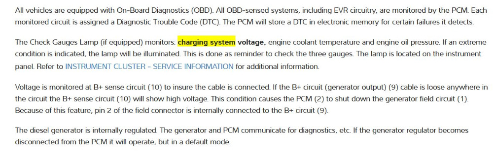

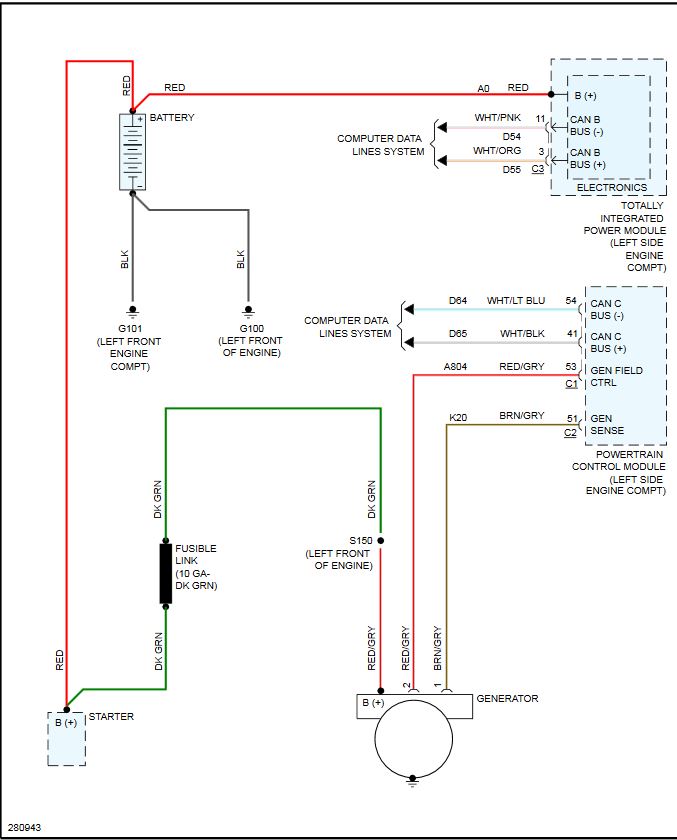

hi everyone i have a question on 2008 jeep compas 2.4 alternator wires isn t the red and gey wire the + one from pcm the field control or is it brown and grey sense from pcm that has + and it should be live with the key im doubting my self because i disconnect the plug i power one ground the other and the alternator has no output but none of the wires have voltage at plug either

thank you so much for quick reply. what i was doing wrong was checking with engine not running.i just wasnt thinking thanks again
