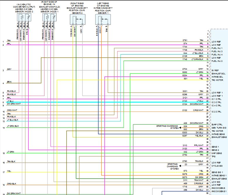

08 Saturn aura 4cyl started with no start no crank . Jump crank relay and cranks. Replaced ignition switch. No help . 5volt ref good. Replaced ecm and went threw 10min 3 times with key. Cranks now no start , no noid. , spray either in throttle body engine starts???

Power to injectors no noid

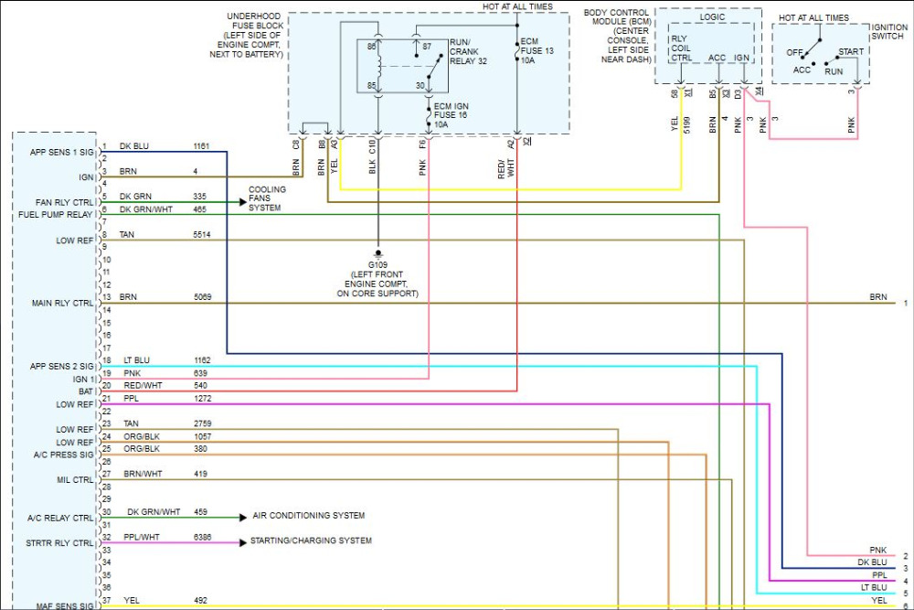

I’d be checking powers and grounds at the pcm if you can’t communicate with it.

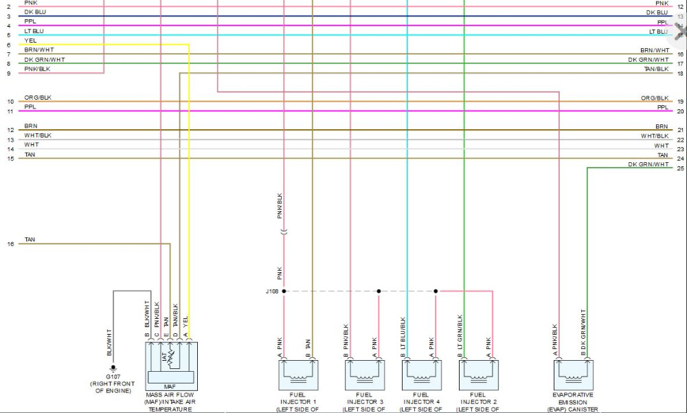

Thanks I need to find wiring diagram for that check at pcm. I checked injector harness no positive current and ground side hardly lights very dim. ??

engine cranks and runs on starting fluid , no injector pulse , no 12volts to injector harness , ground side is very dim . replaced ignition swich and pcm, engine code crank sensor needs relearn. ?????????

That’s what I asked earlier do you have 12 volts to one of the injector wires during key on or engine cranking. Have you checked the fuses yet?? Also the engine has a schrader valve have you checked fuel pressure???
