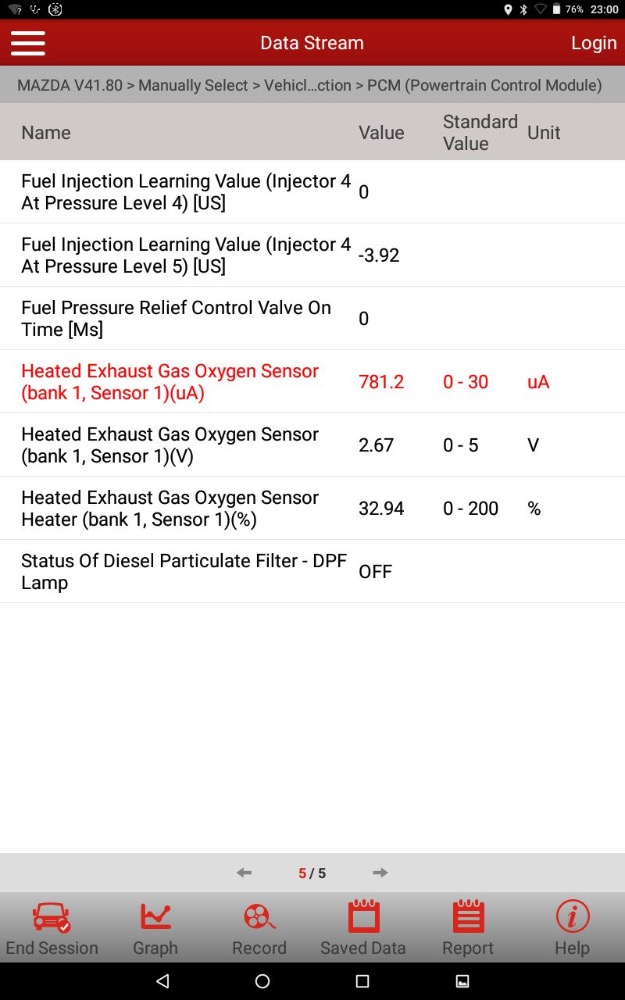

Hi
I have Mazda CX3 1.5L diesel
One defective injector is replace and calibrated injectors.
DPF is Cleaned using Diagnostic tool
It take nearly 1hrs to complete the process.
After cleaning that heavy smoke get normal and no faults are shown, but after few mins again heavy smoke is came. So I repeated cleaning process
When done after few mins driving same thing is happen.
Any idea to fix the problem
Thanks
Thanks

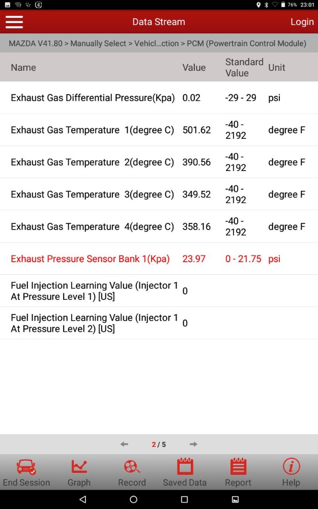

Hello, i do not know much about Mazda DPF Systems but i had many experiences with Mitsubishi DPF Systems and customers who buy the wrong Car.
tell me if i'm wrong but i think Mazda had no additiv like Eloys and no AdBlue. how much oil dillution has the car from oilchange to oilchange or earlier. if the System constantly in mood to regenerate the DPF on ist own i would check the difference pressure sensor, EGT 1, EGT 2 and so on. the EGT have hi priority for the regeneration cycle, check them to
plausibility to each other not to interruption or something.
- Loney911
- Posts: 52
7 years 1 month ago #33824
by Loney911
Replied by Loney911 on topic Mazda CX3 DPF problem

have you checkt oil dillution?
log the EGT while driving, mostly there is no DTC but the Sensor's may have faulty value's, caused from bad cable or connection's
another possibility ist the differential pressure Sensor could also give faulty value's caused by brocken or blocked hoses to the DPF
