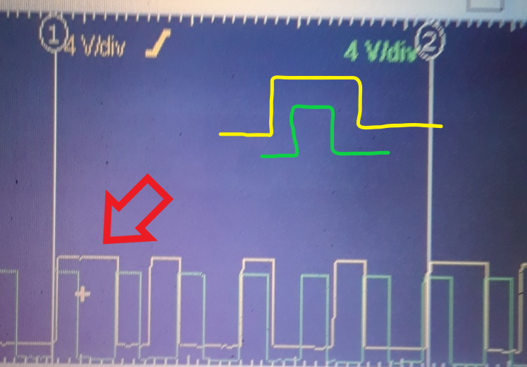

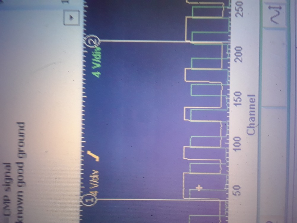

Hello having a problem with 03 eclipse 3.0 had a p0300 code changed distributor and now it has p0340 and p0335 with new distributor what can cause a new distributor to make this code? Also have p0172 and p0174 i have waveforms for cam and crank sensors yellow is cam and green is crank any help will be great thank you

Thanks for posting the cam/crank capture!
Your timing is definitely still off. The long CMP pulse in yellow should neatly bracket a CKP pulse. Instead, the long CMP pulse is intersecting two CKP pulses. :silly: Does this engine start and run?
I've (badly) marked up the relationship between the long CMP pulse and the CKP in Paint:
If you're confident that the distributor has been installed and adjusted correctly, then the next step is checking the timing belt.

I really don't believe you have a wiring problem, as the signals themselves look good.
As I said, the cam/crank relationship is off. One way or another. Either the distributor timing is adjustable, or the camshaft it runs off of isn't in time with the crankshaft.
