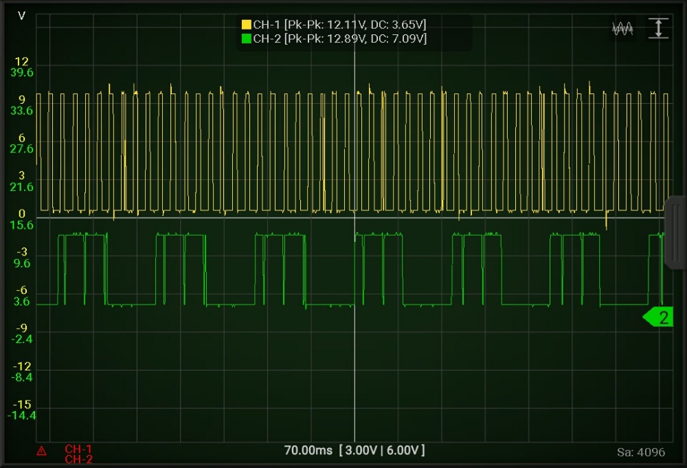

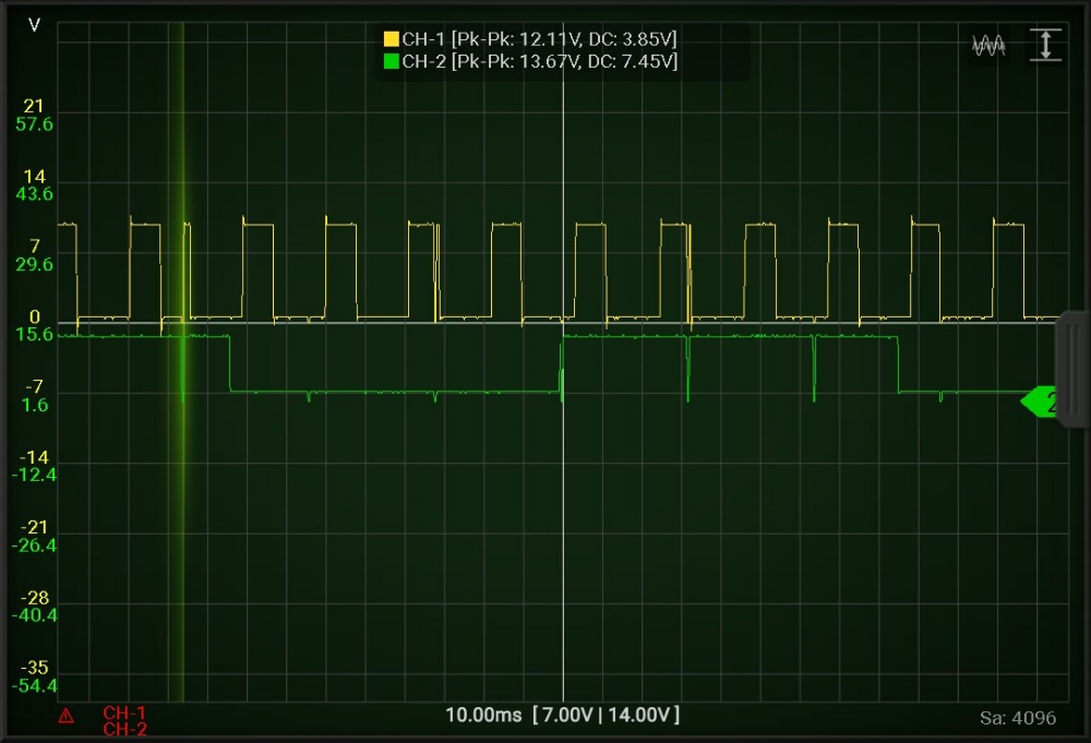

Thanks for looking! Please don't forget to look at the attached scope waveforms! I'm looking for ANY ideas but the scope is showing issues with the 2 sensors.
1996 GMC Suburban K1500
5.7 Vortec (260,000 miles)
Symptoms: I've been having issues for months now. Truck will just randomly DIE while driving down the road OR just idling.
I've thrown some parts at it already. I know that's the the "Scanner Danner way" and I"m trying to improve my diag skills(see below). In my defense, these parts needed replacing anyway.
Codes haven't been consistent but I have gotten crank sensor code (can't remember the actual code) before and after replacing it. recently it's been giving cylinder 3 misfire code (p0303). I believe I've gotten p0300 but usually it's cyl. 3
So I have replaced:
Fuel pump (it was 10 years old and LOUD)
CKP sensor (it had a fairly deep groove cut into it because it deteriorated and went in too far)
Distributer (probably a waste but it was the original and it did have gear wear)
Coil (this was just "stab", didn't even confirm it was bad... arg)
Ignition module (same as above)
LATELY(since fuel pump), the truck has been running steady and hasn't died on the road BUT it has bucked/missed on occasion. Pretty hard buck too. I thought for sure it was going to die but then it would continue on.
So finally I went and purchased myself a scope after seeing a lot of Paul's excellent videos. It's a low end scope but seems like it'll work for me for a while anyway. (Hantek 6022BE)
The attached images are showing the CKP and CMP sensors.
They look ROUGH... Any ideas on what could cause this? Both sensors are new. They are cheap knock offs but I still doubt they would both be bad right?
Thanks for any thoughts!!!
Marty

Have you glanced at those images that i attached? Don't they looks whacked out? Maybe it's my cheap scope... I need to test it on a known good vehicle.

I did glance at the images. Not too sure what to make of them, without being able to blow them up and really zoom in it's hard to say. The CMP is so close to the coil and wires that it could even be induced voltage.
If you're not getting the P1345 anymore I'd move on to the P0303. One other quick thing about the CMP retard. It's supposed to be set above idle. Did you do it with the RPM's raised a bit?
How repeatable is the misfire? Does it misfire at idle, or only under a load?

I know those aren't the largest images(it's all Hscope will give me), but I can see clear dropouts in the cam signal. I can see them on the CKP signal too, but not as clearly.
