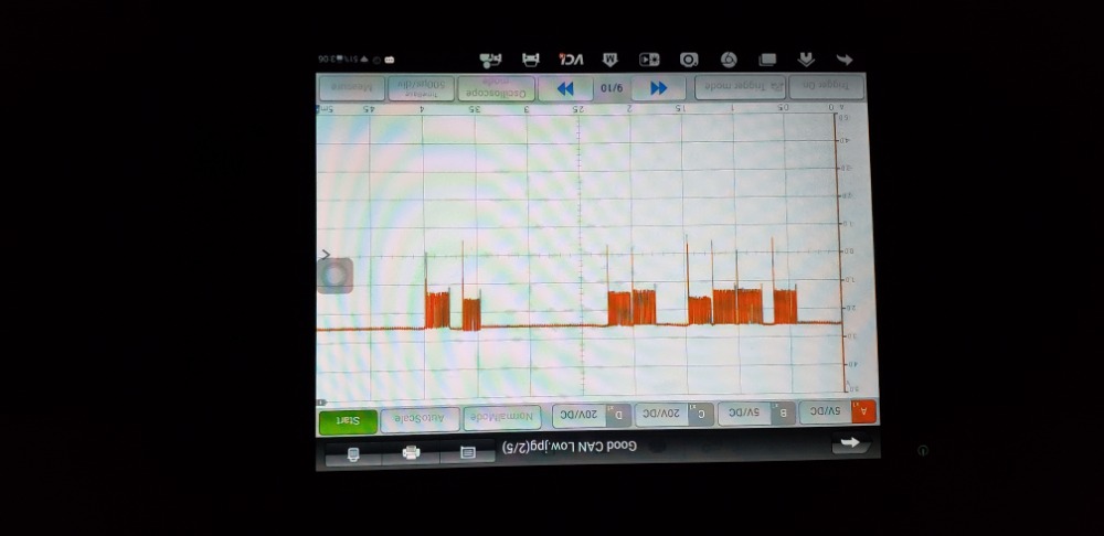

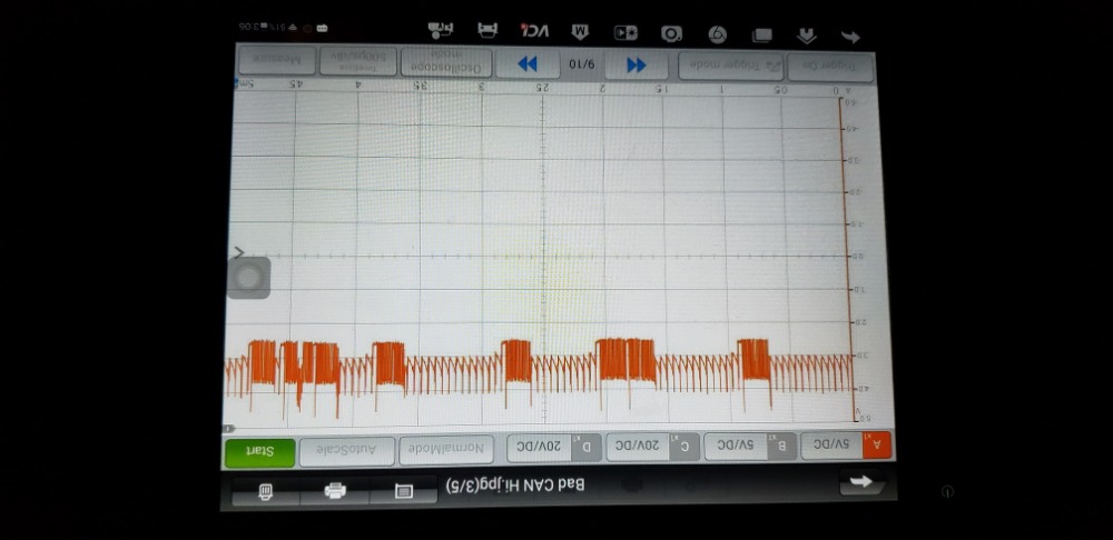

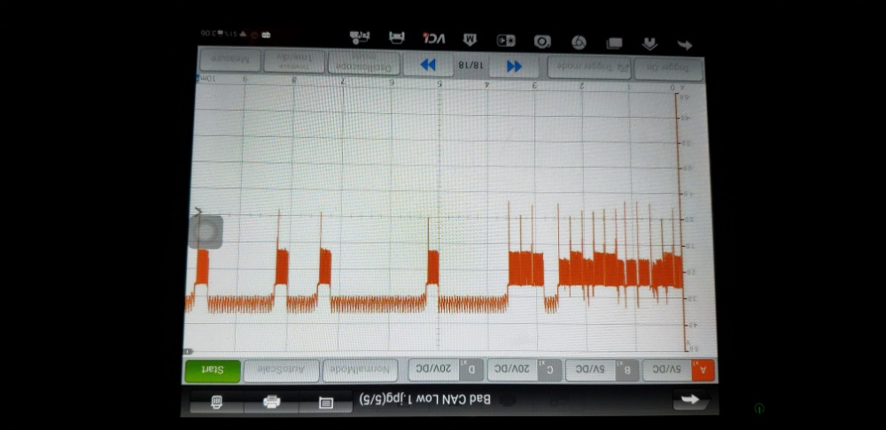

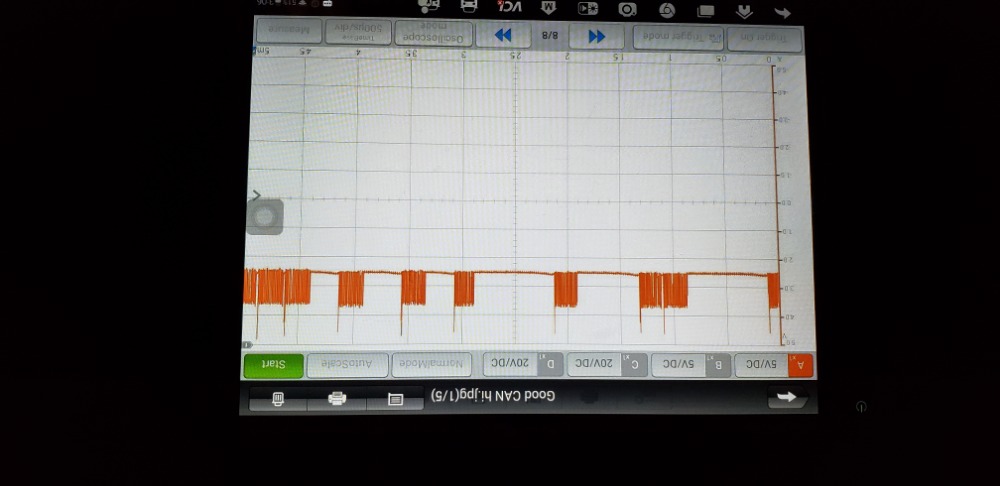

2017 Chrysler Pacifica CAN hi / low good waveforms and then randomly bad waveforms...troubleshooting drivability issues...any inputs greatly appreciated! Thanks.

Any codes? Any symptoms?? Those waveforms look bad
7 years 2 months ago #33119 by Tyler
Replied by Tyler on topic 2017 Pacifica CAN hi / low
Are you at the DLC, or one of the CAN C modules?
I'd suspect a bad module ground, since the bias is going above 2.5V in the bad captures.

There are 37 modules on this van and once the car acts up I get around 20 "U" codes on various modules not communicating with each other. It is very intermittent when the van does act up. It will run fine and my oscillospoce shows good CAN hi and CAN low waveforms but once it acts up, I get bad CAN hi and CAN low waveforms. The problem is it only acts up every few days only for 15 minutes or so. When it does act up everything is going crazy and I cannot shift the vehicle out of park either. The pictures of the bad waveform seem to be the 2.5vdc idle (rececessive state voltage) that is going crazy. I am at the DLC with a breakout box doing my scope work. Any help is greatly appreciated.
