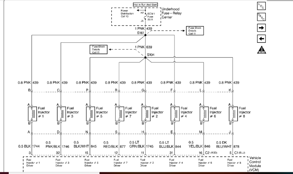

I have a 96 c1500 with a 5.7l engine, with a crank no start issue. Brief history, This is a new factory GM motor not a reman with approx 200 miles on it. New fuel pump, new dist, new Mpfi injectors, new crank and cam sensors, IC sensor, TPS, etc. Thing was running great, crank it up 1 morning and went inside and when I came back out it wasn't running tried to restart and all it would do is crank over. I have confirm spark all the way around even put on another new coil just in case other was weak, getting 61 psi fuel pressure, it is holding pressure at 55 for more the 5 min, pulled and check dist, cap and rotor, reset engine to TDC reinstalled dist cranked it over and reset engine to TDC rotor is back at # 1 cyl, so do not believe it jumped timing. Only think I have not physical check is the injectors actually spraying fuel, which I will do asap already have peallum removed. Any thoughts would be greatly appreciated. I am a DYI guy with a decent knowledge base mechanically but This thing has me about whipped. Thanks in advance DW.

Make sure you have voltage at the wire on all injectors. You can easily check with a power probe on the most easily reached injector. You may have a blown fuse to that circuit and it powers all of the injectors. When swapping engines somethings chaffing happens and shorts to ground. If fuse blows instantly when you try to start it it will have a short to ground. Simply put your Voltohmeter to continuity to ground on that fuse and wiggle wiring harness until your short to ground goes away.
I read earlier that you tried the brake cleaner into intake? Did that allow it to start? IF if did and its clearly a fuel related issue and we are on the right track. if you have voltage on the pink wire then put a test light in place and see if you have injector pulse. A lot of guys forget to connect the ground on the back of the cylinder head. just a thought keep us posted

Ok this is where I am at on my truck. First let me clear something up, one of the first things I did was to try starting fluid, and engine would not start. Which put me on the spark Track. Now I have confirmed without a doubt that I have spark, I have good fuel pressure and I just got through test the injectors. I have power, I have pulse and I physically pulled each injector and verified all of them or pulsing and spraying fuel. All of my grounds are good, I have checked a couple of cylinders and have good compression but I will go back and check all 8 cylinders. So I am at a complete loss here it should start or at least try to fire, We have all the ingredients. fuel, spark and air. I am open to any advice. Oh yea, no leaks with the spider system holds pressure and I physically check regulator, base and nylon lines. Thanks Everyone.
