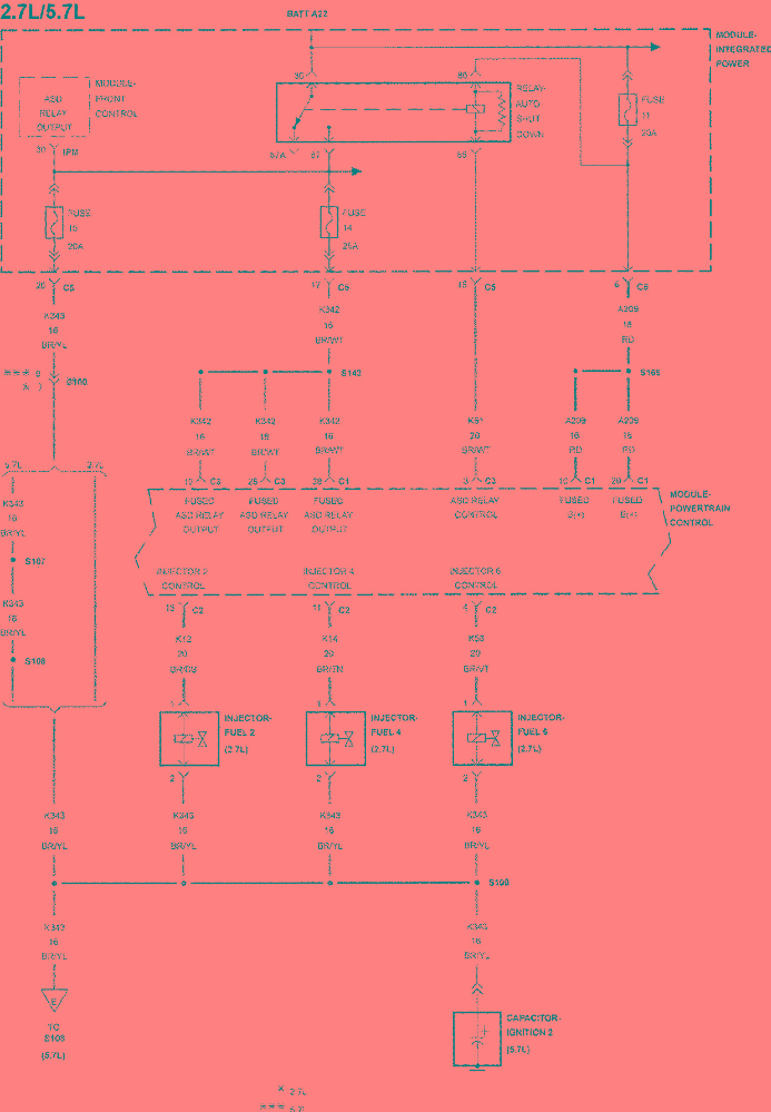

I replaced the plugs and got rid of 2 cylinder misfires. Found a bad coil to fix the 3rd. Found 12 ohms on 4 fuel injectors and 10 on the last 2. Replaced the 2 fuel injectors still open circuit on all 6. Found a couple of cuts in the wiring harness and repaired them. Now only showing p0206 code. With a test light and the key in the off position I checked 2 connectors at the fuel injectors. I have a ground on the hot wire and nothing on wire going to the pcm or on pin #12 where the wire goes to the pcm has no ground. On the bad connector I'm showing a ground on the hot wire as well as the wiring going to the pcm. I checked the pcm pin #4 and it shows ground as well. So do I have a bad pcm? Any suggestions?

how are you getting a ground on the hot side?

Too much sun today... hot wire was showing power communication wire showing ground on working injector connector. On the one I'm having issues with I'm showing power on both hot wire and communication wire

Sounds like your backprobing the pcm at the #6 injector driver and it’s staying at 12 volts?? If so move on from the wiring as it’s good. Try clearing the codes and recheck as Chrysler’s like intentional shutdown of drivers. If still stuck at 12 volts pcm driver is toast

So I started by checking ohms for each injector. I'm now getting 12 on every injector. I've used a noid light and it lights up on all connections except number 6. I replaced the connector and control wire and still cant get the injector to do anything. I will try to clear the code and try to see if I'm still getting the same 12v

I had one recently on a 2007 Chrysler that the PCM stopped grounding the injector on the control wire. These injectors are powered at all times on a common Voltage feed wire and the PCM grounds each injector individually. Get a lab scope or a test light connected to battery voltage and tap into control wire for injector 6 at the PCM. If the test light blinks at the PCM then you have an open in the wire where you can either find it or run a new wire for the control side. Or if its not blinking at the PCM then you have a bad PCM that lost ability to control the driver for injector 6 fuel injector
Should be simple to test.
