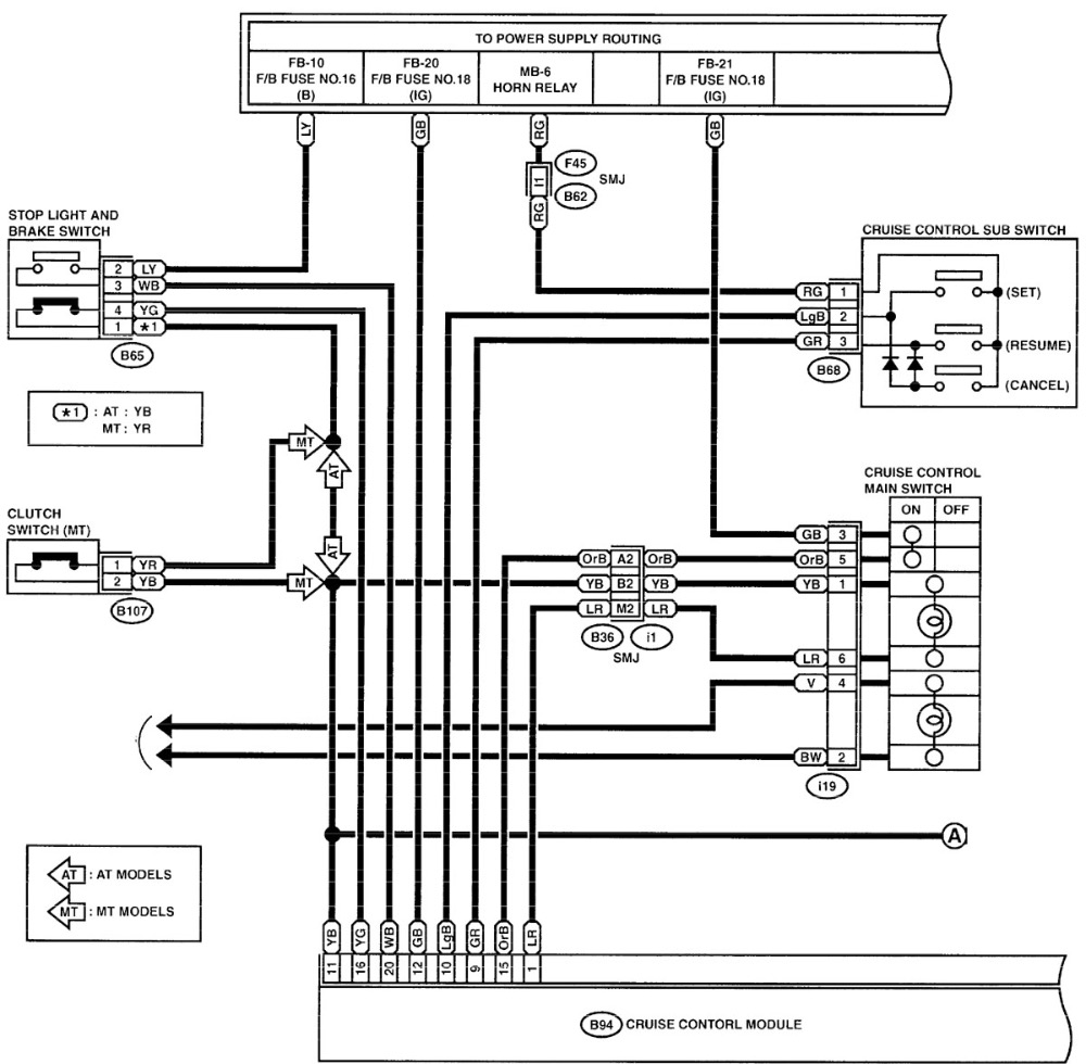

Has anyone had any experience or have any info on the cruise control for a 2001 liberty.

I live in Australia. I keep finding information about the legacy model. ill have to keep digging or maybe try and get some info from the stealership if it doesn't exist in united states.

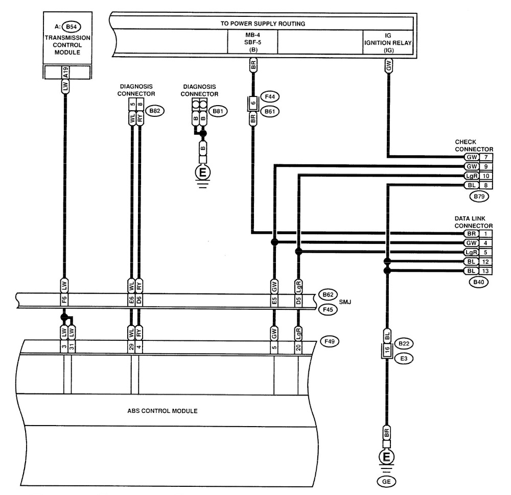

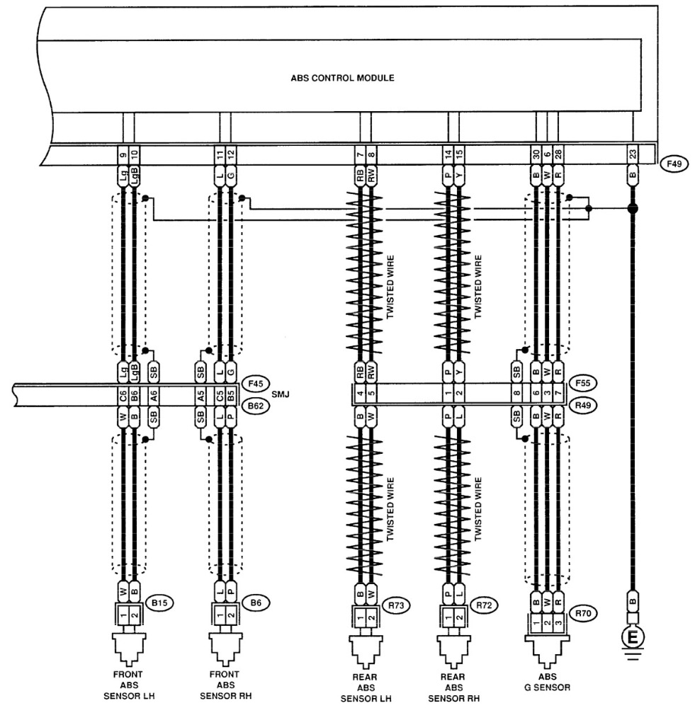

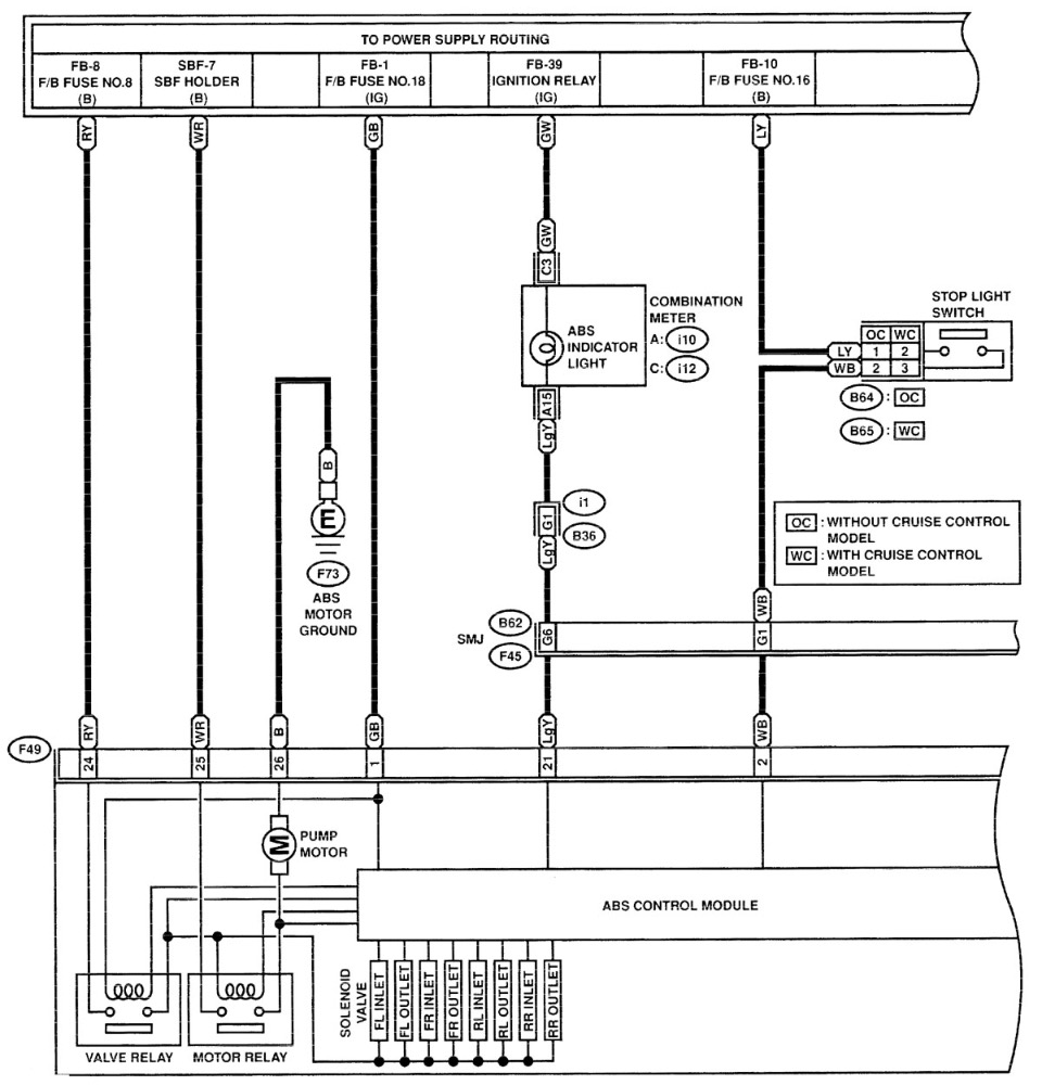

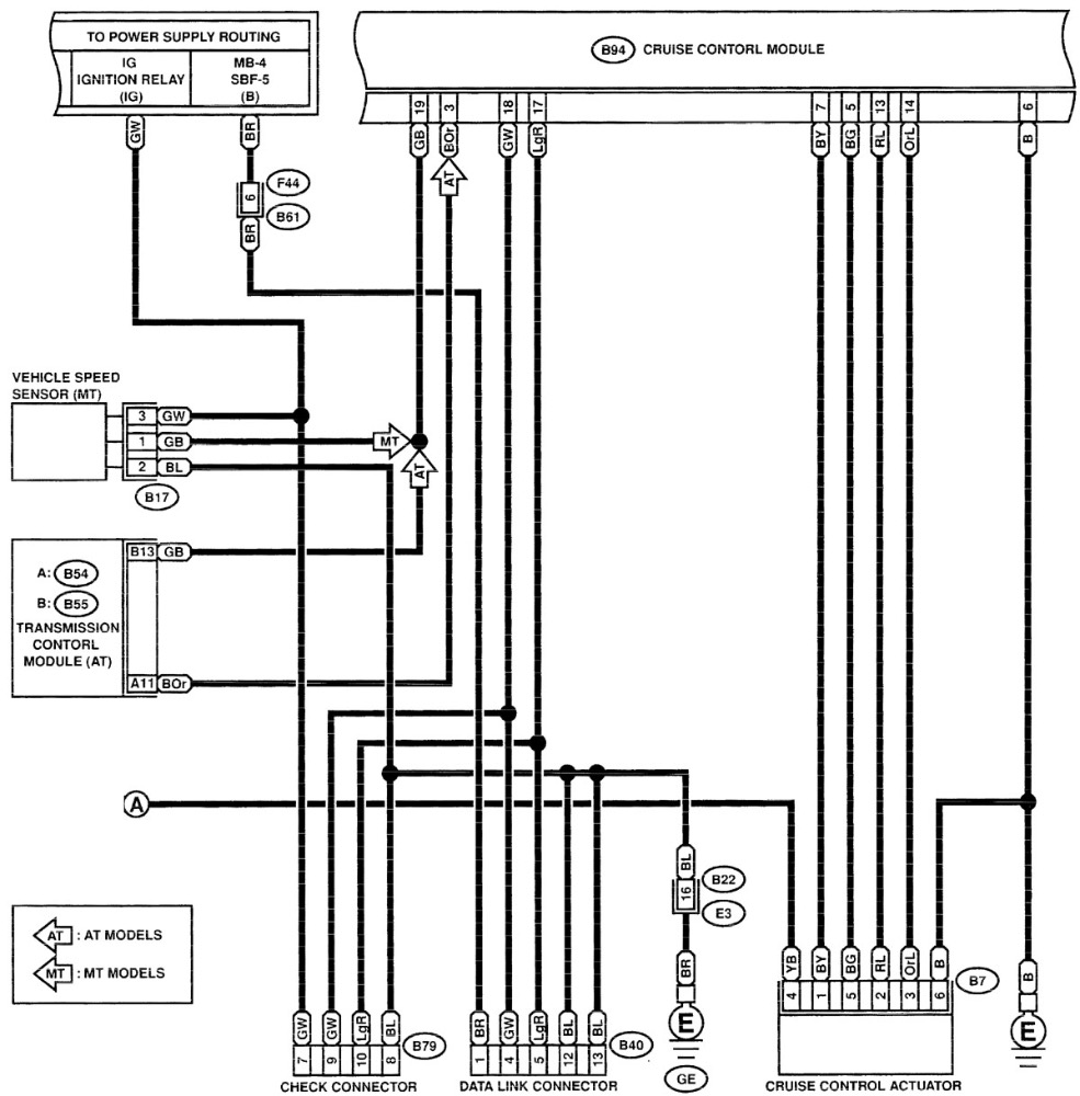

Here’s a diagram for a legacy 2.5 but I can’t anything for the liberty. I’d check this and see if the diagram happens to matchup with the vehicle if no other resource is available.
Sorry accidentally added abs too and am having trouble deleting
