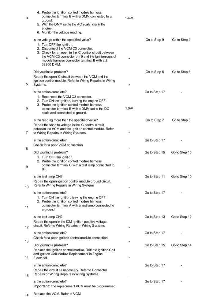

7 years 2 months ago #33364 by John Curtis
Replied by John Curtis on topic 1999 Chevy Tahoe 4x4 5.7L no start issue
Here’s a chart of it helps

7 years 2 months ago #33367 by CJ1488
Replied by CJ1488 on topic 1999 Chevy Tahoe 4x4 5.7L no start issue
Its a chevy not a chrysler
