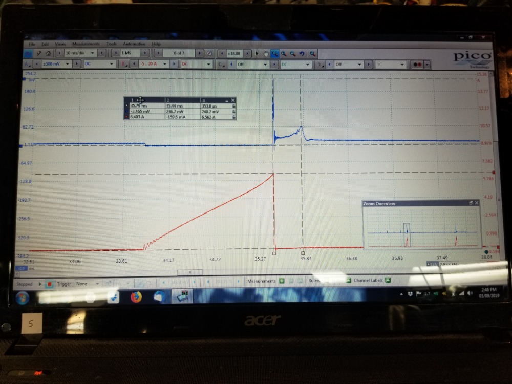

Any help with this would be greatly appreciated. I am new to reading wave forms as well, trying to get better. I will attach as much wave for pics etc.. as i can
Misfire is most pronounced around 1150-1250 RPM and tapers off a bit but definately does not dissappear the higher RMP you go. Can hear the misfire through the exhaust (dual) and see and feel the engine shake.

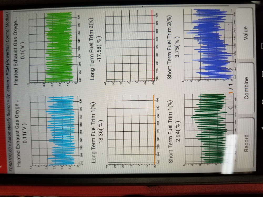

- Fuel trims are very lean (around -18%) at idle and around -7% at 2000 RPM

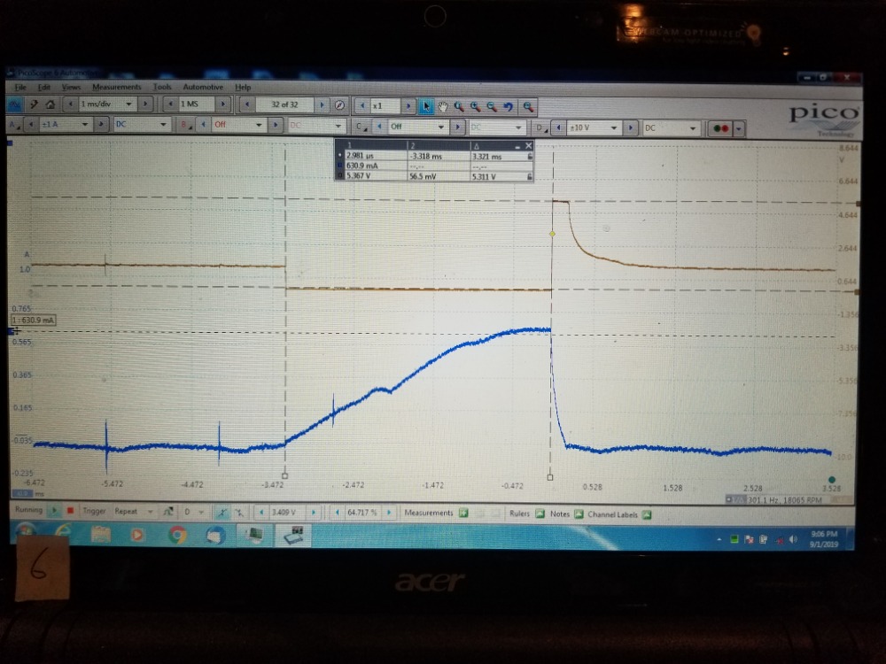

There is an photo upload limit to this forum so i will post a dropbox link to view all 8 snap throttle and 8 injector wave forms ( www.dropbox.com/sh/tgcc4ja0geiywx0/AACG5...4gatjbloMbgG18a?dl=0 ) . Cyl number will be on lower left of computer screen. Note: 10:1 attenuator was used when reading coil voltage.
My assumption is my random misfire is a lean misfire caused by my negative fuel trims. Assuming that is correct, what is causing my negative fuel trim numbers?

hi and thanks for the reply. I was told by a Ford tech that rount 265-269 kpa was normal (roughly 39.9 psi). For the reading i am relying on the cars pressure transducer being read by my scan tool. This year of vic they did not put an inline schrader valve on the vehicle to hook into (in order to save money). I am assuming if there was an issue with the pressure reg that too low pressure could create positive fuel trim numbers and too high and you would get negative fuel trim numbers. I played around by adjusting my fuel pumps duty cycle with the vehicle running and lowered it a lot, came close to stalling and the fuel trim numbers would come down some. I am assuming it is working fine because of this test

what codes you getting?? also what are fuel trims at idle? what is maf reading at idle?? check mode 6 data? misfire data?
