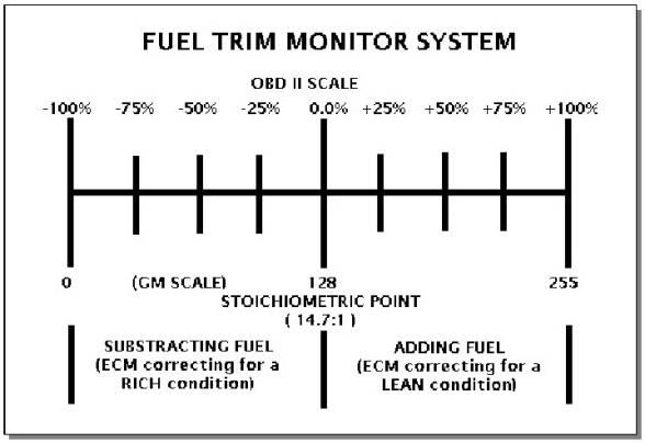

According to the chart 128 is neutral. I have a snapon MT2500. When my o2 is unplugged the ST and LT Fuel Trims stay on 128. When o2 is plugged in my STFT bounces between 0 and 40 give or take some. But the numbers do not show a plus or a minus next to the numbers. My LTFT has gotten down to 62. Again no plus or minus sign by the number.
QUESTION:
Because my numbers are below 128 on a scale from 0 to 255 does that mean my Fuel Trim numbers are considered Negative or Positive according to the chart?
(Note) As described above when my STFT hits 0 and bounces up to 40, where in the chart is 0?
QUESTION:

Below 128 is subtracting fuel, above 128 is adding fuel.
62 LTFT would indicate the 02 sensor is leaning out meaning you have a rich condition. and the computer compensated for this be subtracting fuel.
Time to find the cause of the rich condition.

After a repair your short term fuel trim should be on the opposite side of the long term to get the value as close to 0 or 128 as possible 118 to 138 is a good range.
Example
Before repair of a lean condition it might look like
LTFT +17
STFT + 3
Total fuel trim = +20
After repair it would be something like this
LTFT +17
STFT -15
Total fuel trim +2 (+/- 10) on a good fix

The LTFT will take some time to get back into range. But total fuel trim is the key indicator and confirmation of a fix
Replied by John Curtis on topic Fuel Trim Chart Positive or Negative Numbers
randy61 wrote: The only factor I didn't mention was that I made some repairs and the LTFT has been decreasing, I think due to ECU relearning.
I don't suppose that because the LTFT has been decreasing that it makes any difference regarding a rich condition, as far as it correcting itself. Would that be incorrect to make that assumption?
Thanks again John.
