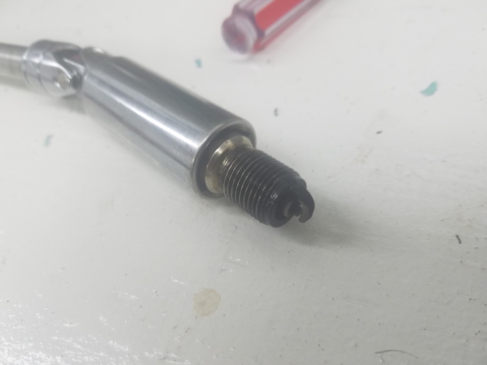

1987 GN that has had a persistent random idle miss when warm. Does not appear to have it when cold or off idle. Engine speeds up and down randomly 800 - 875 rpm and coincides with the miss. Also have an 1989 Turbo Trans Am that has the exact same engine that runs %100 perfect. Have swapped every single bolt on part, except the crank sensor, from the TTA one at a time with no improvement in the GN or degradation in the TTA. The hydraulic cam was beginning to wear out so I hired a shop that specializes in these cars to replace the cam with a roller cam and put in aluminum ported heads as well, hoping it was a valve train issue. Cam is a Comp Cam 206 206 which is mostly stock except for a bump in the upper mid range. Car has more power but still has the exact same miss issue. Confident there is no change in idle quality with the cam and head swap - no worse no better. Replaced fuel injectors as well with new ones with the correct matching chip. Fuel pressure looks to be stable. Bought a smoke tester - no vacuum leaks. Ran a shop vac in blow mode into the tailpipe and verified no pre O2 exhaust leaks. EGR has been permanently blocked.

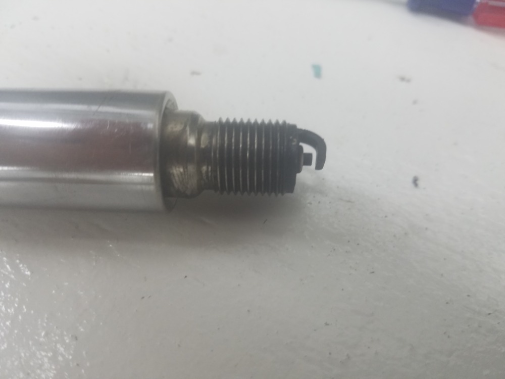

Attached pics of one spark plug. I took out all 6 and they all look the same. Rich.

Making progress? Misses are less and the car just sounds stronger at idle.
Replaced the plugs. Found out that it can help to reduce the air gap on the crank sensor on the outside - so bigger gap on the inside.
