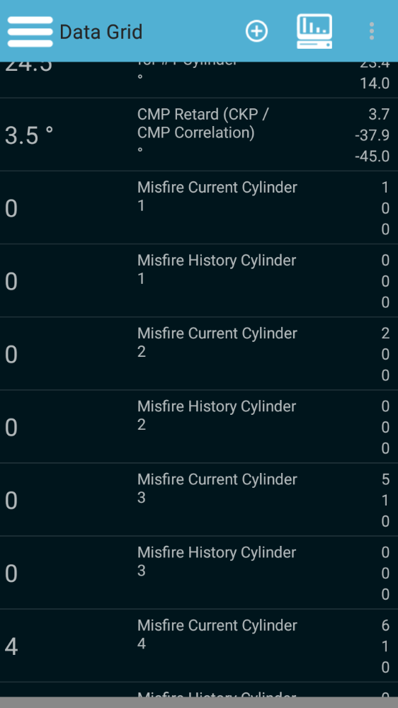

The vehicle has 210000 on the clock. 5.7L vortec
I've been getting a code p0303 for about a month. It consistently throws the code when going uphill with the engine lugging in 3rd or 4th. Once it kicks down, the miss stops.
I swapped the 3 and 5 plug wires and plugs, but the code stayed with cyl 3.
I changed the distributor cap.
I've idled the engine and sprayed brake cleaner, propane, and hose water all around the intake manifold and head to block seam, with no change to the idle. I haven't tried a smoke test.

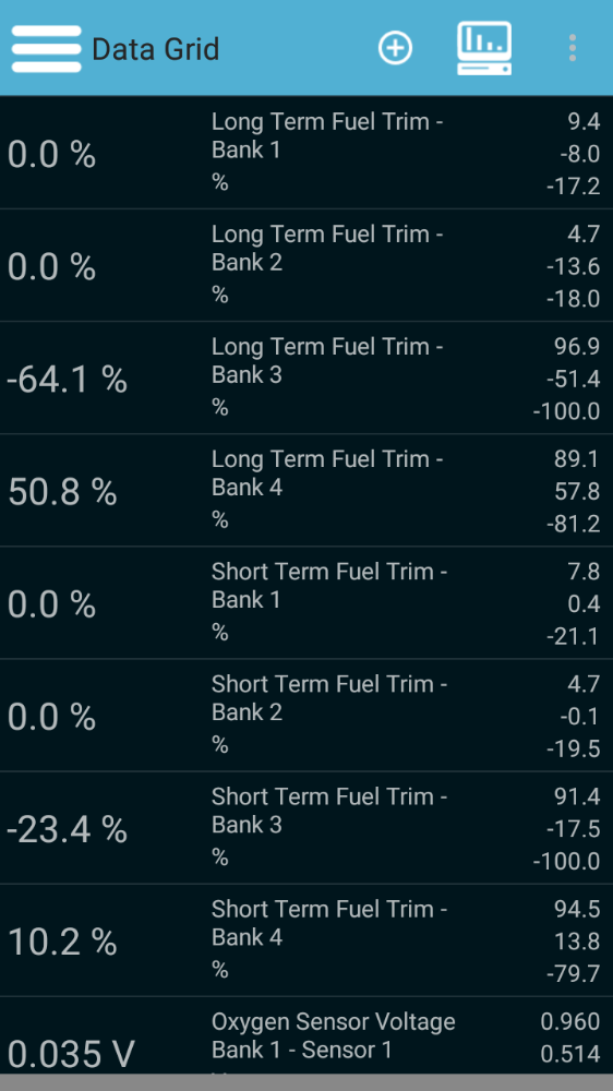

Today I bought the BAFX bluetooth thing, and DashCommand. Screenshots are below. Some of the fuel trims seem way out of whack. They also vary widely. The screenshots were taken over about a 20 minute period.
I have a distributor ready to go in, because either a worn gear, or wobbly bushings seem to be a common problem. But I have no evidence that's the problem.

Not familiar with that scan tool however you can’t always trust scan data. Can it graph? I’d like to see fuel trims AND O2 data.
Also freeze frame data for the code.
Is there a lack of power?
What happens to o2 data at WOT?
Check for weak spark?

The freeze frame for when the code is set is below:
Fuelsys1 - CL (closed loop?)
Fuelsys2- CL
Load_Pct % - 21.6
coolant temp - 198
Short term fuel trim 1 - 17.2%
Long term fuel trim 1 - 12.5%
Short term fuel trim 2 - 21.1%
Long term fuel trim 2 - 12.5%
MAP (kPa) - 23.3
RPM - 1847
VSS (km/h) - 52
MAF (g/s) - 6.601
TP% - 30.2

those fuel trims indicate you have a rich condition...
CL is Closed Loop... the 02's are working.
What do the ST and LT fuel trims do when you raise the RPM from idle to 3k.
