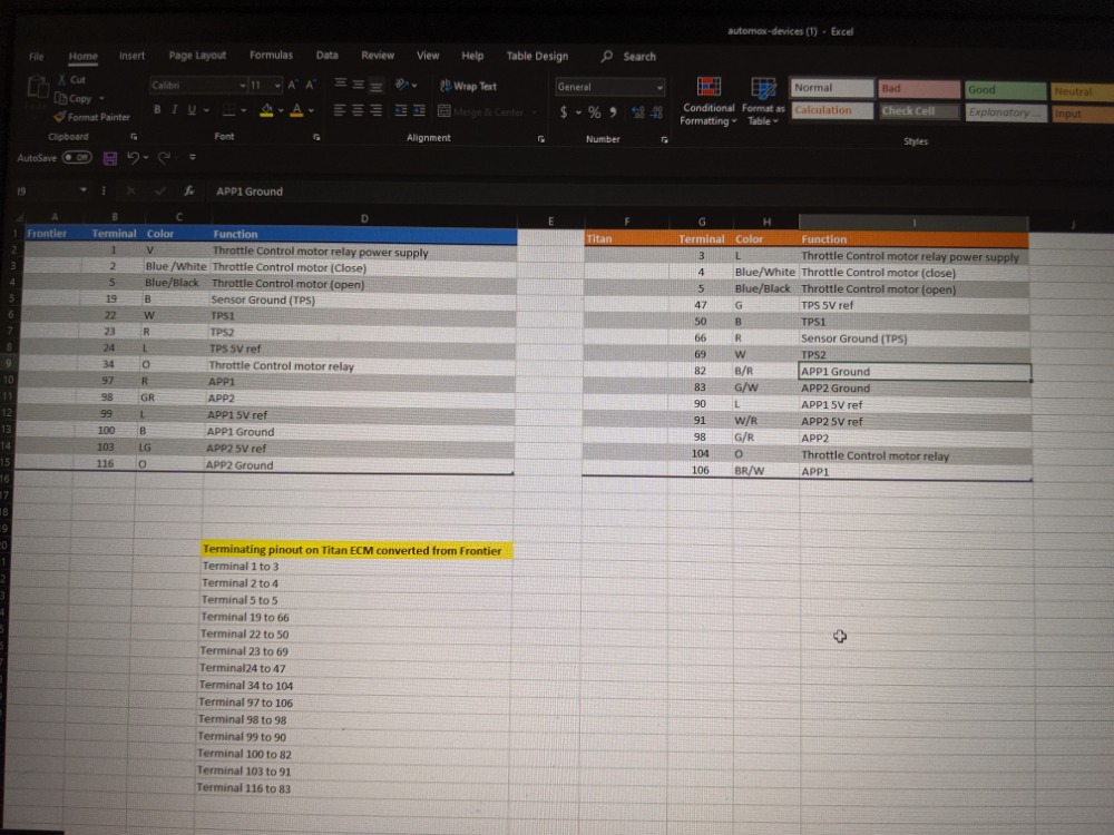

I have been trying to track down an extremely temperamental P2127 and P2138 code that I get on my 2013 Nissan Frontier with a 5.6L VK56DE engine swap (engine from a Nissan Titan), custom intake manifold with a Nick Williams 102mm DBW throttlebody (GM TB, 6pin plug), 525CC injectors, Walbro lph255 fuel pump.
Before we fault the engine being swapped, this swap has been done so that everything is 100% native to the vehicle. It used a 2013 Nissan Titan ECM, a repinned harness that accounts for the subtle difference in the Frontier wiring and Titan wiring, and the BCM has been reprogrammed at the dealer for the security features, and the VIN was updated on the ECM. There are no codes disabled, indicator lights, or other issues. For all intents and purposes it's basically a Nissan Titan stuffed into a Nissan Frontier chassis. Even the dealer couldn't pull up anything odd from the CONSULT side of things.

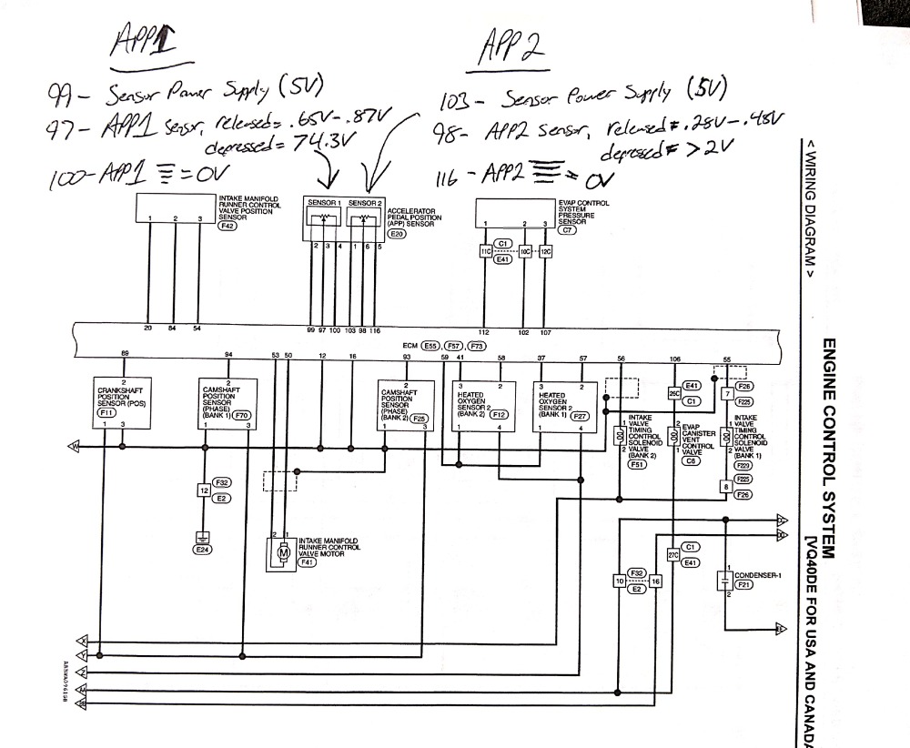

The wiring diagram only has numbers on it, I am going to go through and notate everything and post up the diagram labeled.
Question: since the ECM is going into "limp mode" once the p2127 and 2138 are triggered is it not doing that by pulling the APP2 voltage? I guess before I thought maybe the APP2 voltage getting zeroed out would have been a function of the ECM going into that safety mode.
If that's not the case then you might be on to something about 5V having issues..

Here is the diagram for the APP side, I notated the connections on the ECM side above for each sensor.
If you see anything else of interest here let me know and I can lookup what it is.
6 years 11 months ago #33641 by Cheryl
I would definitely backprobe the 2 5 volt reference wires at the app with a scope and make sure you aren’t losing one of them to start. So you will need atleast 2 channel scope or even a single channel you would just have to do them separate and keep it backprobed til the malfunction occurs on both feeds to rule them out.
6 years 11 months ago #33642 by Cheryl
Or go across the 5 volt ref and ground at the pedal on both sensors. Such as pin 99 and 100 for app 1 and 103 and 116 at the pedal That’d rule out the power and ground for both sensors if you keep scoping it until the malfunction occurs and neither drop out

Attached is the wiring I've broken down from FSMs
