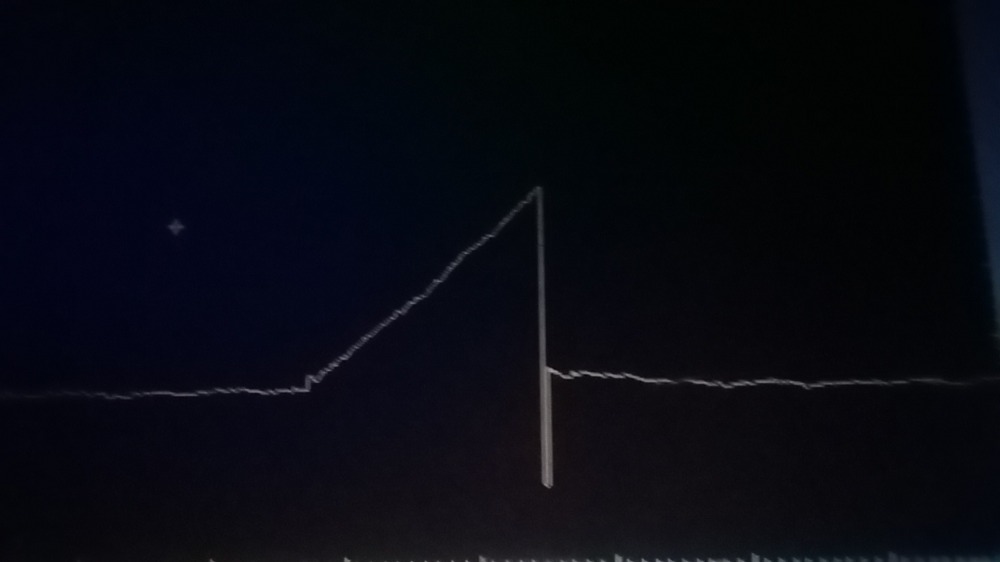

7 years 1 month ago - 7 years 1 month ago #33647 by jerry r
2002 mercury villager running rich was created by jerry r
total trims at idle -9 at 3000 rmp -15 total .injectors are good tested fuel pressure reg passed ,map test tested good, replaced plugs and wires a year ago. has a strange drop out on primary current test. picture below

fuel trims total -20 at idle intermittently, tested at the distributor with a spark tester tested good at 30kv strong blue spark, but nothing at 40kv.
7 years 1 month ago #33676 by Chad
Replied by Chad on topic 2002 mercury villager running rich
That current waveform looks like an open plug wire.
The following user(s) said Thank You: Noah, jerry r
7 years 1 month ago #33682 by Noah
Replied by Noah on topic 2002 mercury villager running rich
Chad wrote: That current waveform looks like an open plug wire.
For days now I've been trying remember what that giant tail on the current ramp is all about!

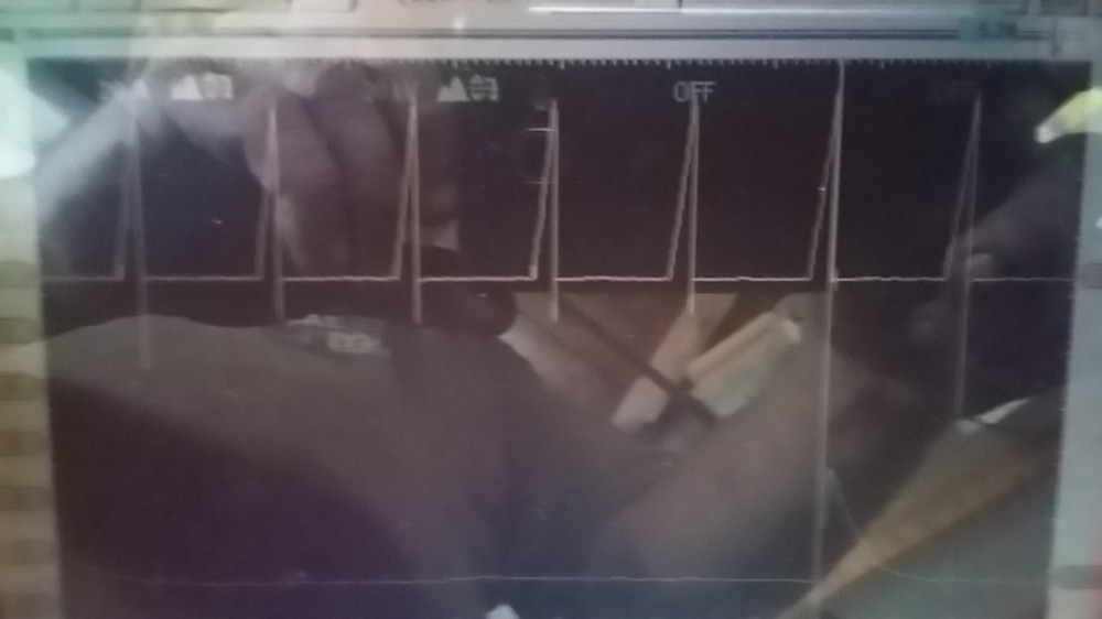

  • jerry r
  • jerry r's Avatar Topic Author
7 years 1 month ago #33684 by jerry r
Replied by jerry r on topic 2002 mercury villager running rich
it showing up on all cylinders

5 years 1 month ago #51375 by VegasJAK
Replied by VegasJAK on topic 2002 mercury villager running rich
As Chad said open plug wire.
Secondary turn off oscillation. Coil buildup secondary voltage with no place to go due to open plug wire.
