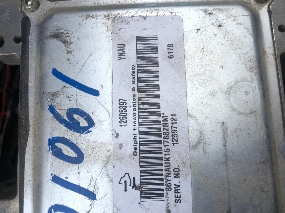

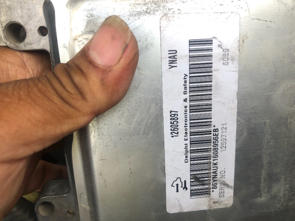

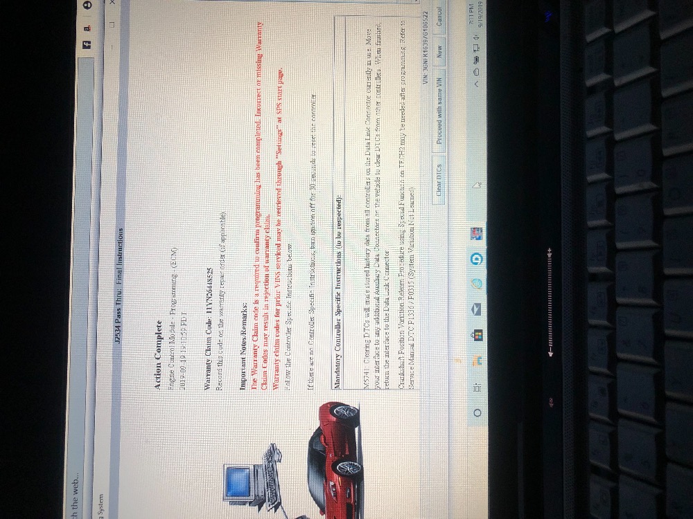

Hello guys. I have a problem with this suburban . I did the diagnostic and was the 5 volt circuit. Not workig right so i take the ecm to get repair. After a day they call me and say the processor was bad. Cont be fixed . So I bought another ecm from the junk yard with mach number . I pay 43$ at the acdelcotds. For programing. I did everything. I completed the programing. I cleared the codes.
Then i did the relearn key .
But the truck. Crank but no start
I read for codes and pop 7 codes..
P0107 is a diagnostic trouble code (DTC) for "Manifold Air Pressure (MAP) Barometric Pressure Sensor Circuit
P0118. Engine Coolant Temperature Circuit High Input
P0122Throttle Position Sensor/Switch A Circuit Low Input
P0223Throttle/Pedal Position Sensor/Switch "B" Circuit High
P0315 OBD-II Trouble Code: Crankshaft Position System Variation Not Learned
P0443Evaporative Emission Control System Purge Control Valve Circuit Malfunction
P0633 Immobilizer Key Not Programmed – ECM/PCM
I can hear the fuel pump whe kick on
My concern is. With old ecm. I dont have all those codes. And the truck runs. And driving not really good but it run.
Can enyone give me a idea where to start. Thank you

Check the number on the back of the ecms And i use. The vin #. From the sticker at the door

Well guy i just want to thank you for all the help. The solution was.
I find another ecm at the junk with the same. Number. So what i did was just plug it. And do the key relearn
11min. Swich on
30 sec. swich. Off
11.........
30...........
11........
30........
30 sec. switch on.
And start right away. The. Did the crank relearn.
And its running like a champ
No programing need this time
No vin mismatch codes. At the ecm.
And bcm. No codes
