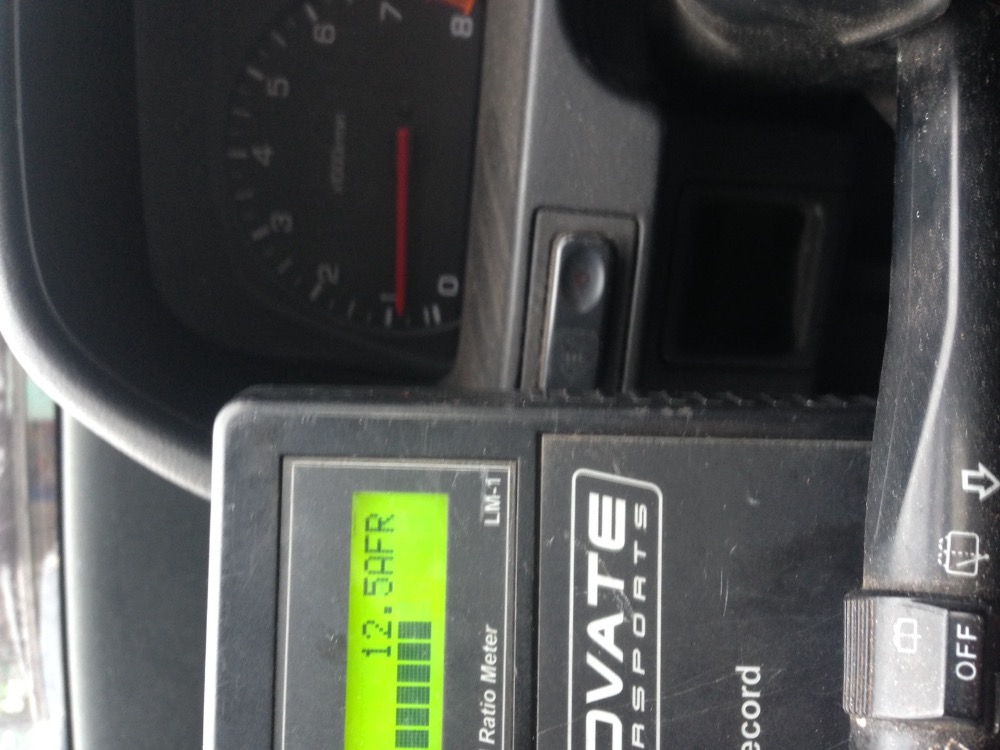

I rechecked ignition timing is it set at base timing, I read that map sensor does not affect ignition timing only above idle in the mapping tables. I'm going to check for 3 volts at the PCM from the map sensor signal and ground, with the map sensor plugged in. I'm also installing an innovate wideband LM1 this week, as I bought one second hand. I don't know what the fueling is like but it feels and sounds to me that the cars lacking in fuel. I will update in the week, I need to keep persisting with this

6 years 11 months ago #33961
by Crombie
Its idling at a rich 12.5 air fuel, but it goes lean from quarter throttle upward 14-16, the overrun it drops to 11 rich. So I decided to adjust the TPS after I checked the map sensor off voltage which was 2.9v, and the air temperature sensor was 1.6v approx at around 55F. I checked all the sensor grounds too, though I haven't checked the map sensor ground from another sensor ground, as the battery it drops it to 0.2, when it should be no more than 0.1, so I need to check it from a PCM ground, and the map sensor doesn't share a ground with the other sensors.
I then proceeded to adjust the TPS to 0.42 from 0.48v, I was expecting to see the Idle fuel ratio to go a bit more lean, but its at 11.4 most times now, I thought it meant the PCM would see less throttle and deduct fuel, but it had the opposite effect. Either way when driven again its still lean, but very rich at idle and overrun

I worked out most of the problem, there's two primary oxygen sensors, one of the pins I hooked up at the ecu to o2 sensor B, was the wrong way round so it was making poor contact, one was reading lean and the other rich, so I read if you have the pins the wrong cylinders it can do that, so I swapped them round, and went for a drive it then surged whilst driving, so I unplugged both sensors, as per manual instructions to see if it would be better, it ran pig rich and choked the engine. So I put it back in the correct location and it read lean and rich, one lean one rich. Anyway after reading online this is how these primary sensor actually work! OBD-0 its a balance thing, Im not totally sure how it works but that's how they're supposed to read. The problem is these are 1 wire o2 sensors so they don't heat up very well, and especially in a stainless header like I have, also in the cast iron header the o2 sensors are designed to sniff two cylinders at a time, 1&4 and 2&3, I had two bungs TiG welded into the header so its only sniffing two cylinders, but it runs far better than it ever has. I have to still sort the warped runners though, but it means dropping the subframe, I don't know why they didn't make these aftermarket headers in two pieces for the B-Series Honda engines. Anyway its as good as its gonna get, this is why Honda tuners convert to OBD-1, as you can either run a heated o2 sensor further down, or just map the engine without o2 sensors. The problem with welding bungs into the runners of the header is the problem that I have now, its warped them. I've got to find a machine shop with a large belt sander or milling machine
