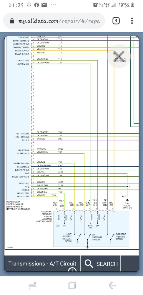

6 years 11 months ago #33791 by Kurr
Replied by Kurr on topic .150 V on engine block?
Tcm gets its ground on block above starter on this vehicle according to wiring diagram.

6 years 11 months ago #33795 by Kurr
Looks as though the pcm shares the same ground. Was just wanting to make sure there wasnt anything else that could rule out a new tcm, but it appears that would be the issue. Hopefully the transmission did not get ruined in the process. Thank you for your input, cheryl.

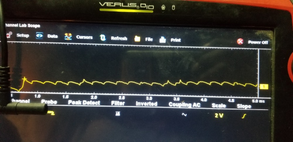

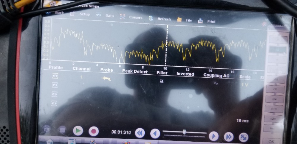

6 years 11 months ago - 6 years 11 months ago #33847 by Kurr
Attached ac ripple from alternator, old alternator and one I put on this evening. Also brought the engine grounds down to .090 V. Still having tcm issues.
