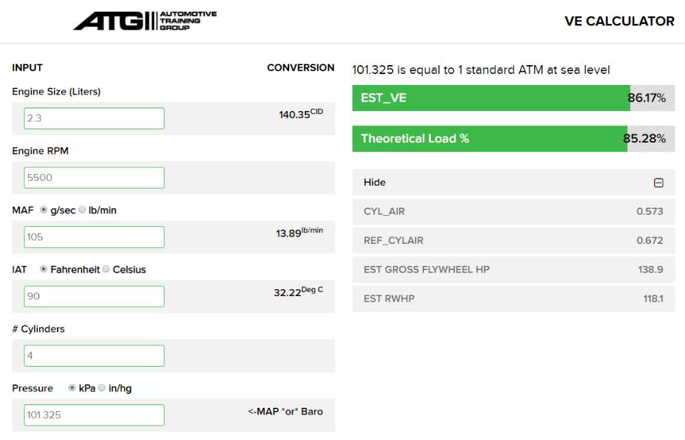

7 years 1 month ago #33905 by Tyler
Replied by Tyler on topic Mazda 3 Running Lean
ajherrera58 wrote: I'm not sure about actual voltage unfortunately my scan tool doesn't measure that but under those conditions I can get like 100 g/s I think maybe the highest I've seen is 101, 105?
Eh, that's not terrible? I threw that into a VE calculator and got a decent result:
Still doesn't explain the lean. :unsure:
As for the intake tube, I actually have a cold air installed by the previous owner so no problem there.
Oh, really? :huh: I know CAI's are supposed to be an upgrade, but that only works if they allow the MAF to measure correctly. I'm guessing the old intake plumbing is long gone?

7 years 1 month ago #33931 by Tyler
ajherrera58 wrote: I did this a little while ago using this calculator and using the parameters from the scan tool I wasn't getting anywhere close to those numbers.
Would you mind doing another WOT run through 1st gear for us? Capture the data if at all possible, or just record the highest values. We mostly need the highest MAF value and the engine speed during peak airflow. It'd also be useful to know what the upstream O2/AF sensor is doing at WOT.
For arguments sake, say it was a VE issue what exactly would I do next?
Then you'd start looking into plugged cats, restricted intake, like that. Still, none of those will account for the lean trims you're seeing. There's a genuine fueling issue at work.
For your fuel trims to be equally lean across all loads, you've got a few options. Ethanol fuel, though I doubt you'd make that mistake at the pump. :silly: A stuck open purge valve, which you could eliminate by disconnecting the vapor line from the purge valve and capping the end. Then there's the MAF, which we'll hopefully address with another VE test. :cheer:

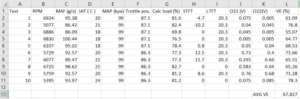

  • ajherrera58
  • ajherrera58's Avatar Topic Author
7 years 1 month ago - 7 years 1 month ago #33944 by ajherrera58
Replied by ajherrera58 on topic Mazda 3 Running Lean
Hi sorry for the late reply today, had to wait until I finished class. But I put together a table of data from 10 tests that I ran. This was captured from a cheaper autel scan tool, but I went ahead and made a column for the Volumetric Efficiency using that same ATG calculator. Its the last column and its followed by the avg VE of all the tests. Let me know what you think

7 years 1 month ago #33946 by Tyler
Love the chart. B) Definitely low numbers. Not to nitpick, but did you mean to label the O2's as bank two? :huh:
Anyway, it sure looks like your MAF is done. Only other things I'd investigate are debris in the MAF itself, or anything that might cause the MAF to incorrectly measure.

7 years 1 month ago - 7 years 1 month ago #33953 by ajherrera58
Thanks! But sorry that's my fault O21 is upstream and O22 is the downstream. I already went and cleaned the MAF so cant be that. I don't know what could really be preventing the MAF to not measure properly, I've checked the intake tubing and its all clear. I'll go ahead and replace the sensor hopefully that fixes it.
Also side note, is it weird for my MAP sensor to automatically turn to 99 kPa for every test? And in terms of throttle position do those values at WOT look normal? Thought they might be higher? Thanks
