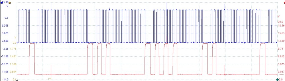

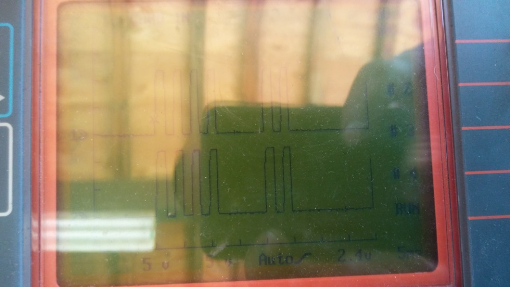

I'm looking for a known good cam/crk wave from. Thank you.

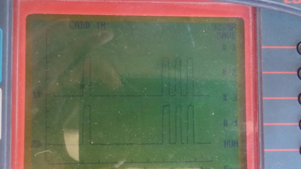

Thank you brother, it is way different than mine I must of gotten the wrong wire.
7 years 1 month ago - 7 years 1 month ago #33951
Replied by Tyler on topic 04 nissan sentra 1.8 cam / crank wave form
Agreed, I think you inadvertently double probed the CMP. OR the CKP and CMP are shorted to each other? That'd be bananas. :silly:
