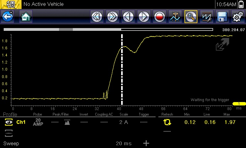

Hey radau! For what it's worth, I don't believe you're looking at a solenoid issue. The fact that you can feel the TCC unlock at highway speeds makes me think that you're dealing with a hydraulic or mechanical issue and not an electrical one.
IMO, the best way to rule out a solenoid problem would be to manually energize the solenoid with a jumper wire with an amp clamp around the solenoid power feed wire (pin #6). Besides being able to listen for the solenoid to *click*, you'll also be able to see the pintle movement in the current waveform. AND with application of ohms law, you'll also be able to prove good current draw.
Here's an example of this test on a Toyota with a transmission problem. The solenoid resistance specification was 5.5 ohms.
The Guided Component Test in my Modis says the solenoid should measure 2.7 to 3.4 ohms. Measuring that would be fine and all, but doing the math shows you should see that solenoid draw around four amps. Because it's a lower resistance solenoid, don't leave the jumper in forever.
Just long enough to get the waveform.
If you don't have an amp clamp available, the jumper wire test can still be useful, especially since bidirectional testing isn't an option at the moment. If you hear a solid click out of the transmission pan when you apply the jumper, then you can be reasonably confident the solenoid is moving.

7 years 3 weeks ago #34286
by radau
Replied by radau on topic 2007 Hyundai Santa Fe 2.7L P0741
Hi again Tyler,
Going to be able to see the car in a few days most likely and just wanted to clarify.
I do have an amp clamp that came with my Modis but I'm not positive on how to use it to energize the system. Pin 6 has constant voltage so I believe #9 (TCC) is the ground for the solenoid. This means it's ground controlled right? Please correct me if I'm wrong I haven't dealt with shift solenoids.
If I supply 12V to Pin #6 and then ground Pin #9 would that be enough to test the solenoid? Or should I be doing something else? Again I do have an amp clamp, I've just only used it to get readings so not sure on what I should be doing with it to test the solenoid.
Thanks!
