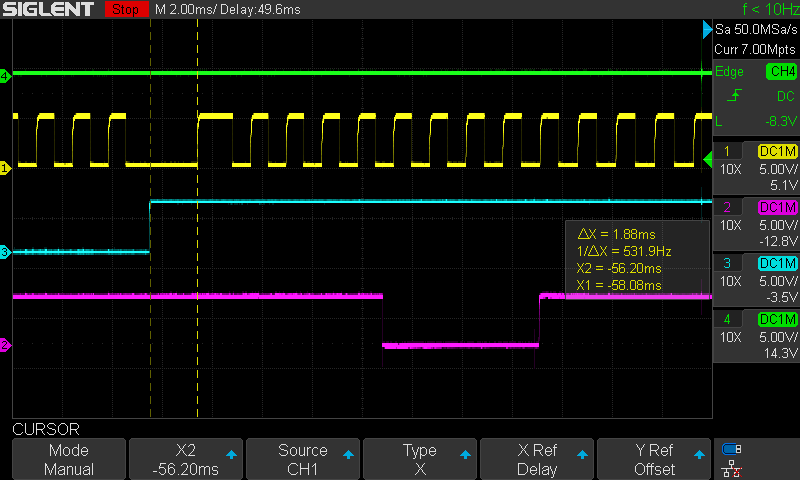

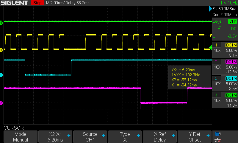

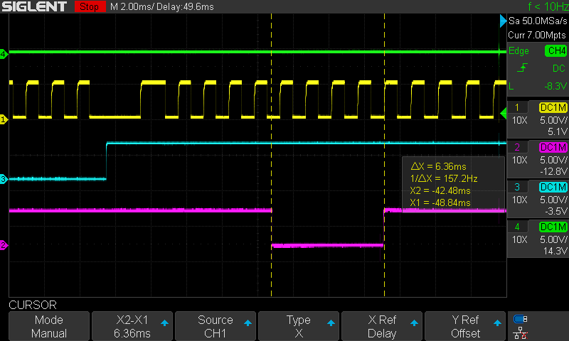

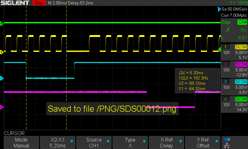

Hey All,
I have a 2008 Suzuki XL7 3.6L that contains a GM LY7 engine.
The vehicle is experiencing random misfire, and misfires on cylinder 2, 4, and 6. I've pulled the codes, I don't remember them off the top of my head but they but they are for those errors.
I'm trying to figure out cam/crank correlation since I know timing chain was a notorious issue with those engine. Does anyone have a known good waveform for this engine? I've scoured the internet high and low, and only managed to really find one diagram for bank 1.
Thanks,
Alan
Thanks,
Alan

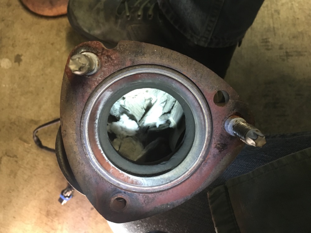

Chains are definitely notorious with this engine, but do you have any timing codes? Because if not, I'd say you're in the clear as far as the chains go. These PCM's are quick to code for timing problems.
Misses on bank two only would suggest a plugged catalytic converter, IMO.

Yeah personally I'm kind of skeptical its timing as well since its not throwing cam/crank codes, but I figure it doesn't hurt to check.
The cat. point actually makes a lot of sense. I definitely over looked that. I'll look into the cat and see whats up.
Thanks,
Alan

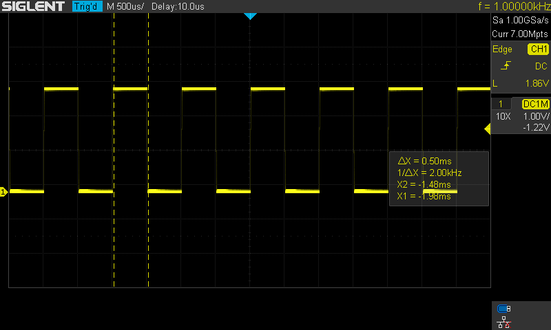

7 years 1 month ago #34048
by Midnight_Commander
Replied by Midnight_Commander on topic 2008 Suzuki XL7 Random Misfire/Timing Waveforms
- Midnight_Commander

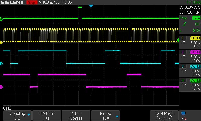

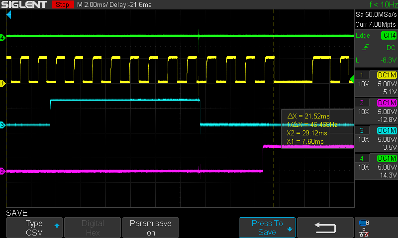

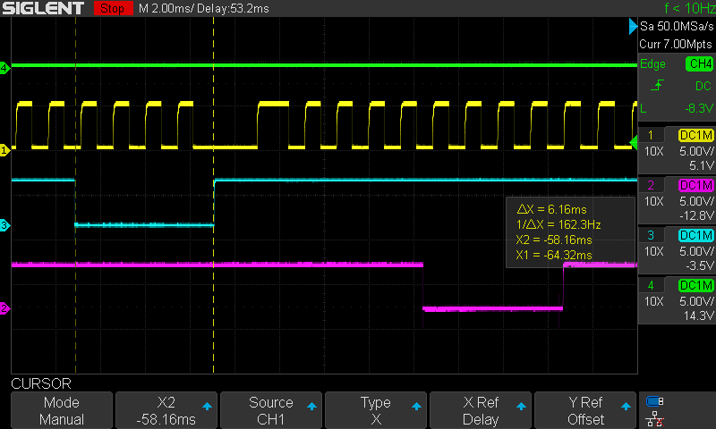

Hey All,
Sorry about the double post. I cleared the obstruction in the cat. but as it seem the misfires are still occurring.
I also got the waveforms off the ECU, I'm still in search of the bank two wave forms from a known good configuration.
Thanks,
Alan
Thanks,
Alan
