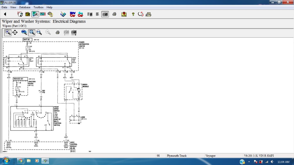

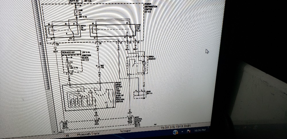

Hello Scannerdanner community I have a problem child of a car that's kicking my rear. It's a 1998 Plymouth Voyager (Dodge Caravan) that has front windshield wipers that never turn off. Once the key is turned to the run position the wipers turn on and never turn off (so far). The only way I can shut them off is by turning the key off, unplugging the relay or unplugging the connector for the wiper motor/module. The wiper module is controlled by the BCM and the main inputs to the BCM are the wiper switch and the wiper park sense switch which is integrated in the wiper module. The way the circuit works it seems is the park switch is actuated when the wiper arms move to the rest position (park). The switch grounds the sense input to the BCM so it knows when to turn the wipers off in conjunction with turning off the wiper switch (multi-function). So my issue is I don't know whats faulty the BCM or the wiper module. The wiper park switch seems to be working properly because its pulling the sense circuit to ground when the wipers go to their default position. Now i was concerned with wiring back to the BCM from the switch but i noticed what seems like a bias voltage on that input when it's not being grounded. So if that voltage is present even when isolated from the switch then to me it is obvious that the wiring is fine because that voltage is being sent from the BCM. I did notice the voltage I'm seeing on that circuit is 4.5 volts roughly so I'm not sure if thats what I should be seeing. I'm kind of lost guys and any direction or help is appreciated. I'm going to attach pics of the circuit. Oh and I did pull codes from the BCM and i got a code that says wiper park switch fault. It's a strange code because it doesn't have any numbers in front of it. I'm assuming that's due to the car being so old and Obd2 systems were still in their infancy stage. Thank You and I am truly greatful for this community.

6 years 11 months ago - 6 years 11 months ago #34026 by BrandonF
Replied by BrandonF on topic Front windshield wipers that never turn off!!!
Never went at this issue with a caravan, voy, t/c..... but I do tend to the see a lot of CTS's with this similar issue. In that vehicle the input is not through the bcm however. In this case, with the motor/module being one, I like to eliminate the signals to the module. On the CTS's, I'll just quickly depin (instead of cut) the 2 input signals from the switch to the module. On these "piles", she will short to power on the signal inside of the module.....they'll run all dang day. Also, Does she have an accessible relay? Or is this an "early" TIPM style w/ internal relays? Does the BCM supply the ground to the control side of the wiper relay in this case? Kick her in the rear brother.....your gonna get her figured out.

6 years 10 months ago #34053 by Noah
I've fixed two Dodge Neons that did that. Both had bad grounds on the top of the radiator support.

6 years 10 months ago #34092 by johnathon.balderas
Replied by johnathon.balderas on topic Front windshield wipers that never turn off!!!
For some reason when I isolated the wiper park switch from the BCM the wipers operated normally the only thing they didn't do is obviously park at the bottom of the windshield. When you turned off the wiper switch they shut off but in what ever position they were in.

6 years 10 months ago #34142 by Noah
Sorry you didn't get it nailed down, looked like you were making progress...
I wish I could have been more help.
Truth be told, I fixed those Neons years before I got serious about learning automotive circuitry. I'll admit I got lucky with a visual inspection!
The first one was hit in the nose and got a radiator support and paint job.
The body guy thought the car was haunted, lol. I opened the hood and said "well that's a lot of blue paint!", popped off the ground, sanded off some paint and looked like a hero!
The next one I saw doing that, I went right for that ground.
Now that I've got some education I should pull a diagram and try to figure the "why".
My best educated guess is that the PCM or some vital key on component was missing that ground and found one via back feed through the wiper/washer circuit.
Kind of like when you energize a relay with a test light and sometimes the test light lights up and the relay clicks.
