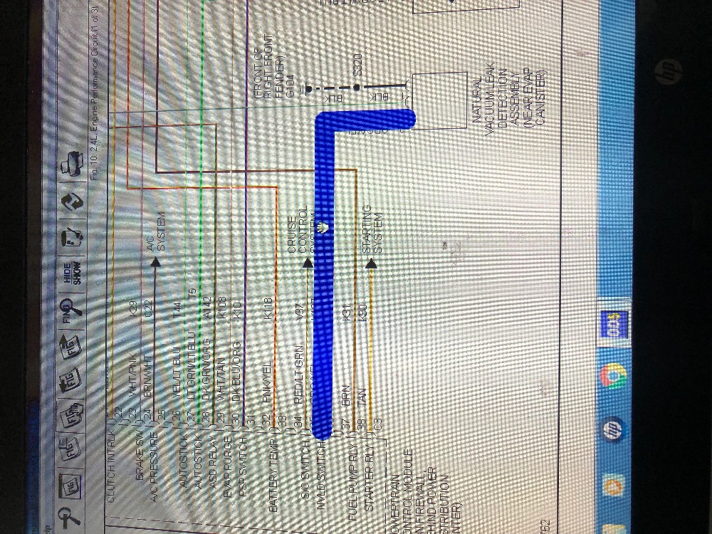

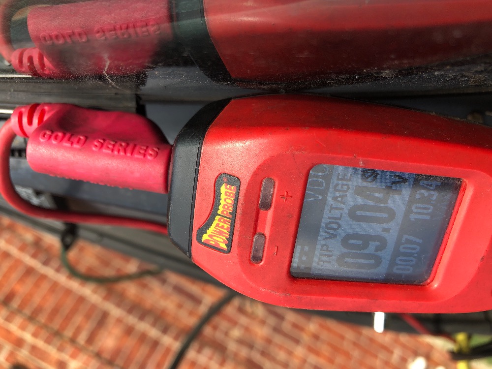

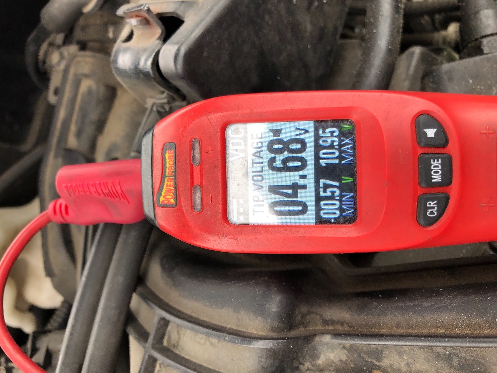

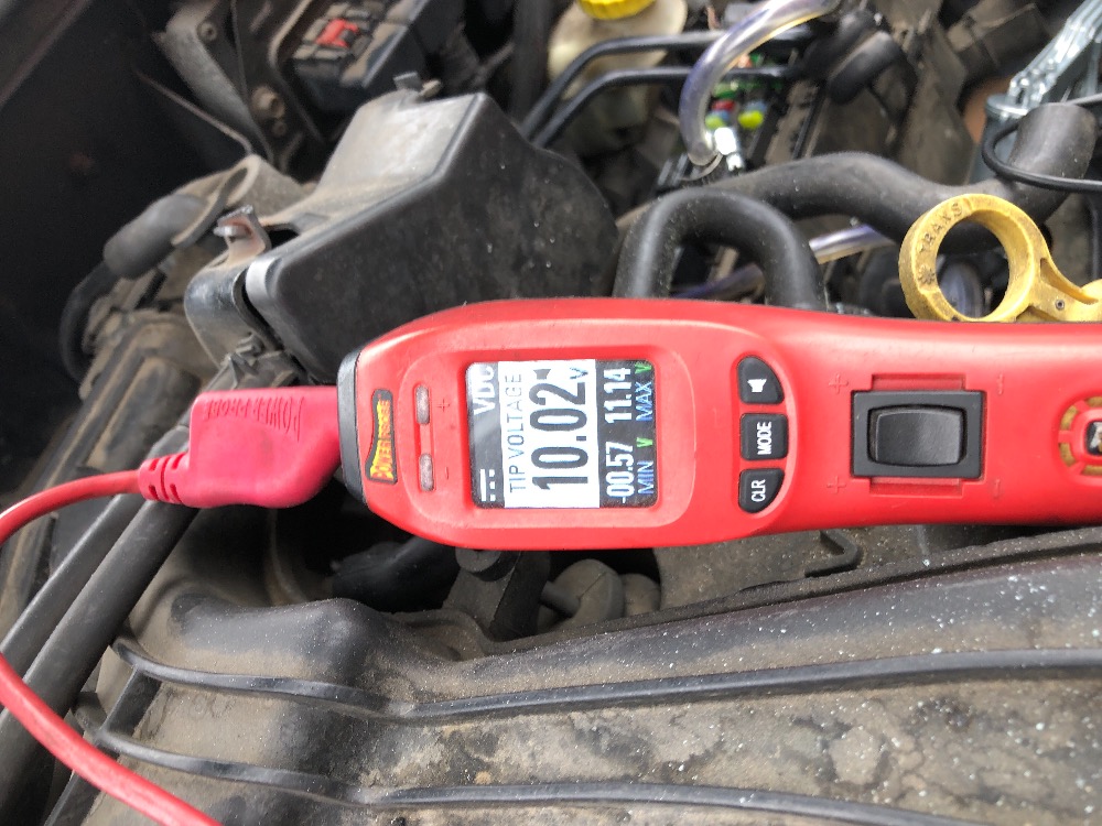

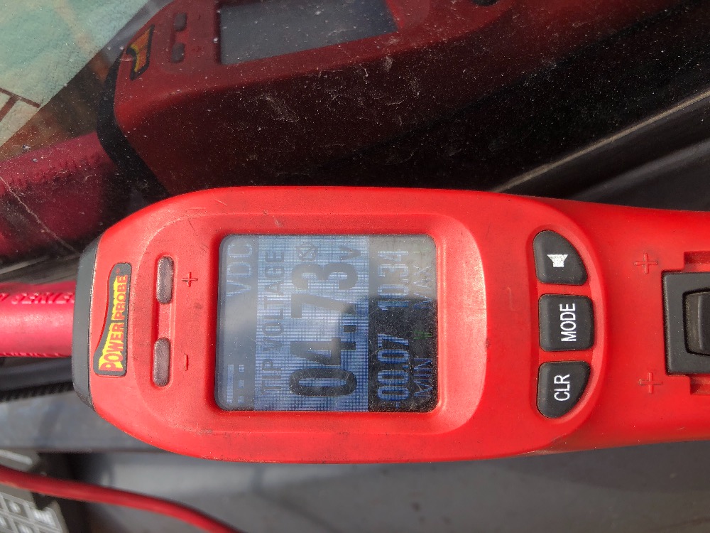

Hello guy. Im working on a 2003 chrysler pt cruiser 2.4 non turbo
And i got code p0441 Incorrect purge
I check Orange/yellow. Wire with the swich off. I got close to 5v
End. Swich on ingot Close to 10v
I tried put vacuum on the canister side puege valve but not hold vacuum .
With the vacuum hoses disconnect If i activate de purge valve with the scaner and blowing air on the canister port of the purge. Just click then release the air that im blowing then close but the scaner still shows that the solenoid still running but its already close wont let me blow air .
Should stay open until i closed. ?
Any suggestions. Thank you

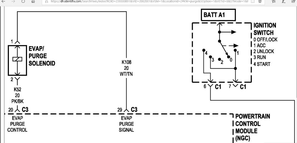

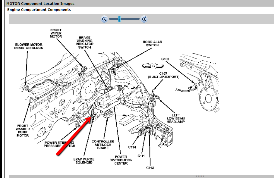

I just saw this, The incorrect flow code is more then likely from a stuck purge control solenoid in the engine bay on the passenger side of the intake manifold Its a two pin connector controlled by the PCM at cruse speed. It should be closed at all times and the PCM energizes the solenoid when it determines it needs to based on other inputs like the fuel tank pressure sensor and such. If you have vacuum flowing at all times thru it replace it its supposed to be closed at all time..
If you have a power probe you can power the PK/BK Wire to make it open. Again it should be closed at all times more then likely stuck wide open it happens a lot on Chrysler vehicles

Unplug the vacuum line that goes back to canister keep the side that goes to vacuum source plugged in. Put vacuum gauge on canister side go into data look for purge duty cycle might have to drive it to get it to purge should see vacuum on gauge when it’s commanding it open. If not most likely a bad solenoid. Or you can bench test it use a power probe hook vacuum pump up should hold vacuum until you apply power and ground to it.

In this test do I testing the purge solenoid or the nvld ?
Because when i activate the purge solenoid with the scanner it clicks. And let me
Release the vacuum. But close its self

Replied by gerber on topic 2003 chrysler pt cruiser 2.4 p0441

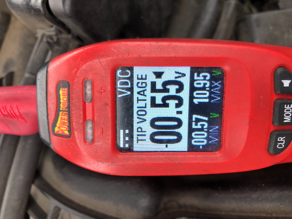

Look this picture please
Swich on close to 5v I apply vacuum and drops to 0.55 Can 0.5 considered no voltage . After start the car. Take like 15 secounds to go to 10v

- rpd1125
- Posts: 88
- Thank you received: 10
6 years 10 months ago #34190
by rpd1125
Replied by rpd1125 on topic 2003 chrysler pt cruiser 2.4 p0441
