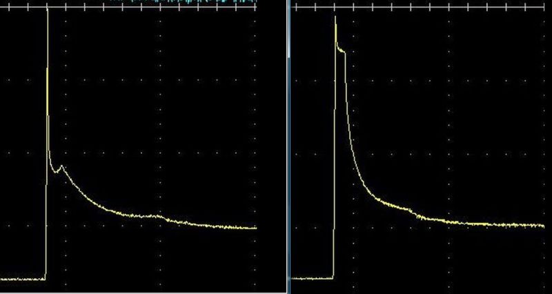

...not the Maserati version, the REAL PLYMOUTH ACCLAIM/3.0L(ref. a scannerdanner video). My 90 year old ma's car with a little over 60,000 miles has developed a very bad bucking/stumble condition. Not sure what all is original on this vehicle, but before going to the usual parts cannon(plugs, wires, cap rotor, etc.)not to mention rigging up a fuel pressure gauge(no Schrader)...decided to make my first attempt into the scope world and tested injectors using the Hantek 1008c(yeah, I'm new). The following capture represents #4 injector on the left, while 1,2,3,5,6 pretty much being the same waveform on the right.

Hi Arby,
Have you noticed any change in rpm once you unplug #4 injector?
Is that change in rpm different from the other injectors?

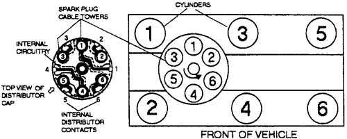

OK(at least testing the front bank)unplugging injectors #2 and #6, no (noticeable) difference/change in RPM, actually no change at all(roughness no better/worse). Unplugging # 4 however...engine dies. Tested twice, same result. Timing issue?

Spark/wire test... I used a test light at the distributor and pulling plug wires at "towers" #4 and #5(individually)caused engine to die before I could even see/hear arc. The others I could see/hear arc with "maybe" some rpm drop??..hard to tell with engine running so roughly...but the engine kept running checking those.

After a long hiatus on this project, I've decided to jump back into it. Some updates since my original post/replies. I had the vehicle running fairly well(though I haven't actually taken it out on the road), turns out a couple spark plug wires got crossed, and I put back some OEM parts that I had replaced with after-market stuff, including the idle air controller. One main addendum to my original post is the waveform posted is from "#3" injector. I have since put in a new fuel tank/pump, fuel lines, brakes(front and back), brake lines, timing belt, water pump, other drive belts. It idles fairly well, but with occasional misfires(?), more pronounce when warm.
However, the posted waveform(for #3 injector) is still valid... I've swapped out that injector 3 times, but the pattern remains the same on injector #3. I ohm tested all injectors, all similar, I ohm tested the control wires from all fuel injectors(connector)to the PCM (connector), all similar. Connector/pins(pcm harness/injector harness) appear OK.
A new issue I recently noticed after changing out the old battery. I am reading 15.2(+/-)at the battery from the alternator. From what I understand, the PCM(guess it's technically called a SBECII for this model/year?)has a alternator field control driver(voltage regulator?)in the pcm, also the injector control driver + ignition coil control. So my question is, is it more likely that a bad pcm driver/etc. is causing this weird injector waveform...or is it still possible it's something else?....same perhaps with the alternator over-voltage? At this point I am considering trying a(compatible)salvage yard pcm(no core/keep old) to see if it corrects these issues(while hoping it doesn't add others)...but I'm open to any other suggestions. Thanks.
