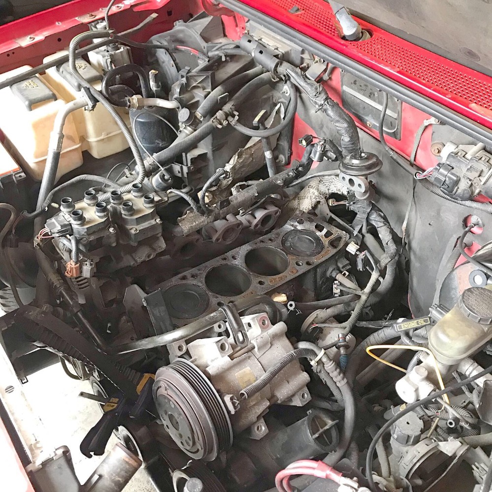

2000 Ford Ranger 2.5L 4 cyl w/ A/T at 260,000 miles.
This issue has already been diagnosed but I wanted to share my experience with a head scratching problem so that others may learn from it.

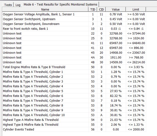

I originally didn't have any codes but there were misfires being detected. It wasn't hitting the code setting criteria so i kept blipping the throttle to get it to a misfire state and finally got P0301, P0302, and P0300 at random times.
Went into mode $06 with misfire count % at
1.28% for 1
0.79% for 2
0% for 3 and 4

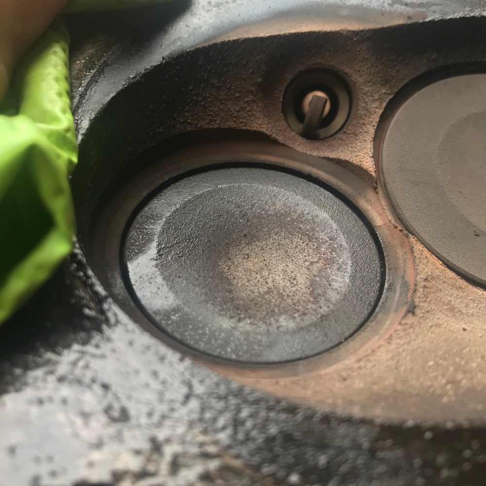

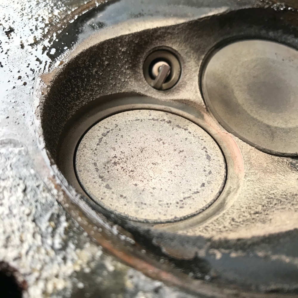

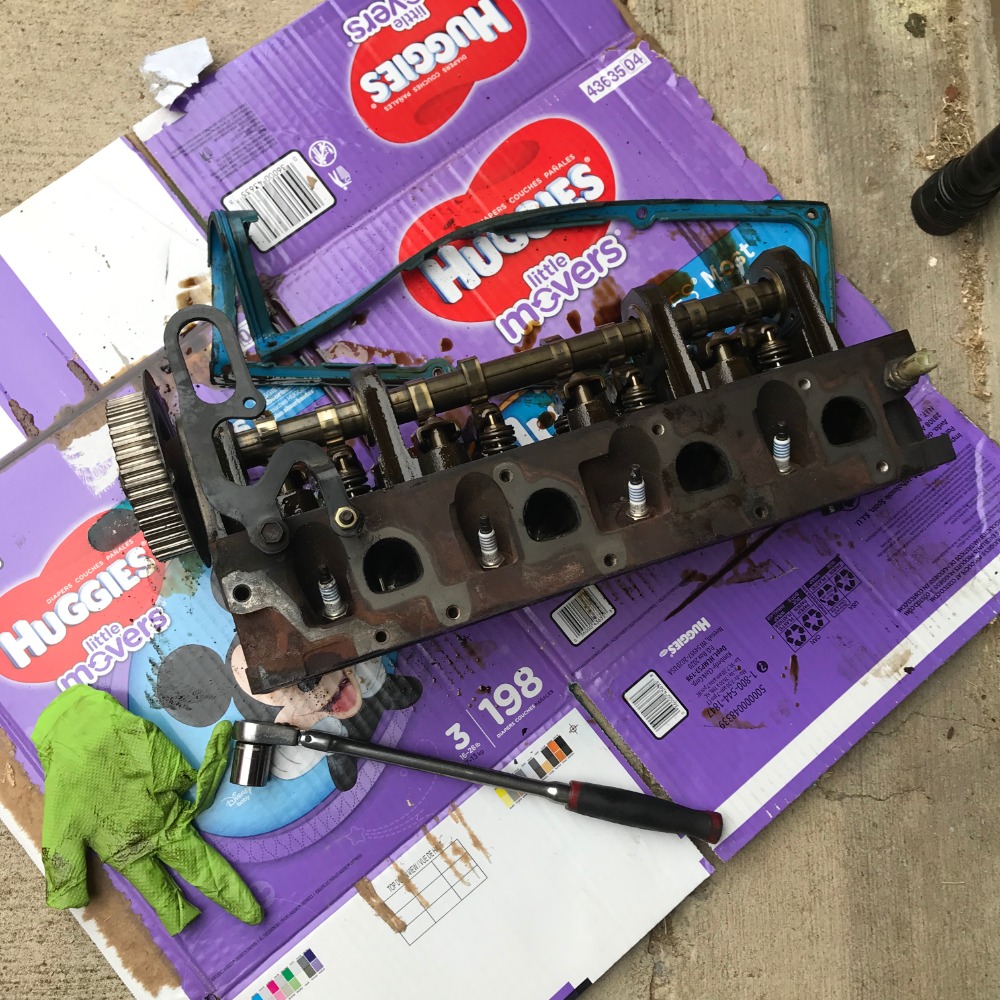

Decided to pull the head this weekend and sure enough 1 and 2 have recessed valve seats, 3 and 4 were good. #1 was sunk in 0.030" and #2 was in 0.020". Goes along with the mode $06 data.

Theory of the failure and root cause analysis:
Truck misfires or stalls due to loss of compression on 1 or more cylinders.
Why? Exhaust valves aren't seating all the way.
Why? Hydraulic lash adjusters have pumped up during high revs.
Why? Valve spring force is less allowing HLA to pump up higher than normal.
Why? Valve height is taller allowing for less valve spring force.
WHy? Valve seats are recessed causing taller valve height.
Why? Valve seat material has worn away from high millage.
Cylinder 1 (Bad 0.030" recession) (maybe small crack in seat as well)
Cylinder 4 (good no recession)
