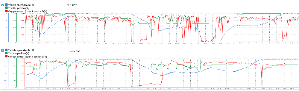

I have been monitoring the down stream O2 at a lot of different conditions, and I notice that it's a very noisy signal, fluctuating between rich and lean at idle at around 1 to 0.5Hz. That right there is a red flag.

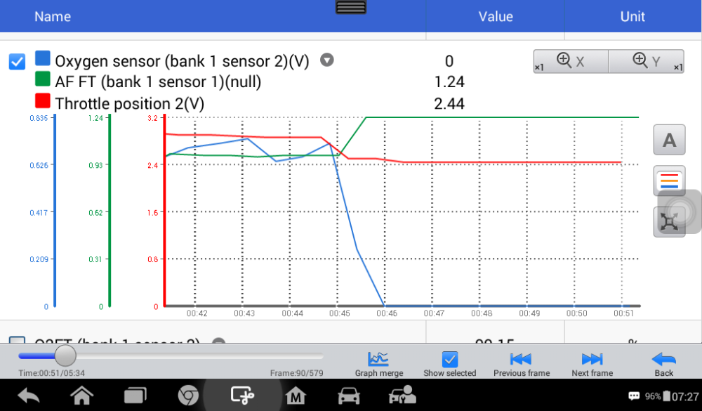

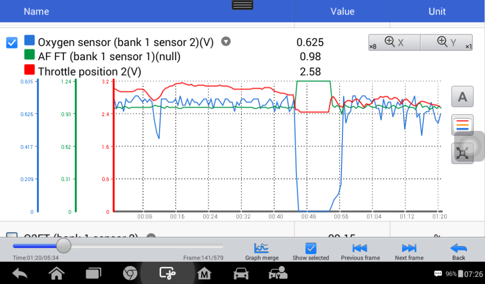

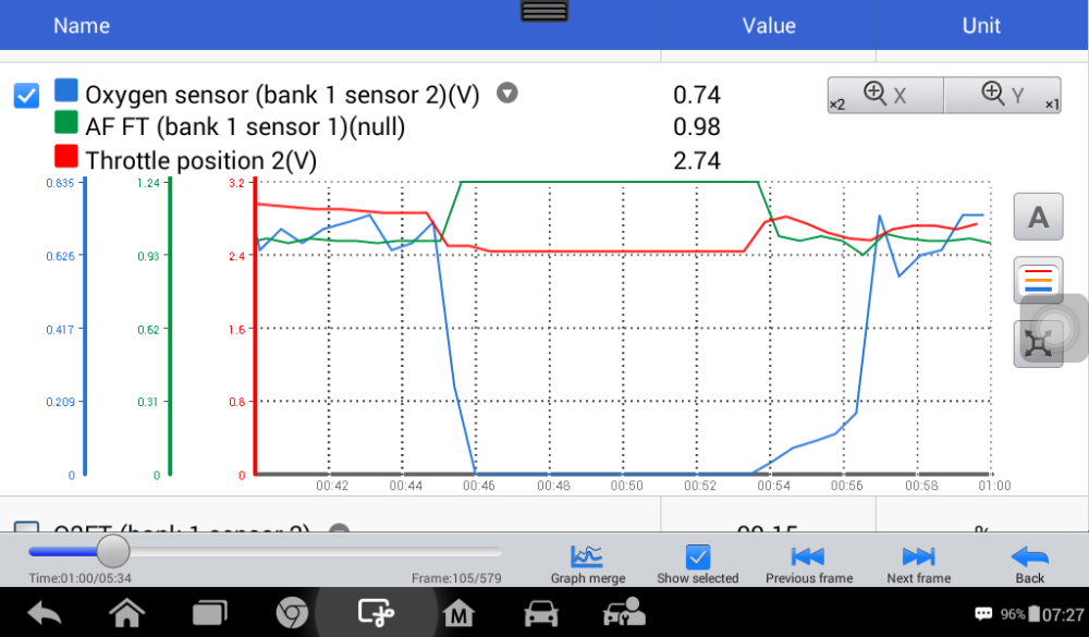

However, I realized that I could probably perform a similar test using the deceleration enlivenment mode. There's a pretty steep hill on the highway I commute on, so I grabbed my scan tool and recorded the data accelerating up the hill to 60mph, and then snapping the throttle closed at the crest. The data is below:
The first image is the zoomed out view of the waveform, and you can see when I lift off, the upstream and down stream go very lean.
The other two zoomed in images of the lift off event show that there is no delay between the upstream A/F sensor, and the down stream O2.

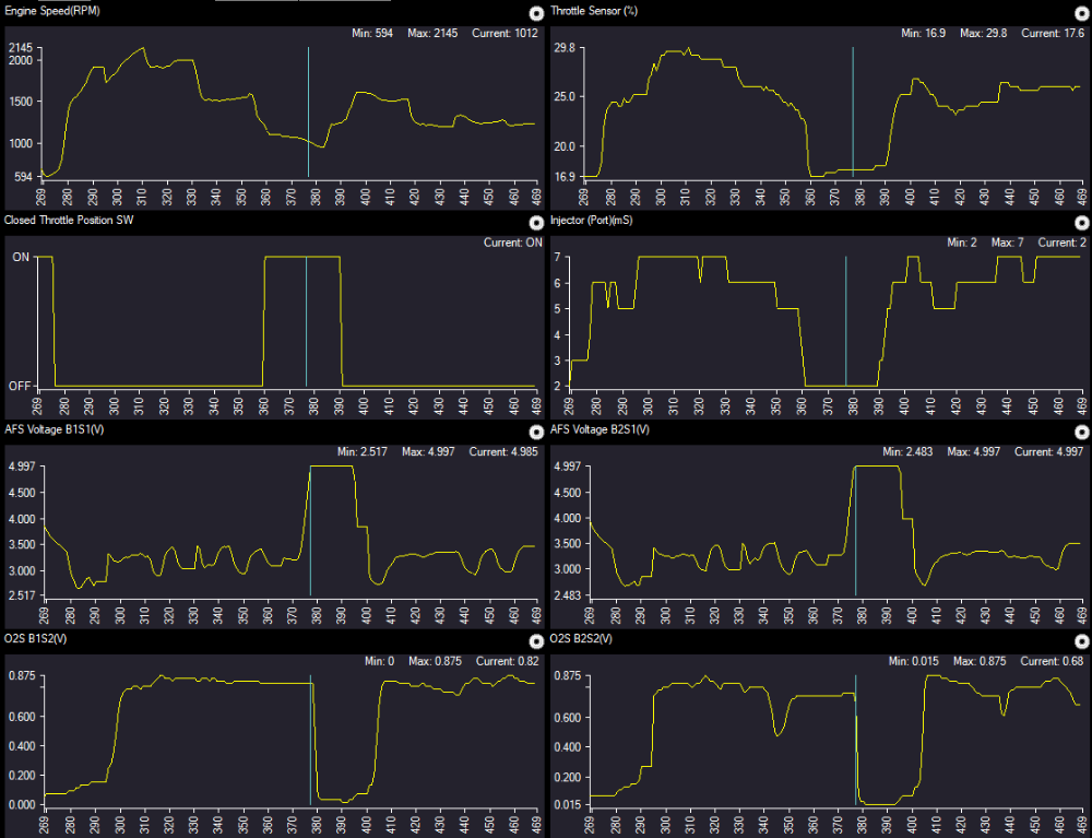

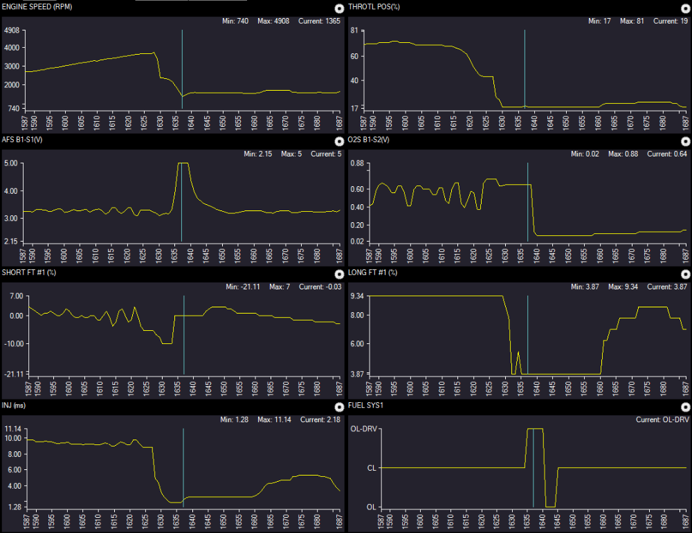

I dug up a couple known good examples from recent vehicles I've looked at. No Camry examples, unfortunately. First one is off a Corolla, second is a 4Runner.
Both are known good, no cat codes. You can see in both that the upstream A/F and the downstream O2 swing lean at pretty much the same time.

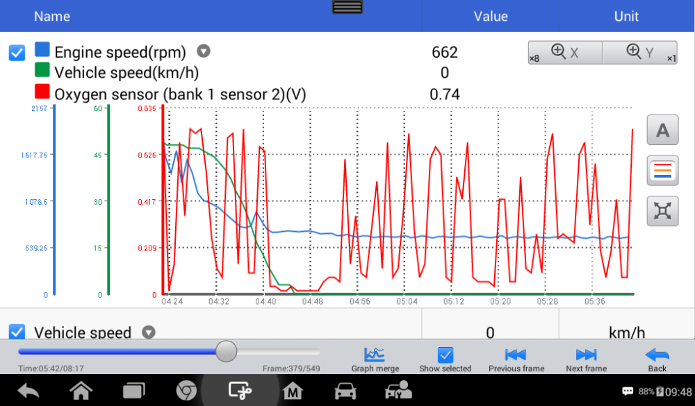

I took one more data screenshot that I think is the nail in the coffin.
This was me coming to a stop and waiting at the world's longest red light.
That rich/lean flux during that long idle is all the evidence I need. Tell Schrodinger that the cat is in fact dead.

6 years 9 months ago #35097 by The_Floss
Just an update:
Finally got around to putting the new cat and gaskets on. Haven't had enough time for the computer to run an efficiency test yet, but looking at the before/after data, I'd say that's a fix.
Thanks again guys. You're the best.
