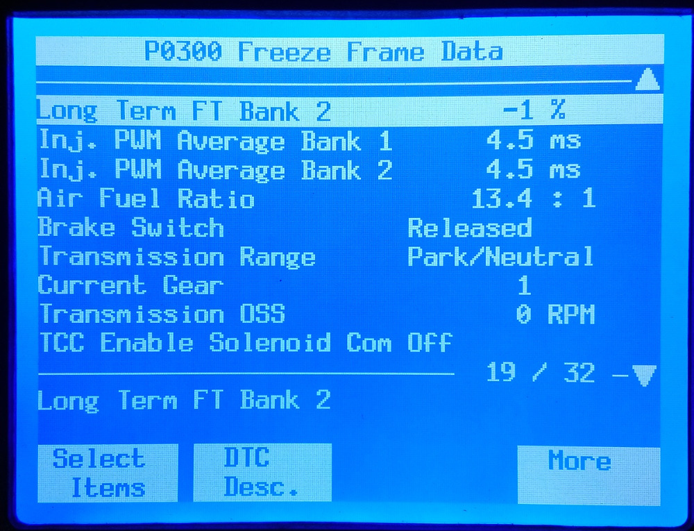

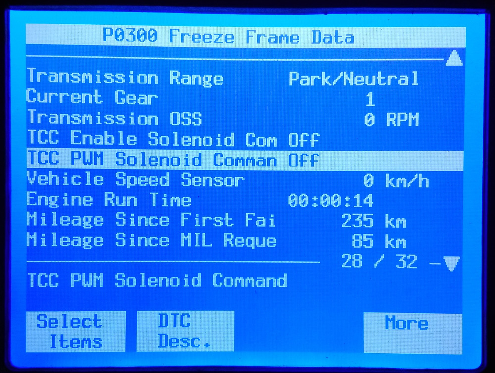

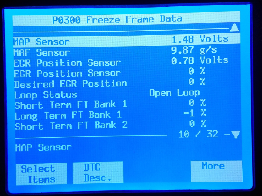

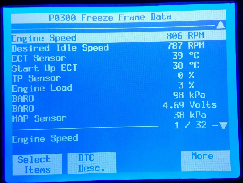

Here are freeze frame data for a typical P0300 occurence. Sometimes the CEL is even flashing, but other times it just lights up. Probably depends on the engine temperature.

6 years 10 months ago #34302 by Tutti57
Replied by Tutti57 on topic One bank misfiring on 2001 Tahoe 5.3 LM7
What are your short and long term fuel trims on bank 1 and 2?

6 years 10 months ago #34317 by VegasJAK
Replied by VegasJAK on topic One bank misfiring on 2001 Tahoe 5.3 LM7
your engine is in open loop... did not see engine temp. provide LTFT for both banks with engine at operating temp and in closed loop. bank specific codes will not be a vacuum leak.

6 years 10 months ago #34339 by JohnnyCZ
Replied by JohnnyCZ on topic One bank misfiring on 2001 Tahoe 5.3 LM7
Tutti57 wrote: What are your short and long term fuel trims on bank 1 and 2?
When in closed loop, they're pretty good - STFT is always around 0% (when idling), LTFT is -1% for bank 1, -2% for bank 2. I may take some live plot of those if desired.

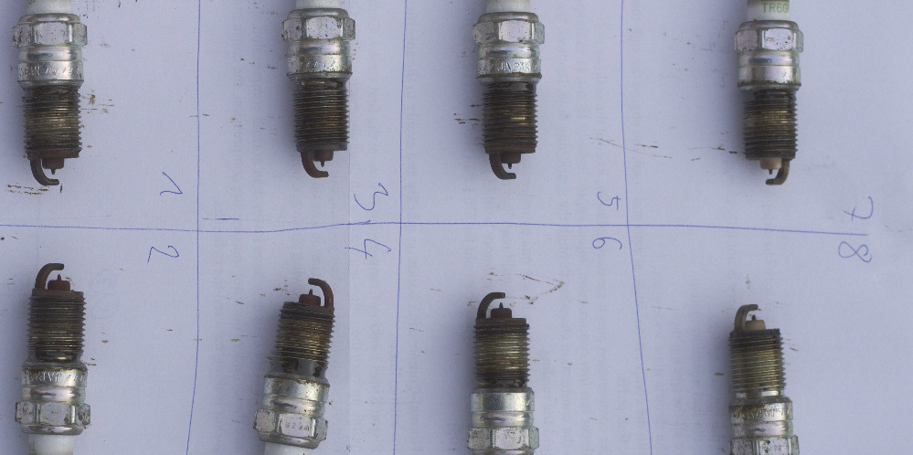

6 years 10 months ago - 6 years 10 months ago #34573 by JohnnyCZ
Here are the spark plugs, not the best pics but I tried my best :-)
Keeep in mind that they're burning LPG (propane), so reddish coloration is normal. From what I can tell, they all look almost identical, except #7 and #8 looking way different, maybe too lean. I know this was common in o'le Chevy SBCs, but with sequential fuel injection in an LS Vortec, it looks a bit strange or at least interesting.

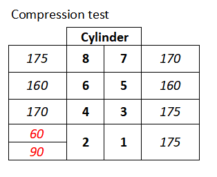

6 years 10 months ago #34599 by JohnnyCZ
Ok, did the compression test and results are bad :-(
The number two numbers are dry / wet.
Considering that the misfires slowly vanish when engine warms up, I'd say there's problem with piston rings on cylinder #2.
Is there other way to confirm the piston rings problem?
  • JohnnyCZ
  • JohnnyCZ's Avatar Topic Author
6 years 10 months ago #34610 by JohnnyCZ
After thinking about it for some time, I will yet test some of the good cylinders in "wet mode" to see how much psi they gain (don't think too much). Then I will also check if the failing cylinder blows by through the crank case and PCV valve subsequently.
Could be also lifter sticking probably, but not sure now.
  • JohnnyCZ
6 years 10 months ago #34676 by JohnnyCZ
Just for the update - I filled the cylinder #2 with compressed air (closed valves) and it noticeably leaked into intake. There was audible hiss from the airbox. It's a time for cylinder head service.
