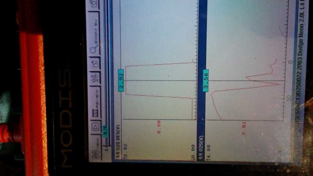

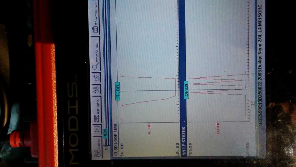

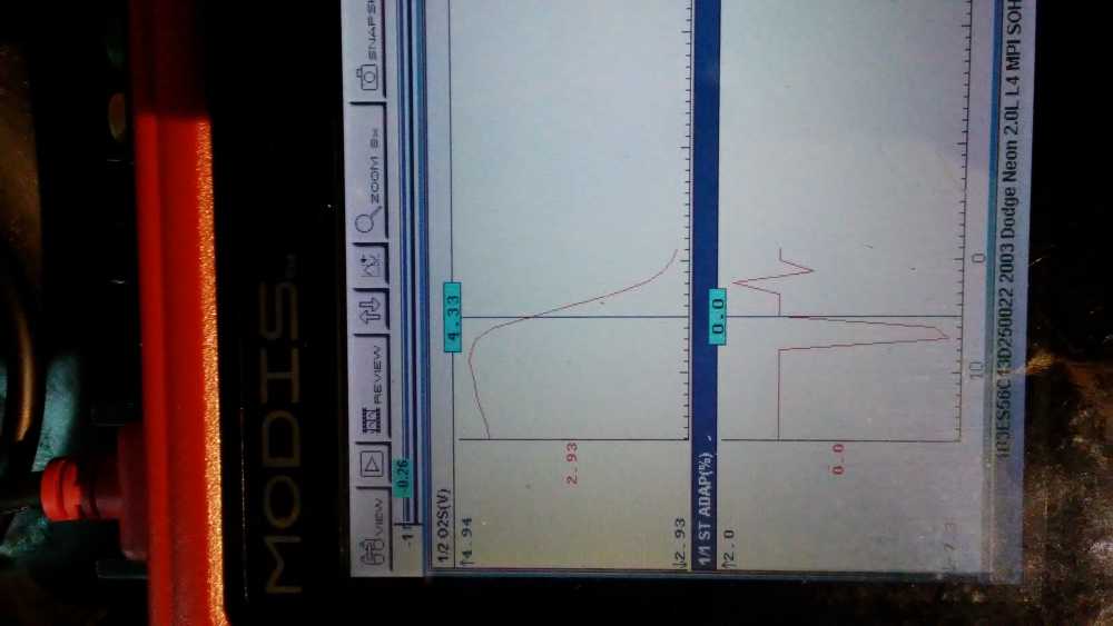

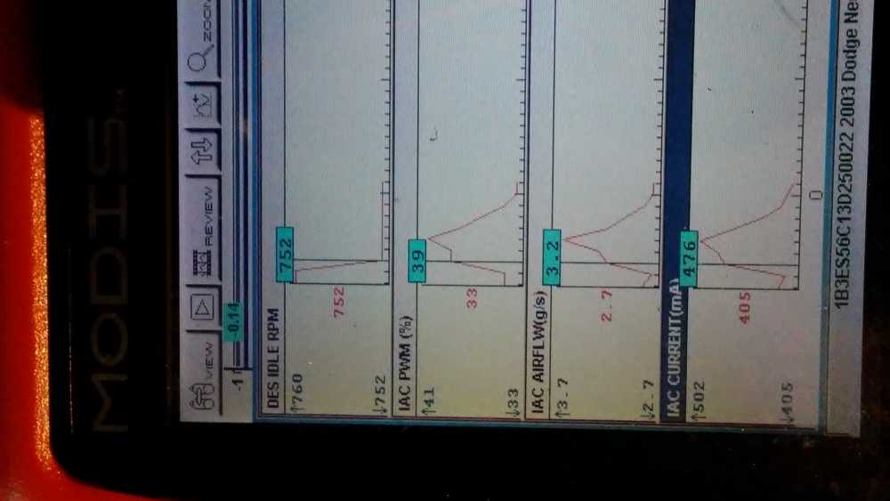

9 years 9 months ago #4752 by 350boatracing
Replied by 350boatracing on topic 03 Neon sxt 2.0 sohc automatic p0171

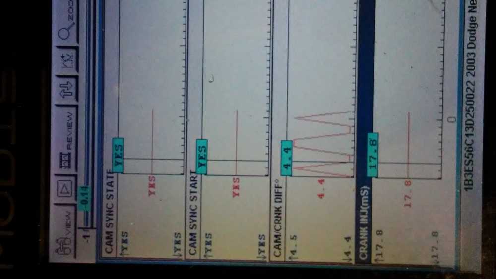

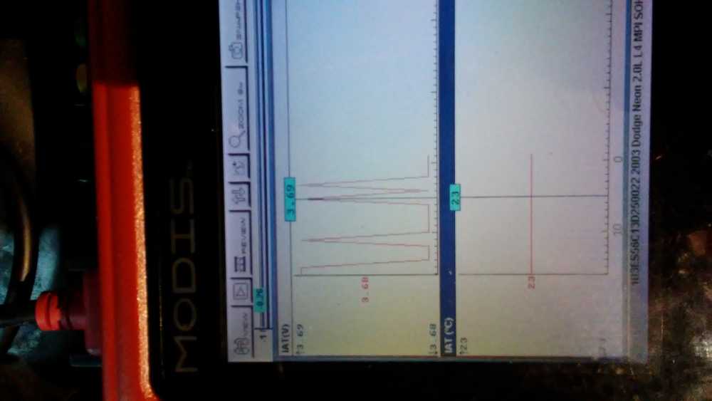

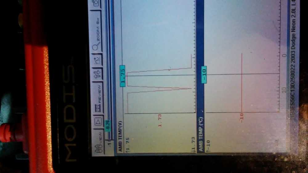

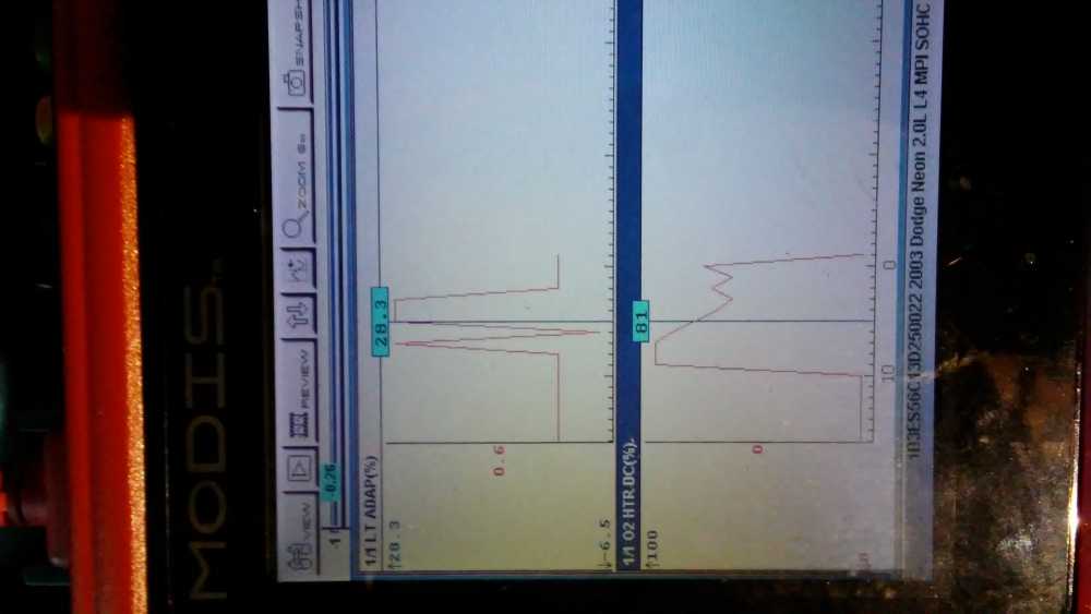

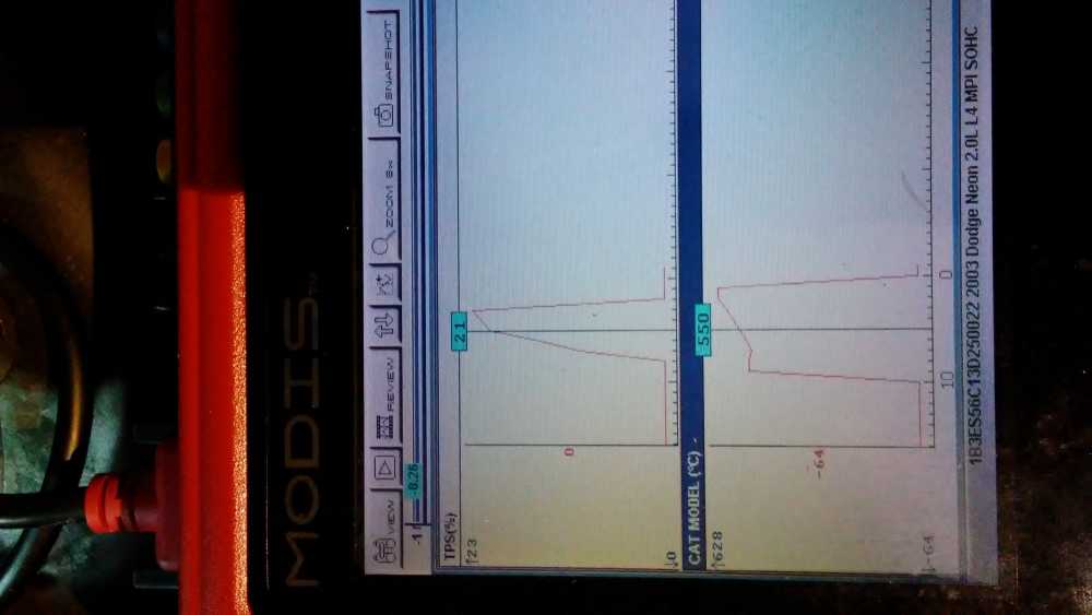

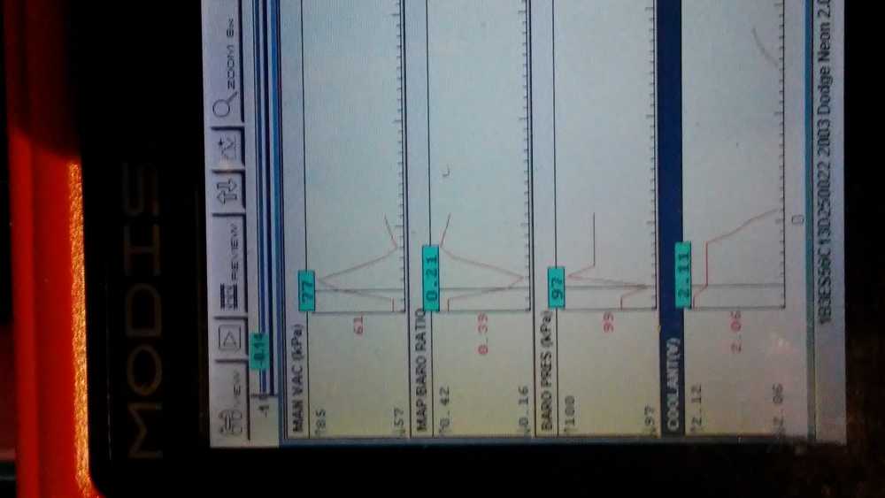

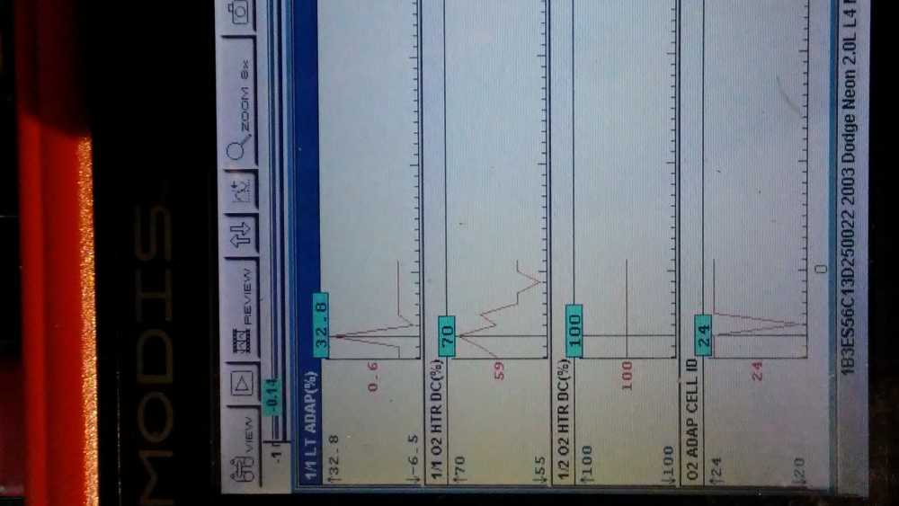

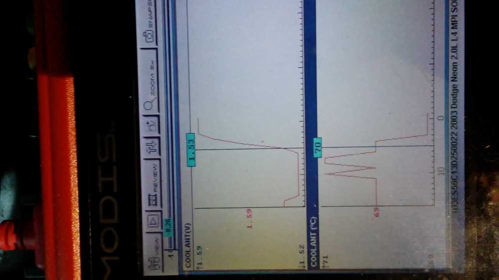

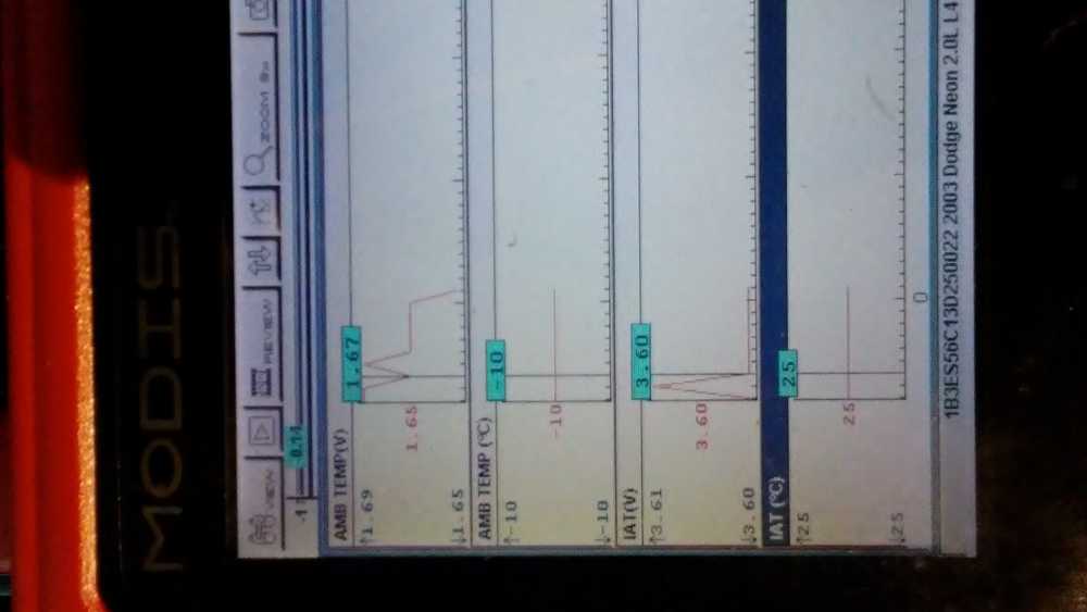

I didn't get a chance to check the fuel pressure again but I have pictures of the graphs for WOT and a snap throttle. They are a little blurry but most are still readable. I'm new to reading and understanding how the signals work together from all the sensors so if anyone would mind taking a look and seeing if there is anything obvious that is wrong I would appreciate it. One thing I noticed is that the iat temp was like 74 degrees fahrenheit and it was about 14 degrees fahrenheit so I'm thinking it's because of the engine heat.

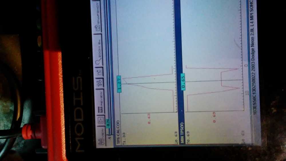

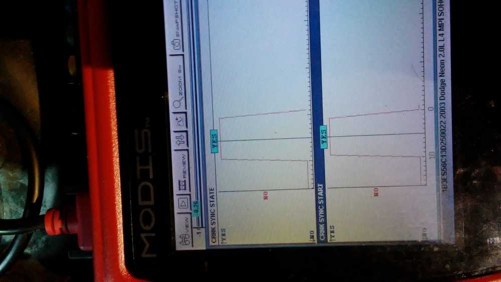

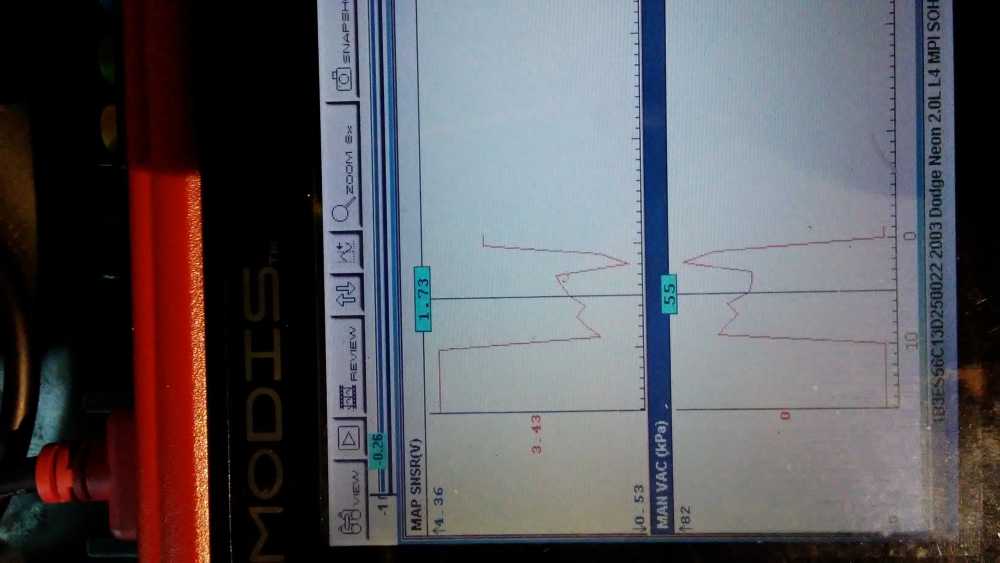

9 years 9 months ago #4753 by 350boatracing
now for WOT

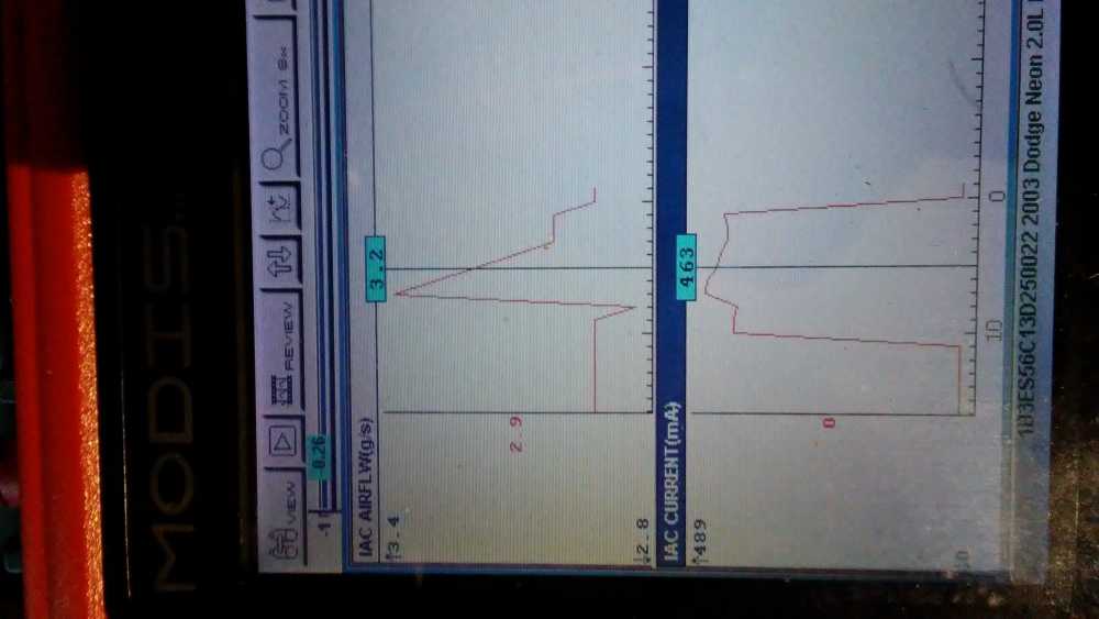

  • 350boatracing

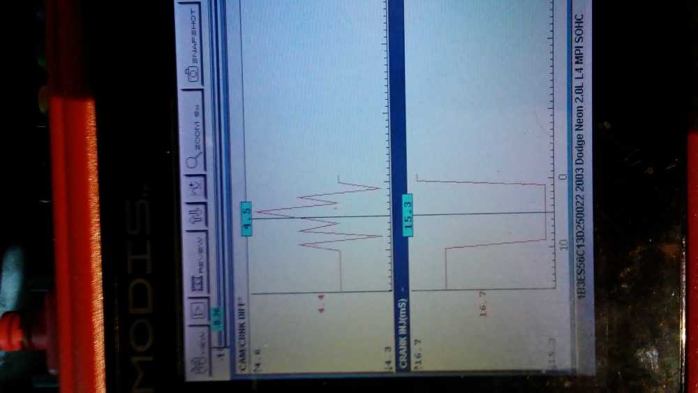

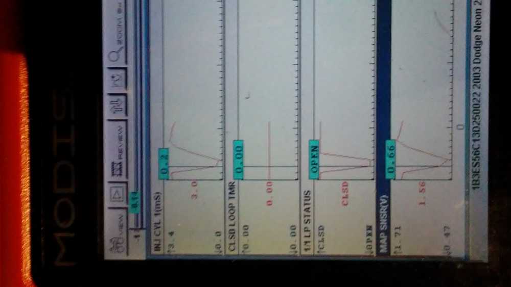

9 years 9 months ago #4754 by 350boatracing

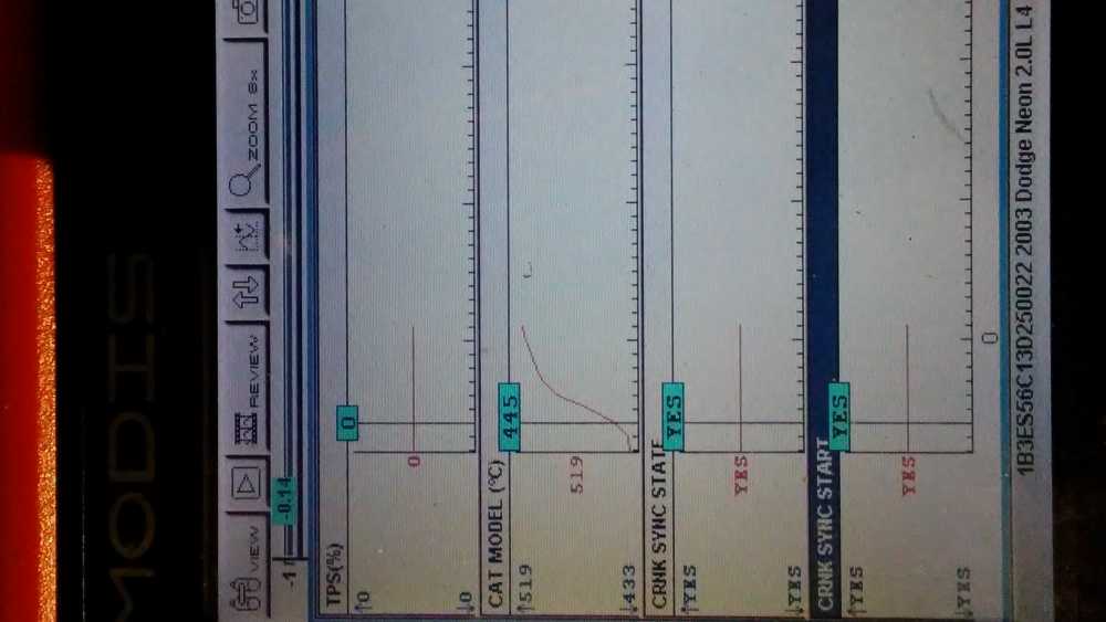

WOT contd...
  • 350boatracing

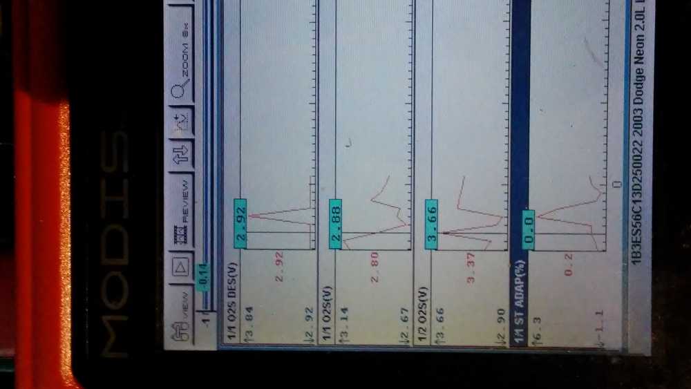

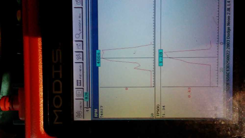

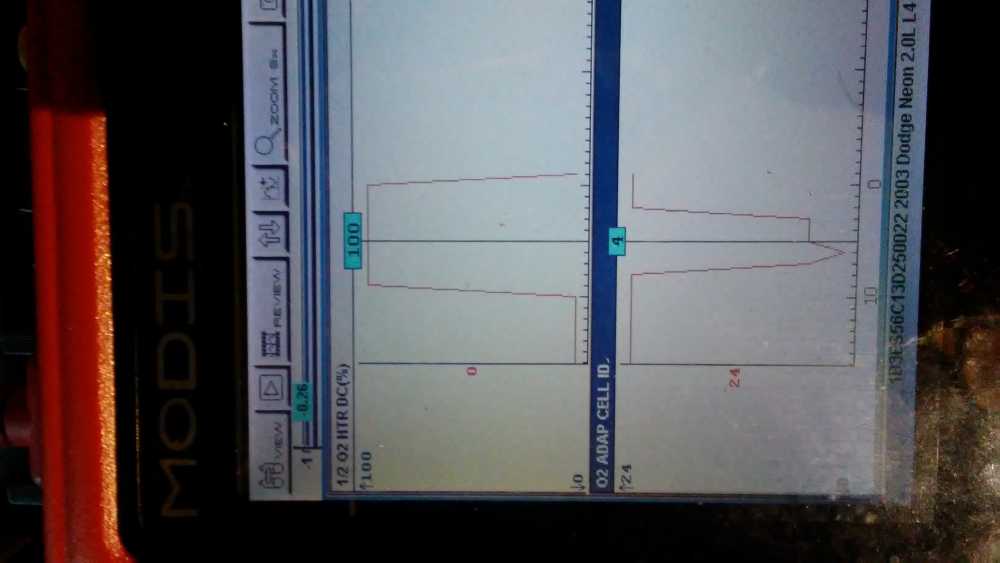

  • 350boatracing's Avatar Topic Author

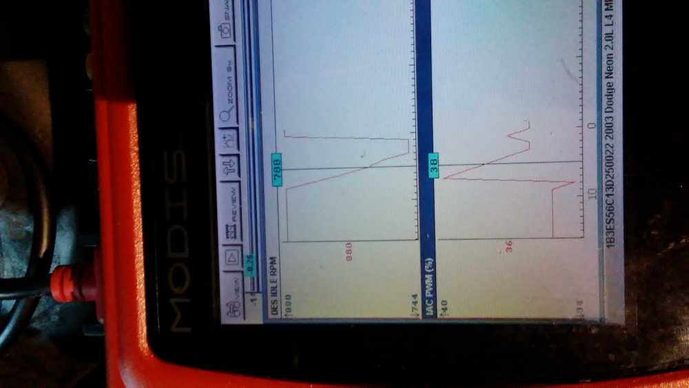

9 years 9 months ago #4755 by 350boatracing
one last WOT pic
9 years 9 months ago #4757 by matt.white
Replied by matt.white on topic 03 Neon sxt 2.0 sohc automatic p0171
In the second set of pictures, am I seeing 23% throttle at WOT? Maybe nothing or maybe my eyesight. Just looks like it to me. Seemed odd.
9 years 9 months ago #4759 by Tyler
Replied by Tyler on topic 03 Neon sxt 2.0 sohc automatic p0171
Yeah, I see the TPS and MAP low, not sure if the scanner caught the WOT snap or not. The data bus rate may be too slow to show the kind of detail you're looking for.
I also saw the long term trims go to 32% in the first set of pictures, BUT that was during open loop operation. I do like that the O2 signal isn't pegged lean, at least while you were testing it. Could be going dead at other times :unsure:
If you're willing, maybe try taking another capture? Narrow down your PIDs to engine speed, MAP voltage, both O2's, TPS voltage, and loop status. Wind out first and second gears at WOT. Highway on-ramps are great for this.
Then, save the file on your Modis. That way, you can use ShopStream Connect to easily review the data later, OR send it to us! Most members around here that have a Snap-On scanner also use ShopStream to manage data captures like this.
