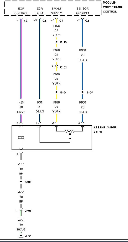

I have a 2009 Dodge Journey R/T with V6 3.5L. I was getting error codes for egr valve and #1 fuel injector. Replaced with new egr valve and all 6 fuel injectors. Still getting error code P1404. I'm getting a surge feeling while driving at cruise. Ping sound from engine. Any help would be great. Thanks

The rationality is monitored any time the engine is running. The code sets when the EGR position sensor reports a position that the PCM is not expecting for two consecutive drive cycles. Codes can be cleared by disconnecting the battery cables from the battery, and touching them together for a few seconds.
Since you have, already, replaced the EGR valve, the problem is likely a wiring problem. Verify the integrity of all the wires involved in the diagram. Check for 5 volts on PIN 2. Check for good ground on PINS 3 & 4. Pin 6 is a Pulse Width Modulated (PWM), power side switched control. Pin 1 is the position signal. It will vary between 4.5v and 0.5v, depending on valve position.

The code setting criteria, also, refers to EGR flow. It my be worth while to check and make sure that the EGR passage ON THE INTAKE MANIFOLD SIDE of the valve is not clogged.

P1404 is an error code you get when the PCM detects high voltage on the closed position sensor for the EGR. High voltage can indicate a short in that circuit. You replaced the EGR but may still have a wiring or sensor problem.
The driving conditions you mention can mimic an open EGR, but the PCM may be running the engine lean based on the high voltage reading (P1404).
What code did you get for that #1 injector.
Clear all codes using your code reader or scan tool... or disconnect the neg battery cable for 5min. Re Scan for codes.
What are your fuel trims for both banks with engine at operating temp and O2's in closed loop.
What codes are you getting after the reset?
