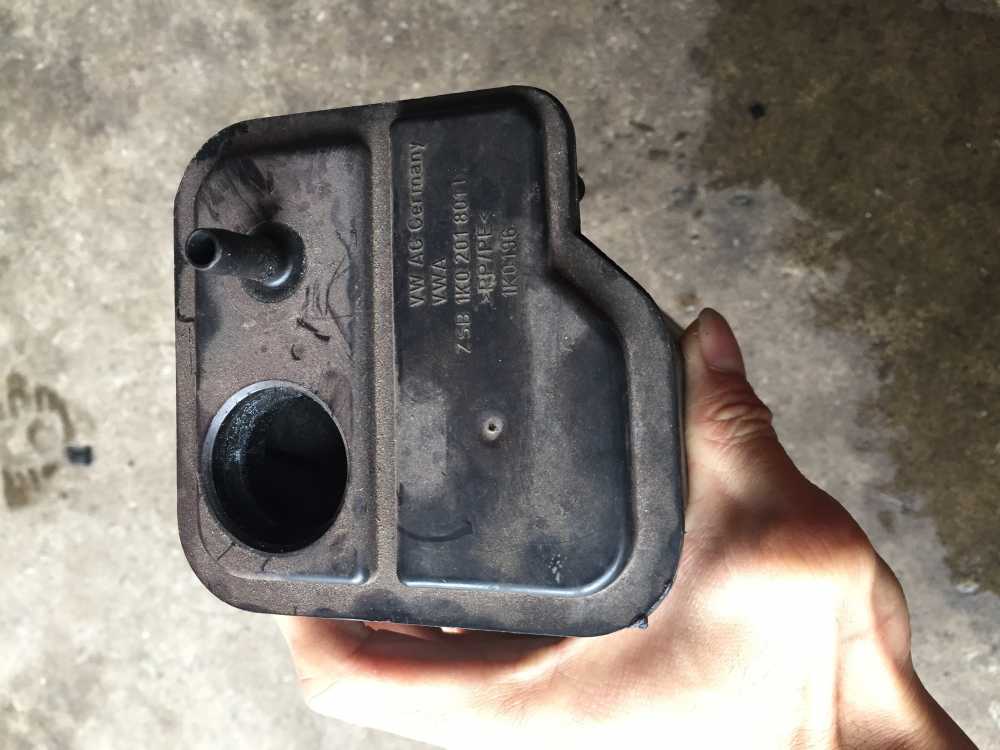

hi,guys,looks like the purge solenoid and computer are not the issue here,so i tried to change the charcoal canister.
when i removed the canister i can hear the sound of the canister when i shake it,it sounds like the hand shaker musical instrument.
i ordered a genuine brand new and i did the same way,it doesn't sound like the old one.
so this give me a bit more confidence to put it into the car.
i brought it for few test drive,so far so good.no trouble codes so far.
but can someone explain this,why the computer trigger these 2 codes "IF" canister was really the cause?
thanks guys

Codes description doesn't look like it was set by a faulty charcoal canister. :dry:

Wonder what the code set criteria for this code is. :huh: Anyway, good move by scoping the purge before replacing it!
I've never worked on a TT, but I have seen other makes/models set purge codes due to EVAP leaks or faulty pressure sensors. In those cases, the PCM was commanding canister purge, and wasn't seeing a corresponding change in fuel tank pressure. It's silly fault detection logic, but that's how some are ;)
