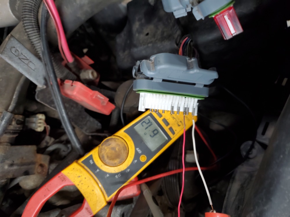

Hi all, new here but not a new auto tech. Just acquired a 2003 LB7 duramax that has a communication problem on the J1939 circuit. Previos owner had Dealership already replaced/reflashed TCM, checked trans harness, replaced Neutral safety switch and connectors, replaced ignition switch.
I have checked pins/plugs at the ficm and Tcm. I ohmed the can bus with batteries disconnected and modules asleep and got this:
  • Autolodge
  • Autolodge's Avatar Topic Author
6 years 10 months ago #34738 by Autolodge
Replied by Autolodge on topic 2003 LB7 duramax u2104 u2105
With the ficm unplugged

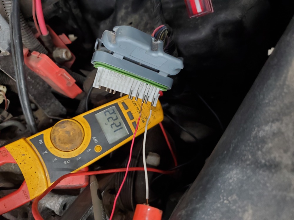

6 years 10 months ago #34739 by Autolodge
I got this
With the ficm plugged in so it looks like the resistors in the ecm and the ficm are good. What next?
