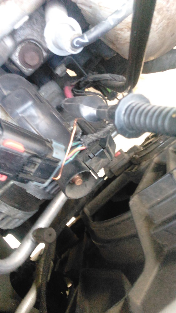

Hello,
I have been jumping the gun and thus far purchased two EGR valves. And it basically means I bought two too many.
I have what is called signal integrity problem I think that is the term.
I have P403 and P406, (on 2005 Chrysler town and country 3.3 liters). and it will not go away. The first EGR valve I bought and installed it the check engine light went off for a couple of months and then returned. The new one I bought, well this one the check engine light went away for a day.
So, in a nutshell, I have finally learned enough to do first things first. I jumped/shorted the signal wire to its ground to see if it would change or reset the code. Nothing, absolutely nothing. I have got the same codes. I did it over and over just in case the first time I didn't do a good job.
In fact, it seems the codes are there even after I cleared it with my latest gadget, The Blue Driver.
All other things seem to work, When I applied voltage 12V from the battery to the EGR control valve the signal wire drops to 0.2 volts. Otherwise, it read close to 5 volts when I turn the ignition on and engine not running. The reference pink/yellow reads 5 V.
The rig runs fine so I assume the valve is in the closed position, that much I can conclude.
By the way, I still have the previous EGR valve I bought and I tested it, by supply power to the control wire (#6) and grounded the black wire and the valve opens no problem which I didn't know before how that worked as nobody had told me about it straight forward.
How do I go about fixing signal integrity? Could it mean I have bad sensor ground wire in my case or? Can I ground the sensor wire to the battery/body and if that works, would that mean I have that sensor ground not working or?
Thanks in advance for your help.
And I forgot to check mark the email notification button here. if/when I get a reply.
Last edit: 6 years 11 months ago by EventAlchemy. Reason: Fix some typing errors and I forgot to check the email. notification button.

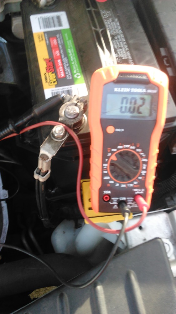

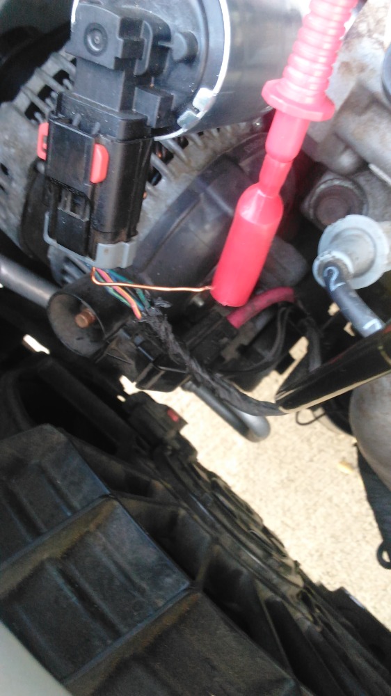

Well, today earlier this is what I managed.
With the ignition on, car not running I unhooked the harness from the EGR valve and checked the sensor voltage by probing it there (1 terminal) and at the other end hooking my meter at the negative terminal of the battery. I tell you I didn't read a doggone thing. Then I hooked up my meter to the 5 volts (#2 terminal) and the negative battery, something went clicking somewhere which I never heard before. So I didn't like the sound of that and I stopped. I did not want to test the negative (#3 terminal) to the positive side of the battery. I stopped.
I plugged the harness in the EGR valve and I started the van. I read the codes again. What did I find, another extra code appeared P0129. Yea three codes. Grrreeeaat.
So I decided to just delete the codes and after several attempts, something did happen. I managed to erase all the codes, unlike yesterday which I wasn't able to erase the EGR codes whatsoever. Now I managed to clear those plus the new strange barometric mass airflow business. I don't know.
So what did I do next?
Well, I decided to check the sensor ground and the sensor with the engine running. I hooked up to the sensor ground by taking copper wire and make an "L" out of it, pushed into the harness, hooked up one terminal of my meter into it and the other end of the meter to the positive terminal of the battery. It read almost 14 volts.
I did the same with the sensor, except I hooked the other end of my meter to the negative side of the battery, I read 0.02 volts.
At present time the van is running fine as before and no codes came back. That is where things are at the present moment.

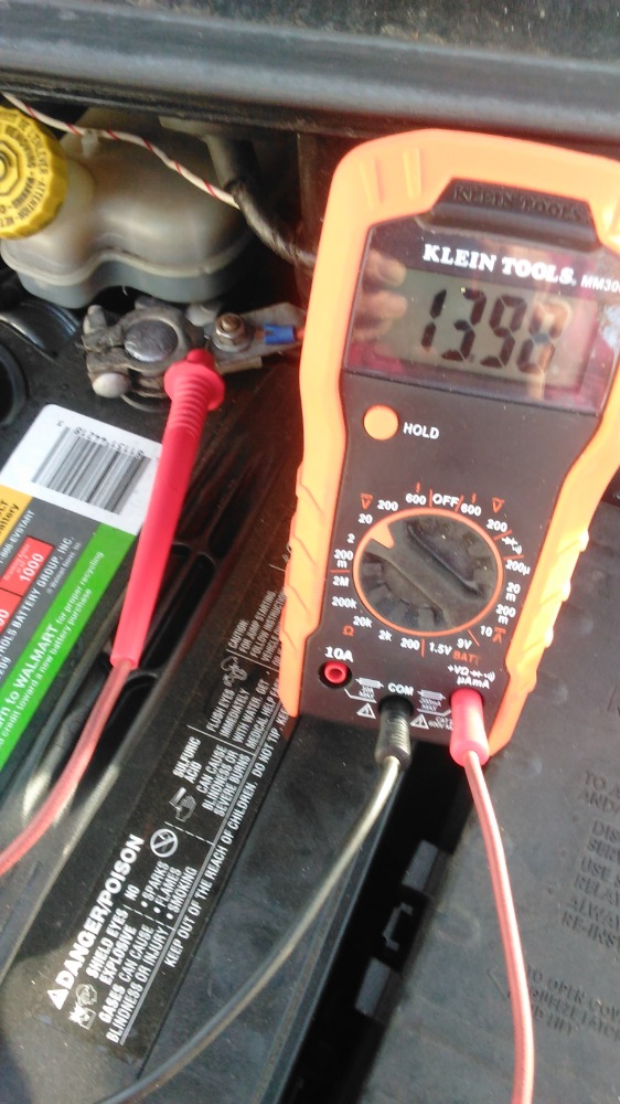

6 years 11 months ago #34855 by VegasJAK
The reason for the 13.xx volts when you checked the ground wire was because you were hooked to the battery positive. With the engine running you should expect that voltage. It would be the same as if you were hooked to battery positive and touched any ground while hooked up to the DVOM. It did prove that you have a ground.
The fact that you set off a MAP error code maybe related to your problem. The 5v bias is common to the EGR, MAP, AC pressure sensor, cam&crank sensors and throttle position sensor. Why you did not get codes for those sensors suggests to me that the MAP sensor circuit maybe part of the problem.
Unplug the MAP and test the 5v wire on the EGR harness again with the key on engine off... additionally, there is a second sensor wire on the EGR circuit, its the Dk Blu/Vio wire.

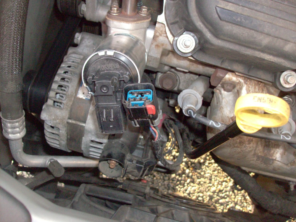

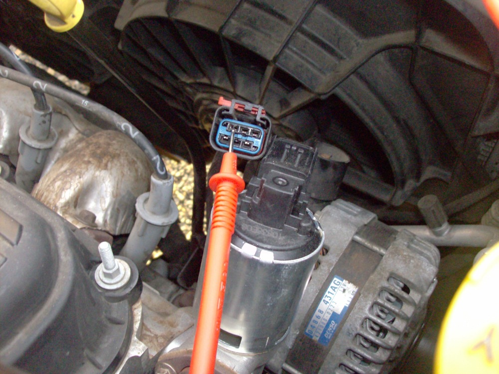

6 years 11 months ago - 6 years 11 months ago #34857 by EventAlchemy
Okay, just got done checking things.
This is going to be confusing. At least I am. The reading is different. Don't know what to say so here I go.
The ignition on, car not running, harness plugged in.
Pin1. 0.1 volts. Top right ( sensor?)
Pin 2. 5 volts. . Top middle ( supply?)
Pin3. 12 volts when hooked to the positive battery. Top left ( sensor ground?)
Pin4. 12 volts. hooked to the positive terminal of the battery. bottom left under the pin3, ( main ground wire?)
Pin5. empty
Pin6. 0-volt bottom right, under pin1 ( control wire?).
With harness unplugged. Key on. What you see below I have done them at least 3 times if not more.
Pin 1. 0.01 volts when I hooked to the negative terminals of the battery. 12.20v to the positive battery.
Pin2. 5 volts.
Pin3. 6.7V to the positive and 4.55v to the negative battery terminal.
Pin4. 12v to the positive battery. ( bottom left under pin3). 0v to the negative of the battery
Pin5 empty
Pin6. 11.3 v to the positive battery ( bottom right under pin1). 0v to the negative of the battery)
Both two bottom pins read voltages when hooked to positive terminals of the battery. That is not a typo.
Is the rig still running fine? Oh, that third code was back on P0129 just because it wanted to.
I should go and see if I can erase the codes again. I will be back.
Okay, I was able to clear all the codes and the P0129 wasn't part of it. The 203 and 206 only, I cleared them.
So how is that for the confusion. At least it looks to me.
Oh mercy.
I edited this to include a couple of pictures. I want to make sure I have my pins in the right order. In the picture pointing to pin1 using that probe. So 1 is on the left side of the top row. In the second picture, it would be top right side above that orange locking tab
Last edit: 6 years 11 months ago by EventAlchemy. Reason: Wanted to add a couple of pictures

The correct sequence of pins:
What I am pointing at with my probe is pin 3 ( sensor ground). Pin1 is on the first right. Got it.
Pin2, that one naturally can not get swapped ( only because the star of the show is in the middle. It can't go anywhere else :-) )
Pin4 (main ground), that is under the pin1.
The pin 6 ( control wire) is under the pin 3.
All this time I have had my pins scattered all over the planet.

Okay, here it is as you suggested:
1. With the engine running, when I put 12V from the battery to terminal 6 the rig would die in before I even had any chance to see the voltage on pin1 as how to how much or quickly and to what lower voltage it would reach. Sensor wire didn't have a chance to stabilize in any meaningful way.
2. Both ground terminals pin3 and pin4 were nice and bright on the test light and 14.20V on the meter.
3. The sensor is at 4.54V plugged or unplugged either way.
I did something stupid but thank goodness it didn't cause any serious problem.
I read that you said to put power to pin6 with the engine running. That is one thing. But then the stupid inside of me put power to pin6 when the engine wasn't running. I could tell something didn't feel right.
In a bit, I was checking the sensor 1 and it was reading fluctuating 4.5 to 7.50 volts only to realize that it was worse, with the ignition switch off, that is.
Well, I checked the codes and it had thrown P0688.
Long story short, the code has disappeared and the rig runs fine.
End result I am left with only P0406 with 4.54V, regardless if it is plugged or not or if the engine running. For some reason, that number seems rather repetitive throughout. The little guy is stuck on volt and can't get out of it. while everything else seems normal even though they all got jerked around by the novice here. There is no justice.
Follow up:
I don't remember if I have done this before. I went ahead and checked power (pin2) to sensor ground (pin3) and also the main ground (pin4). They read 4.9V, with the ignition on and plugged in. I also checked the sensor to main ground pin4, it is at you guessed it 4.54V.
I did not want to touch pin1 to pin3 just because. I don't want to set any funny codes.
