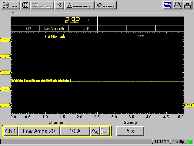

Hi all,
Was doing some testing and noticed that when using an amp clamp on my battery cables (negative or positive) I get a very erratic graph. I checked another car and I get a nice flat line with it just sitting there key on engine off.
Key off I get a nice solid line on the Hyundai, it's only when the key is switched on that I see this.
Anyone know what could cause this? Vehicle is a 2007 Hyundai Santa Fe.
Image in case attached doesn't work i.imgur.com/8NzDlDZ.jpg
Thanks!
6 years 11 months ago #34810 by Cheryl
Replied by Cheryl on topic Amp clamp key-on erratic graph
Weird. Guess you could try pulling fuses until it goes away then see what the fuse feeds if you really wanted to. If it’s not killing the battery and it was my car I wouldn’t worry about it

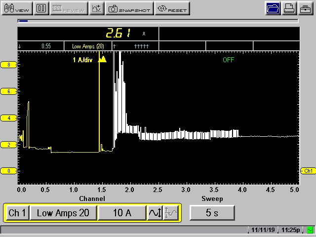

Attached a photo of the key-on with the cluster fuse removed. There is no noise after the event whereas with the fuse in you will get some noise every few seconds until about 20 seconds in then it goes to a flat graph.
Cluster itself is currently disconnected which leaves the BCM and semi-active engine mounting module in that circuit. BCM was disconnected with no effect on amp draw but have not removed the panels to get to the semi-active engine mounting module yet.
Is the noise with the cluster fuse connected that goes away after about 20 seconds normal or should I continue investigating on that circuit then retry connecting the alternator if I find the cause? Or does this look like a bad alternator?
