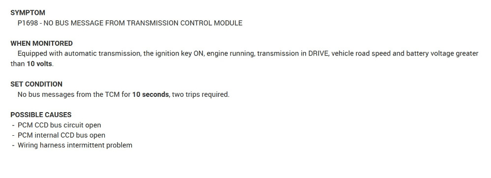

changed speed sensors , shift solenoid ,transmission computer ...still in limp mode with all gear indicator lights on checked power and grounds to tcm . doesn't seem to be turning on trans relay
Last edit: 6 years 11 months ago by jetter3606.
6 years 11 months ago #34897 by Chad
This is a comunication fault, between the PCM and TCM. Check for wire integrity between the two.

I checked continuity between the pcm and tcm on the white black and violet tan wires and it was good, Started truck and got a voltage reading of 2.5 vdc on each wire .. its suppossed to be 4.7 .. im not sure what the next step is in finding the low voltage issue . the wires go from the tcm into the wiring bundle going down firewall and return at the pcm

I dont have a DRBIII scanner I did check the ABS connector and had the same 2.5 volts on the pins with the white black and violet tan wires . does this mean I need a new PCM or is there another way to verify the PCM with a volt meter or obII scanner . I noticed a P1687 code that just popped up also but I assume thats from my testing I did . not sure
6 years 11 months ago #34934 by Cheryl
Step 4 in the chart is really the determining step to determine if the ccd bus is messed up. You could possibly use a voltmeter on the pci bus wire but you won’t see detail like you would with a scope. Then again you could do it in 2 places again and compare what you get. I’d check powers and grounds at pcm before calling it though

6 years 11 months ago #34936 by VegasJAK
flow chart from jreardon post 3419 says if you have 2.5v on terminal 3 (vio/brn) wire and terminal 11 (wht/blk) wire you have a short between the two wires somewhere. Terminal 3 should be 2.45 and terminal 11 2.47
look for contact points on the wiring loom... where loom comes in contact with metal. do this before you start pulling wires apart or you may loose finding the contact first. keep your DVOM connected and touch the loom at possible contact points and watch the DVOM for any voltage change.
